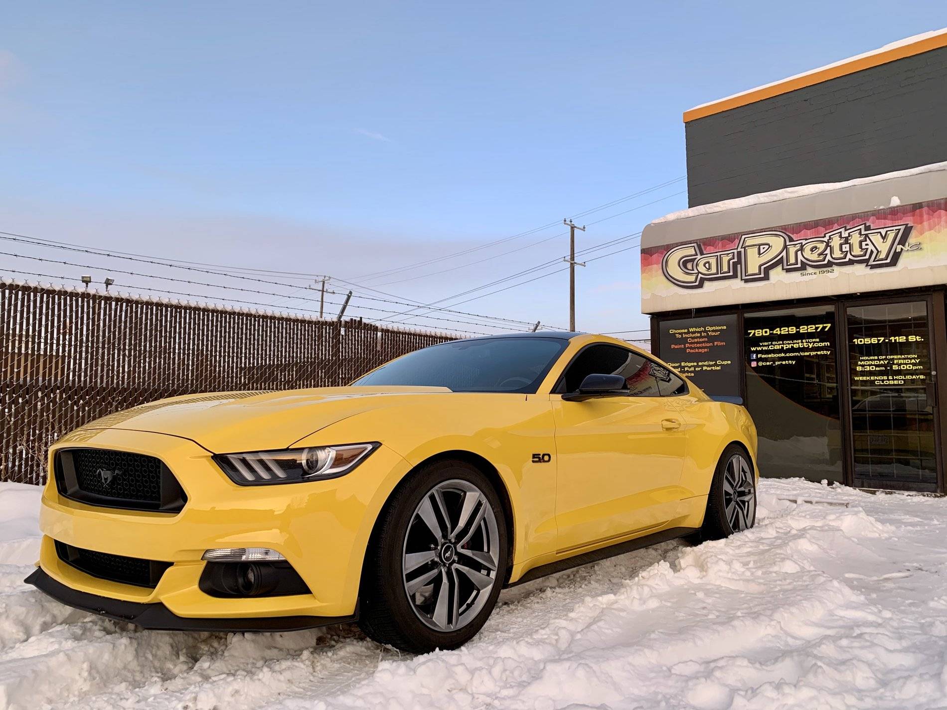

I run 245/45/19 Michelin X-Ice 3s on 19x9” Ecoboost performance pack wheels. Driven three winters in Edmonton, AB with very little issue. You won’t be keeping up with AWD SUV’s off the hop but it manages well in snow and holds up fairly well on ice. Be careful of braking on ice or slippery roads because even with brembos and good winter tires, the weight of this beast can put you into a slide. I gear down to 3rd and then 2nd to use engine braking before I apply the brakes.
