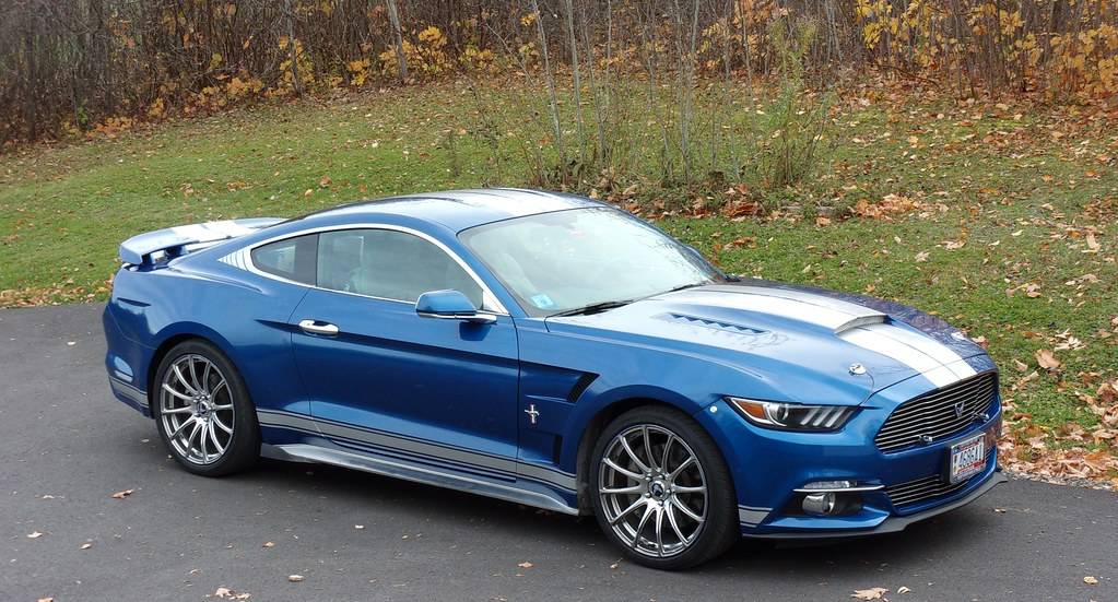

I put snow tires on my factory rims. For summer tires, I shopped around for lightweight cool-looking aftermarket rims. I'm glad I went that direction.

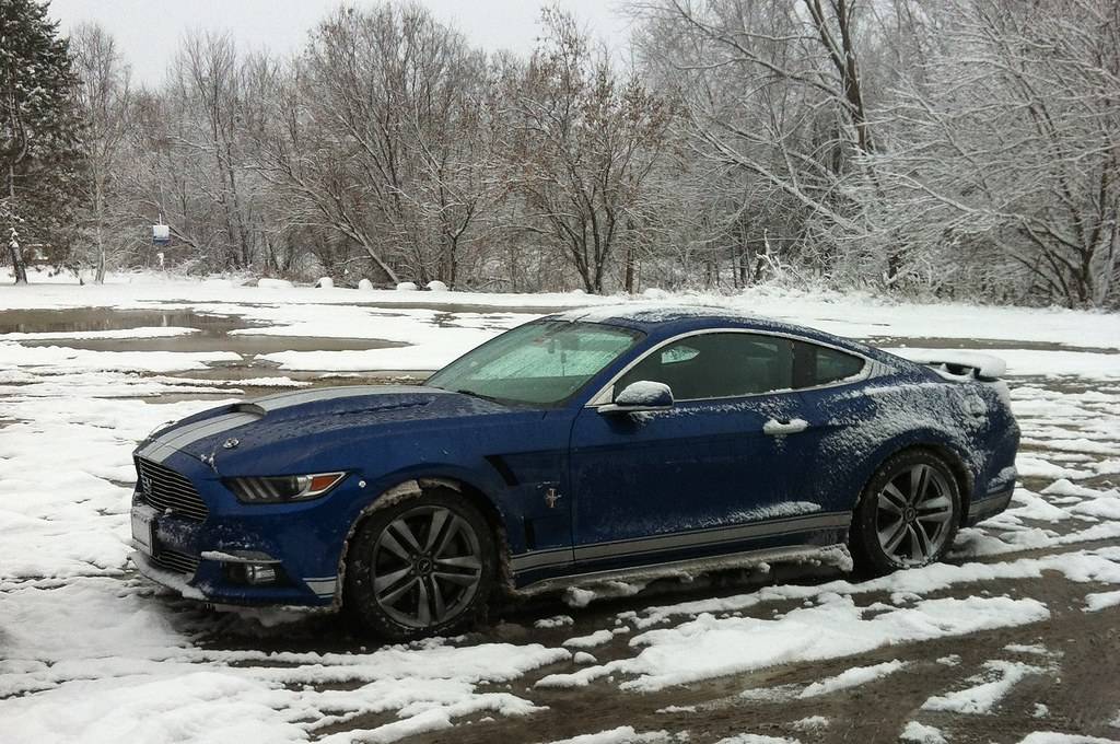

I have 255 Blizzaks on 19x8.5 rims and they've worked pretty well in real Canadian snow and ice. As long as you don't do anything stupid, you should be fine. Traction control works well at driving speed, but if you get stuck you'll want to turn it off to get out of the driveway or snowbank.

Yes. They were black when I bought the car, but I didn't like the look and sprayed them with Rustoleum silver wheel paint. It's a heavy wheel, but that doesn't bother me in the winter.
