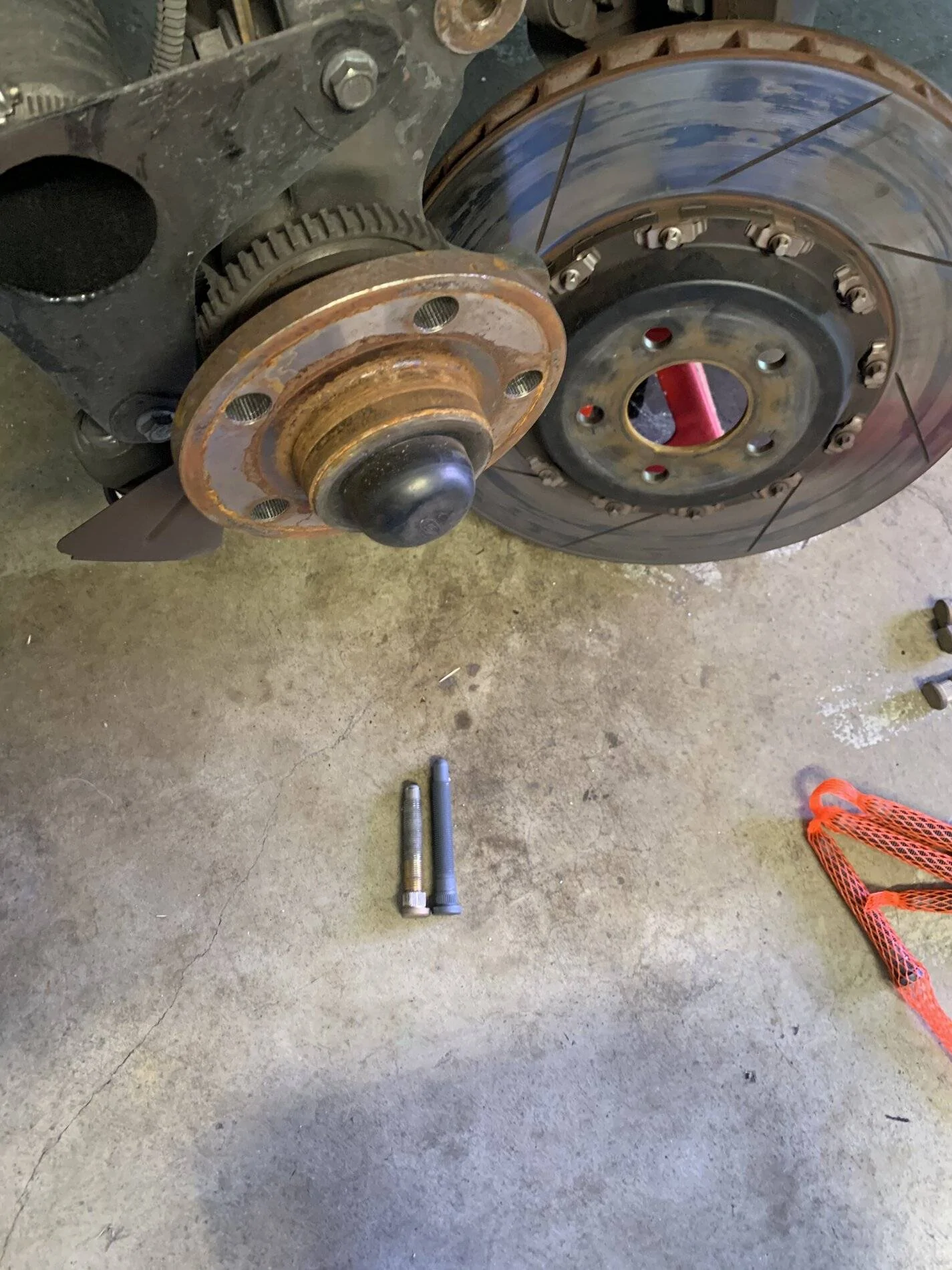

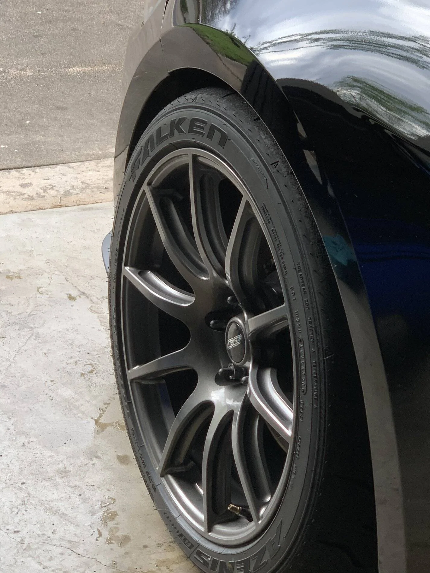

The forementioned OPMustang stufs They do poke out a bit, but they work well, and you have the option of running 31mm spacers with them down the road if you need a wider tire like a 315 square or something (unlike the ARP)
(Pic with “295” tires on an 11” ET52 wheel and 31mm spacer)

ARP and OP Mustang GT4 side by side
Those don't poke as much as I thought, looks pretty good.
