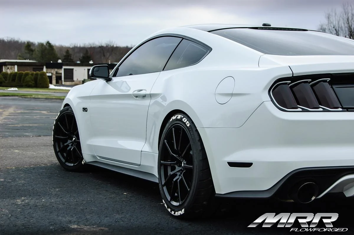

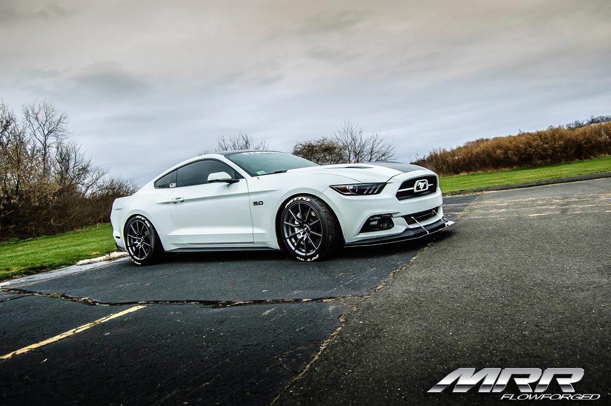

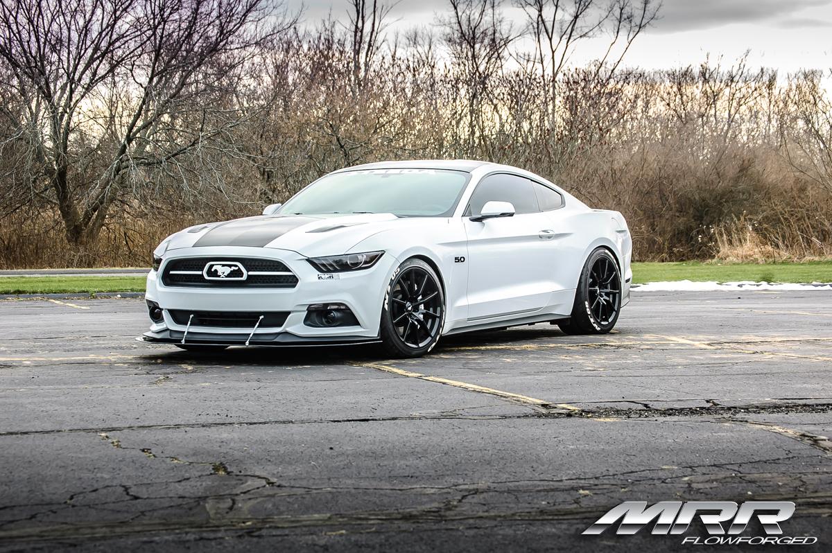

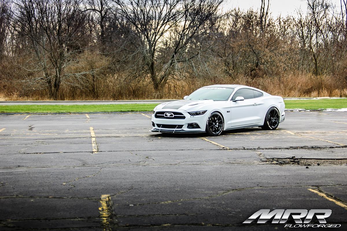

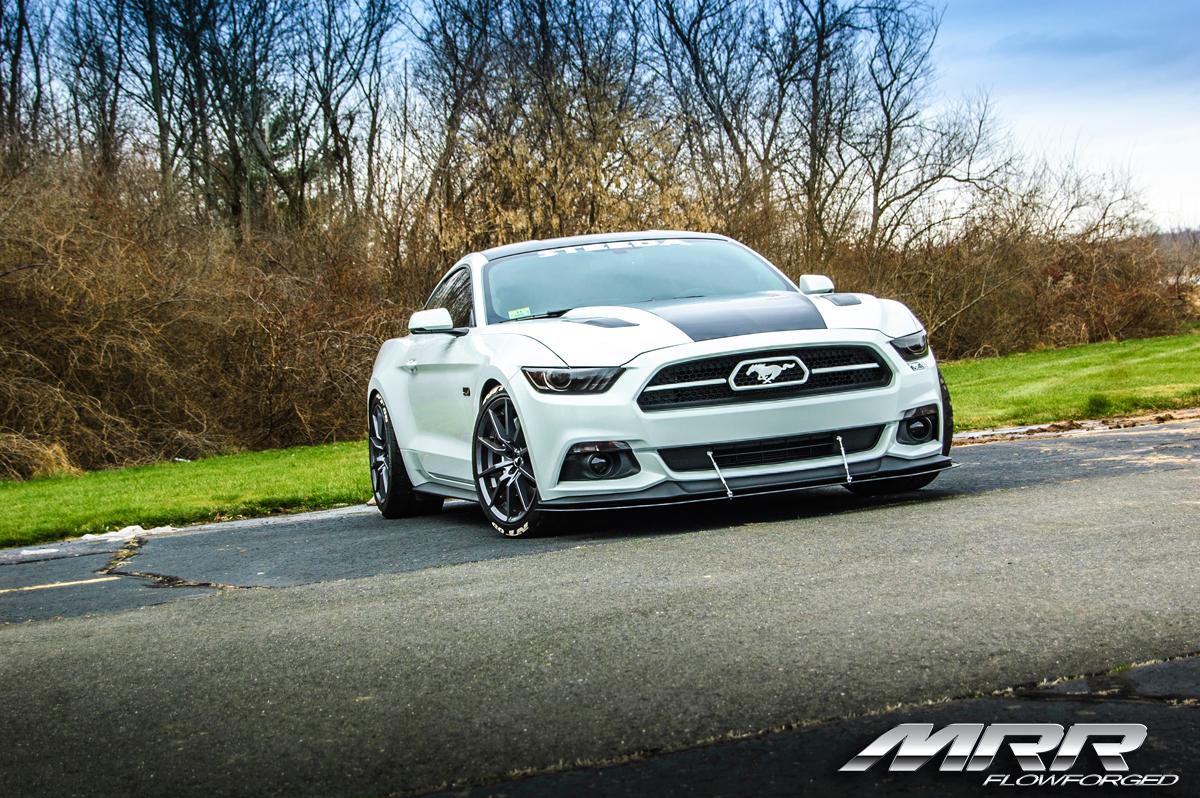

here is what a 19x10 40et looks like :D
and is also exactly what a 19x9.5 30et would look like as well. this is just for a visual for you. car has M350 19x10 40et
