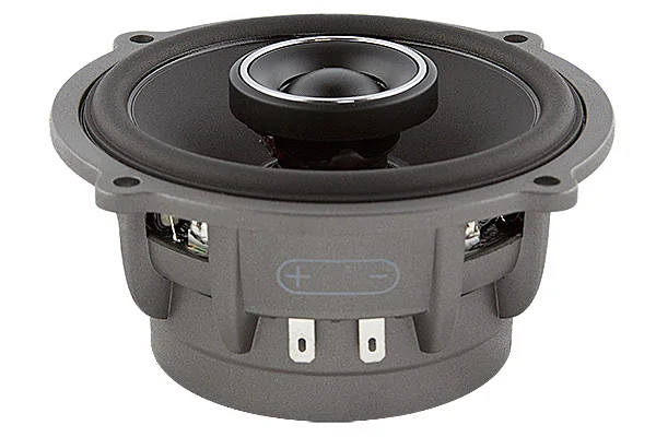

I'm considering the Audiofrog 4" coaxial drivers to replace the factory 3.5" midrange. (disconnecting the A-pillar tweeters).
Not adverse to cutting the hole in the metal larger and making a custom spacer, but I am more concerned with how far out the driver can stick and if it might contact the door panel at either the tweeter or the outer edge of the driver. Anyone crammed a 4" driver in this space?
Audiofrog GS42 driver page: https://www.audiofrog.com/gs42-4-120mm-premium-grade-automotive-full-range-loudspeaker/

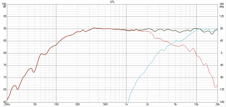

Yes, I read through that whole thread on his install. I am actually considering the same drivers as he used. But... I have to do a custom passive crossover design because I am not planning on doing an active 3-way. Just too costly.
Very concerned with imaging. So the goal is to try and fix the misaligned positioning between the factory tweeter and the midrange and use the crossover to help adjust for this. Otherwise huge dips in the frequency response will occur in the upper frequencies. I have modeled it in software.
I was thinking to avoid the hassles of separate midrange, tweeter and crossover, I could use the Audiofrog GS42 and be done with it. Albeit, more difficult or maybe impossible to fit the GS42 in the midrange location.
Here is the frequency response using a custom passive 2-way crossover when using the SEAS H1396 tweeter (2nd order slope) and the ScanSpeak 10F-4424G00 (1st order slope) with their acoustic centers aligned (impossible to physically do this with separate components) the red line = midrange, the blue = tweeter, grey = On axis summed response.

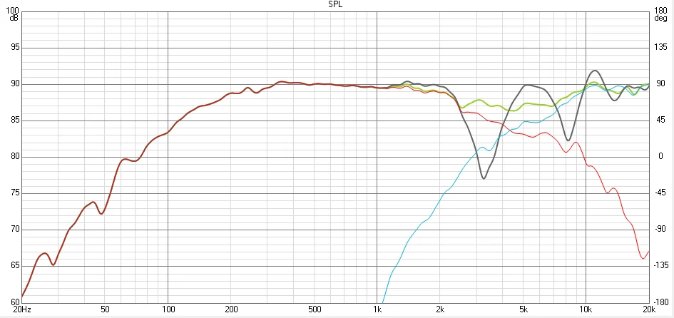

Now we shift the tweeter in space to position it up on the A-pillar. Look what happens to the on-axis response (grey line). Comb filtering due to the change in distance causing phasing issues.
The green line is the "listening window" and is more likely to represent the overall frequency response we would hear in the car. Still not nearly as smooth as we would like. Further adjustments to the crossover components can help correct this or applying EQ.
This is my reason for wanting to use the GS42 coaxial driver. Improved imaging and less comb filtering, no crossover to design and build.

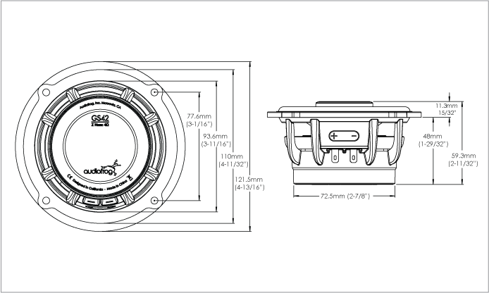

Thanks for those dimensions. I am going to draw it up in CAD and see if it's a possible fit.
