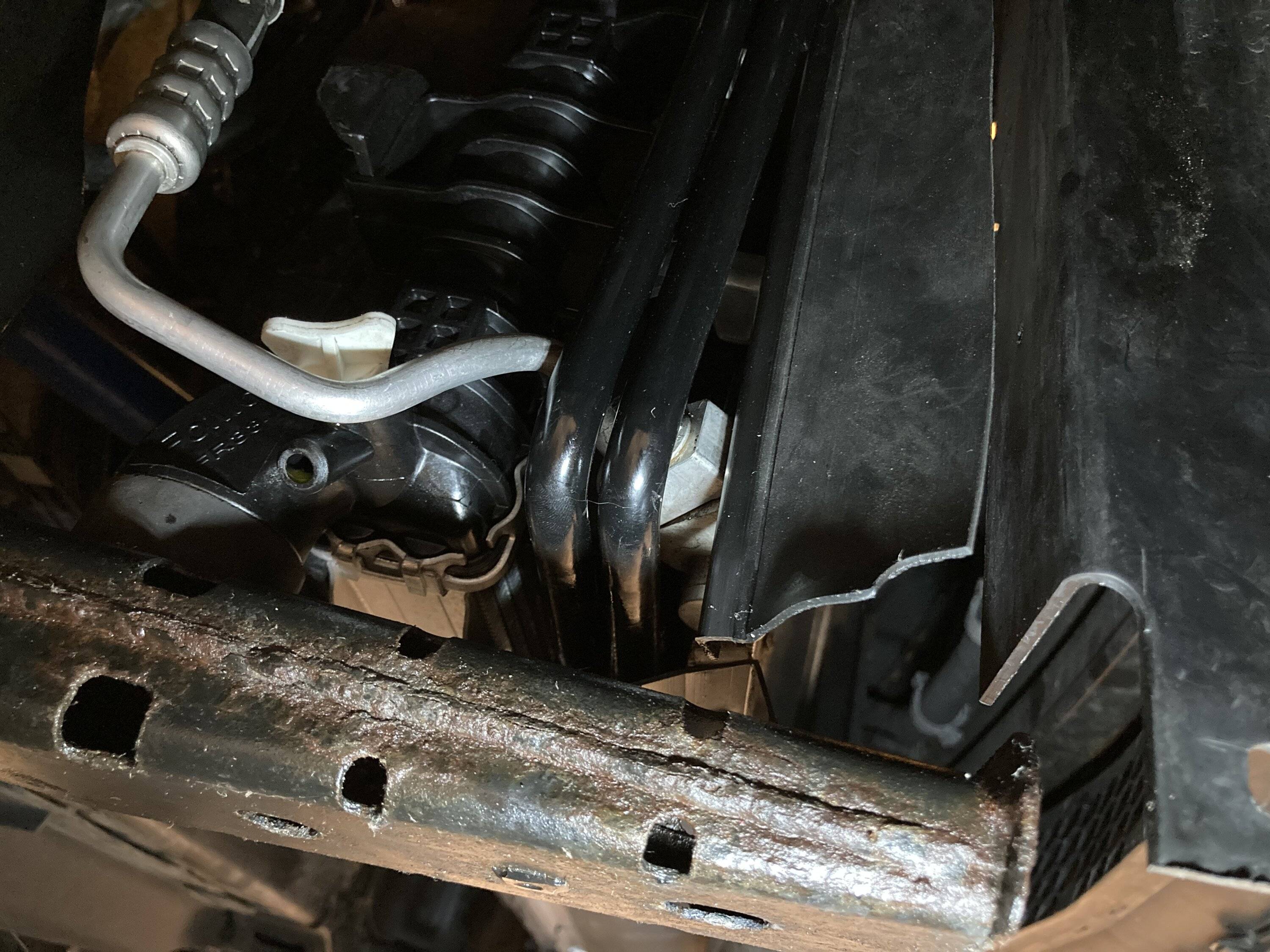

just a note on installing this. the ac condenser line fits in between the trans lines and the radiator. this means you have to position the trans lines first, then drop the cooler in and connect it to the lines in vivo. see pic. otherwise you will not be able to fit the lower ac condenser tab into its slot on the radiator
Good information, thanks for sharing!
