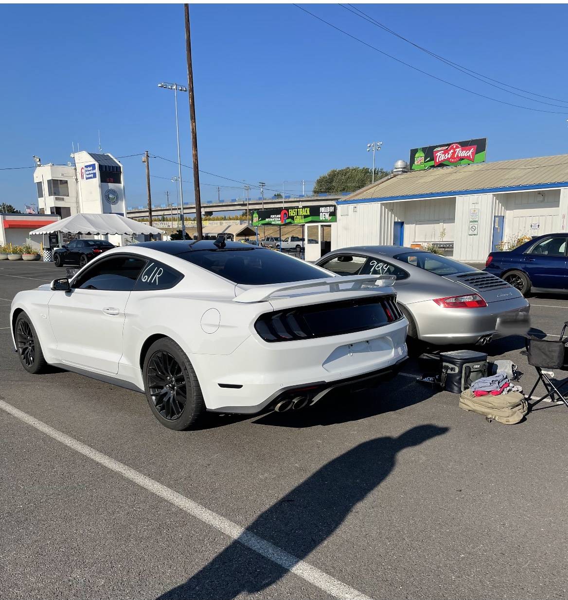

What's the other car on here? Still beat you to the 60' with that R/T.
He’s a waaaaaay better driver than I ever will be - but I think his rear-engine 911 had something to do with that .587 to 2.019 time lol. It’s a 2006 Porsche 911 Carrera S with some upgraded performance option.
I was a completely stock 2020 PP1 GT A10 on PS4S.
He was on R Comp r888r tires.
