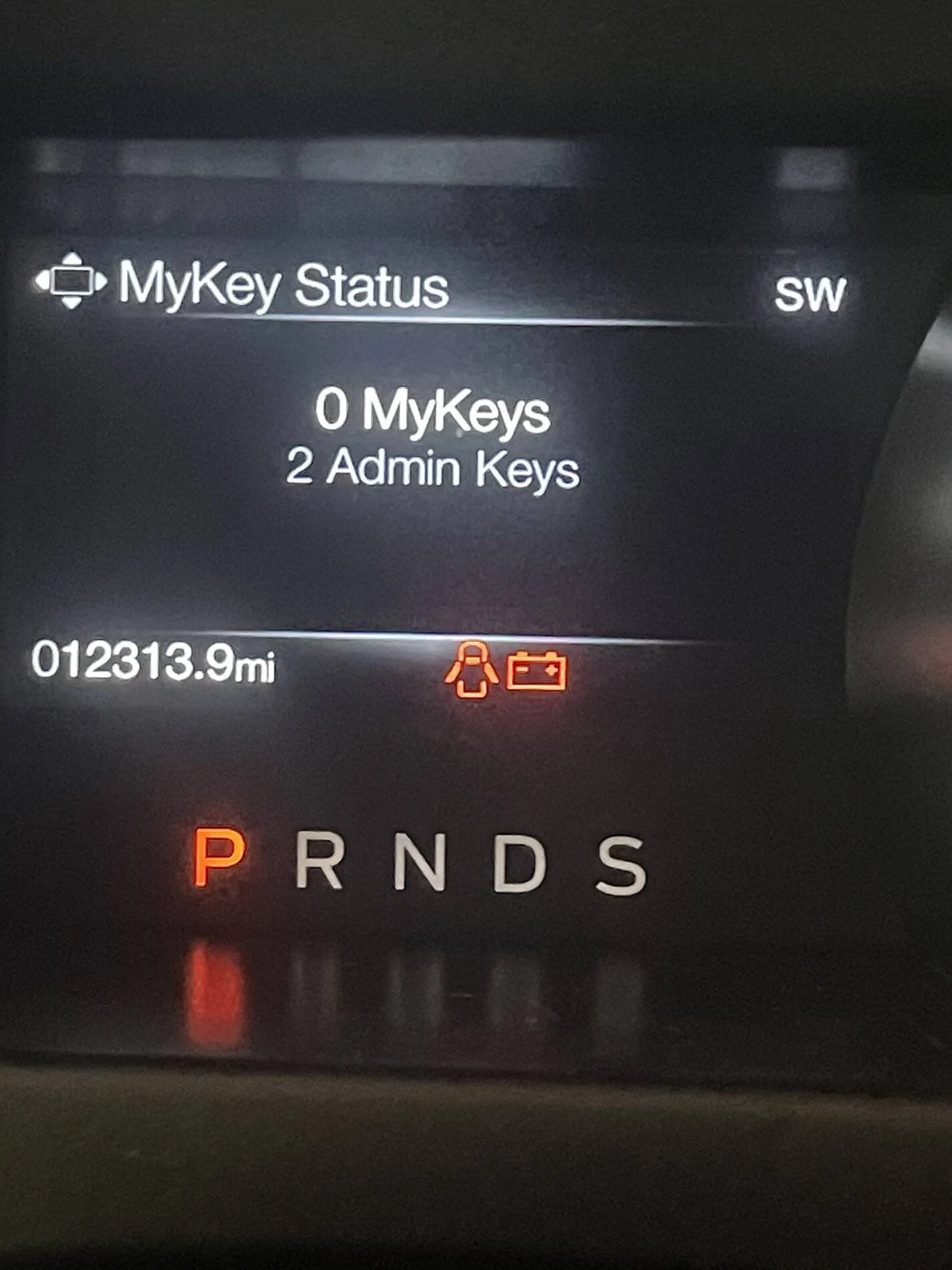

In around 8 seconds you should be able to hit 90mph in a stock A10 s550. Really hoping it’s something as goofy as the key-fob!

I dont think its the fob :(
Really!? Keep us posted. What exactly is it doing once it hits 80mph? Falling on its face like it’s starving of fuel? Is there no other sign of issue below 80mph?
