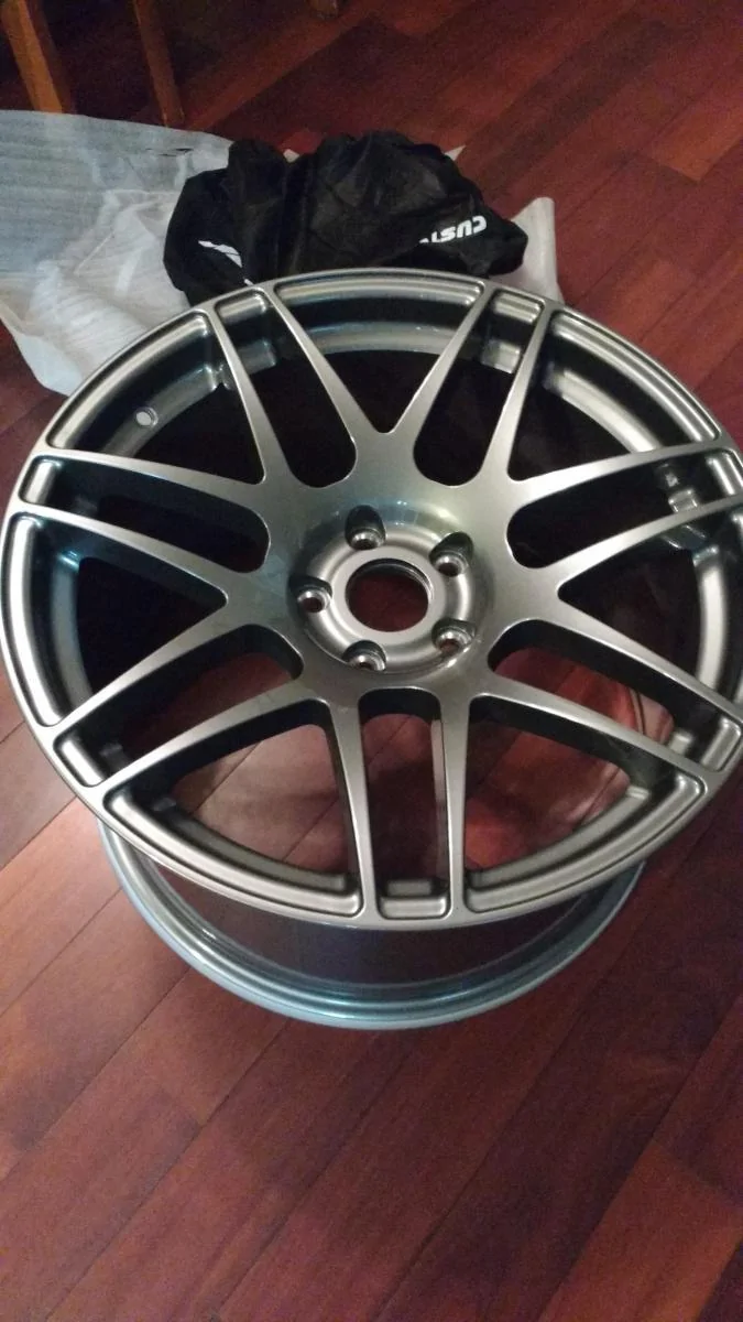

Stig'sBaldBrother
Jun 17, 2015
58
42
GT350 White/blue, track
I would REALLY like to do 305/30-20s all the way around on 11" wheels. N4SM says that a 35mm offset on all four wheels would be required to fit front and back properly. The 10" wheels they offer do have 35mm, but not sure how those would fit with 305s.
I decided to go with Forgestar 19x11, 56mm offset on all four corners with 29mm spacers on the front. I'll be running 305/30/19 for the track, probably NT-01s.
In fact, I already have the rims at the house but no car to put it on. :doh:
Stig'sBaldBrother
Jun 17, 2015
58
42
Which Forgestars?
F14s. They were on sale for 35% off. Got em shipped for under $1200 for the set. Not my favorite wheel, but good enough for the track.
