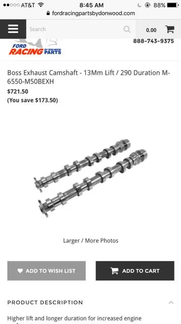

No those are the 11mm lift versions for the 11-14 standard coyote
kallo07
Jul 31, 2015
140
30
Aurora,IL
2015 Mustang GT Premium
What you would need

I'll be skipping comp cams, mainly because of price, but also because they're known for cam breakage (at least in the older foxbody 302). I was hoping the CJ exhaust cams would be cheaper....yikes.
