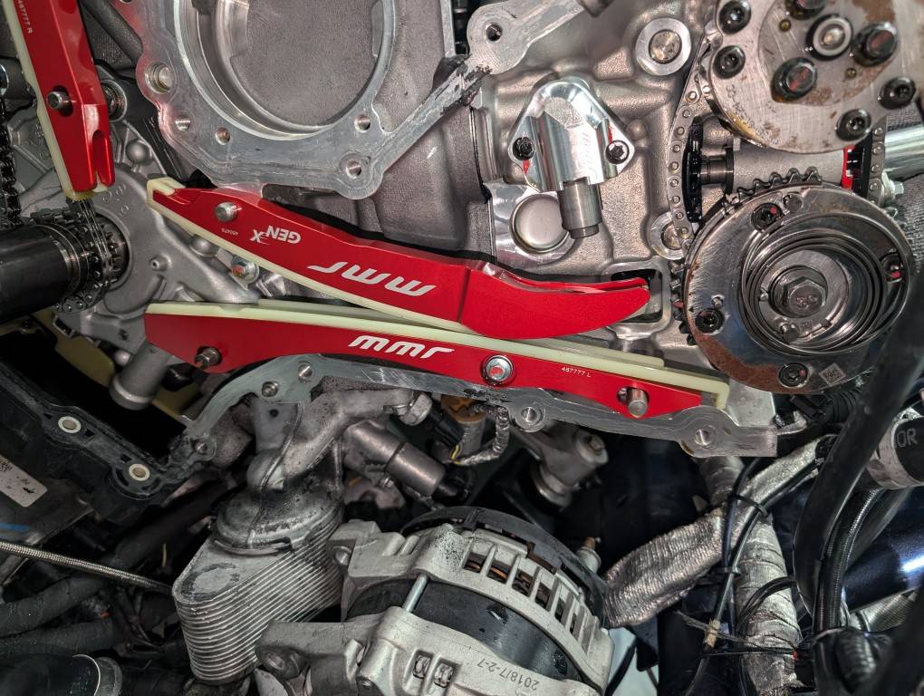

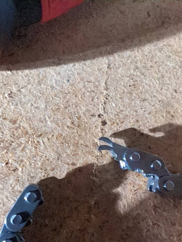

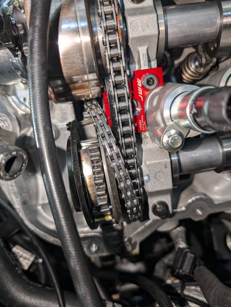

The primary chain appears to have ripped, and the exhaust VCT gear broke into several pieces (found all the pieces). Not sure how it happened though. Maybe chain jumped off the gear and wedged in there, caused both to break. I pulled off some of the cam caps on the exhaust cam, no signs of binding or metal in the oil. The crank gear is intact, no obvious signs of damage. The tensioner and guides don't look to have any problems. I think this occured nearly instantly. I checked the pistons, no valve contact or any damage. They must have immediately went to neutral when the chain snapped. Also, no signs of chain slapping around inside the timing cover or valve cover.
Plan is to pull the pan, make sure I have all the metal parts out. To get the VCTs I had to order an entire Ford timing kit. I am going to use the secondary chains from the kit. I bought some gt350 primary chains.
Should I reuse the MMR tensioners, flip kit, and guides? Or just go back to stock stuff? I think I have everything from the timing kit I ordered. Car should be 1300-1400ish with eventually some nitrous on top.
