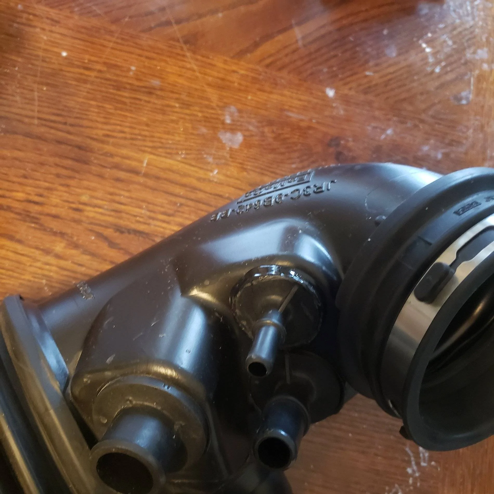

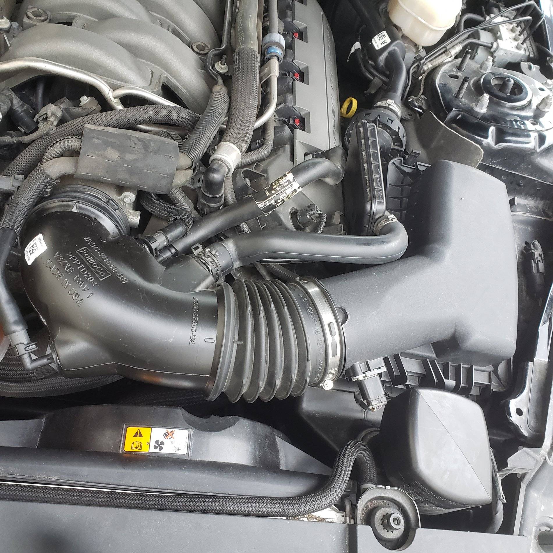

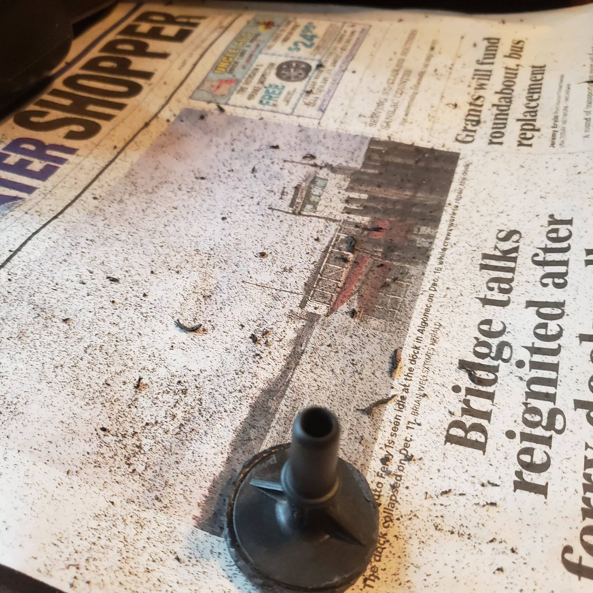

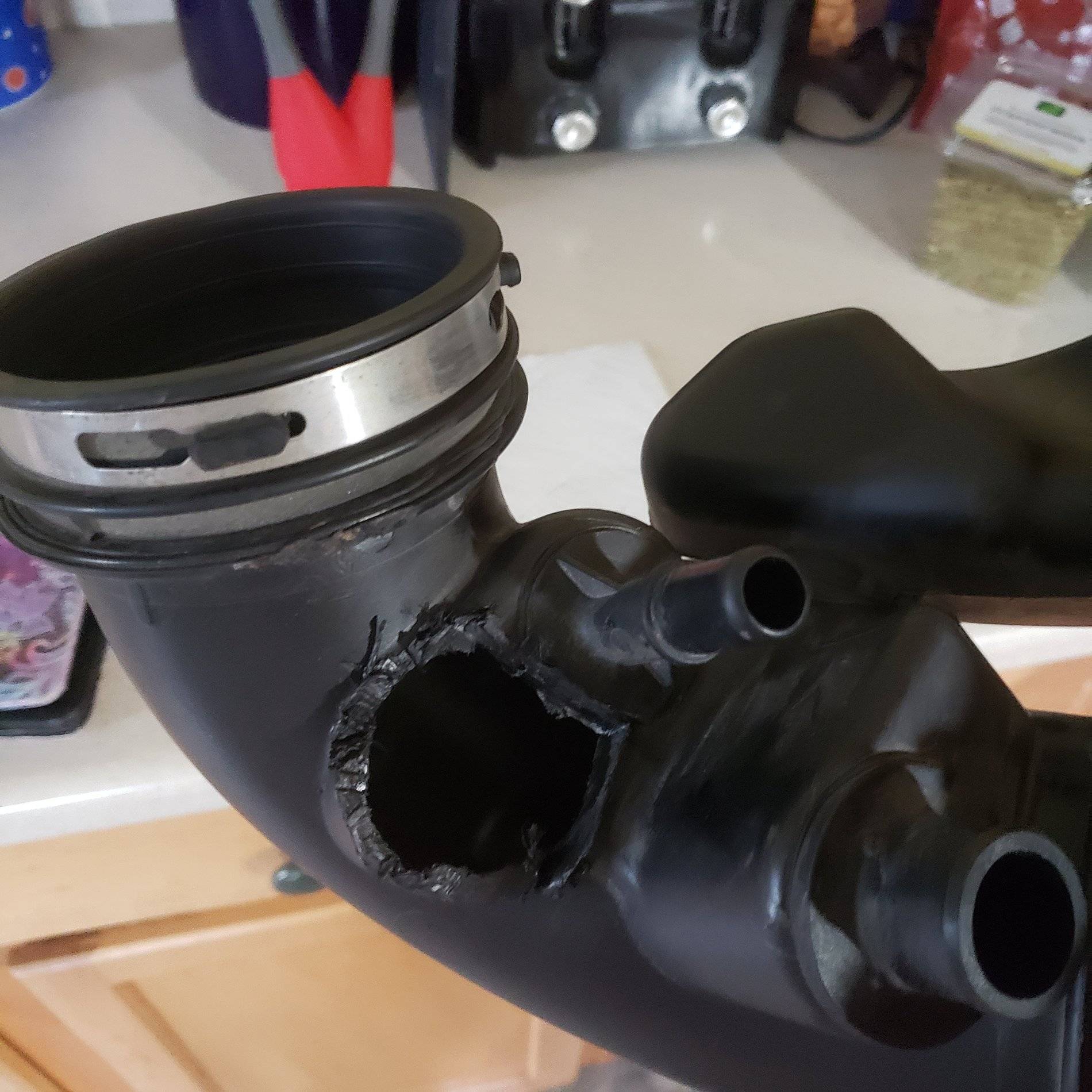

After waiting for 15 cold air intake to ship for 2 weeks from American Muscle and it never did, so I cancelled and went a different route. I've been eyeing a 19 GT cold air on craigslist and pulled the trigger. I got it home and quickly realized I have one more intake plug. So I used a hot putty knife and cut the intake plug off the 15 cold air intake. After an hour with a little harbor freight dremel, I attached with some jbweld epoxy, I drilled the hole and left the drilI bit rest inside the hole while it dried. I started it without my tune, it did not like that at all, added the tune in and so far so good. Sent my tuner a heads up, he's never seen anyone go this route. We shall see. The size difference is amazing from the 15 to the 19. I have sound tube delete, just too excited to get driving.
Total cost 65$ and about 2 hours of quarantine time.
One more thing there is no difference in the cold air box after measuring, the only difference is the lid and tube.

Very nice. I guess that tube was deleted on the 16-20's. What's it for?

Yes it's not on the 18 and ups. Just an intake vent from what I can tell.

so there is no difference between the box of a gen 2 and gen 3? So you could just get a gen 3 tube and lid?
Upgrading to just an larger intake tube would net the same results?
What is that tube for? I wonder why the gen 3 don't have it?

Correct, using my gen 2 box with the gen 3 lid and tube, you will need to add the plug and a tune.
Driving yesterday it felt sluggish and slightly worried what have I done...I did a cold start this morning it started like I never heard it start before in a good way, very deep, held the cold idle
well. It's like a different car today, pulls hard, I guess it just needs time to learn, got a flex tune so that will be next.
