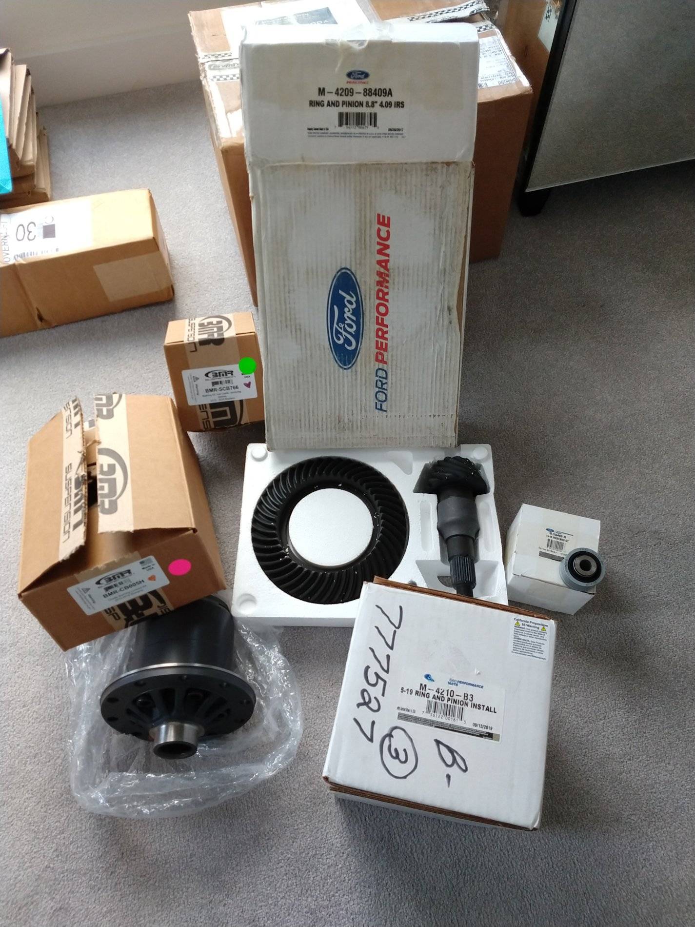

I have them as well, and will install them in about 3 weeks when the weather is consistently better here. I also bought a Ford Racing Torsen LSD as we basically get the PP1 spec with a Trac-Loc 3.55 rear end. Looking forward to the higher final drive and ability to row the gears more often! One of the frustrations right now is that on back roads (and all of our roads are very curved), is that you can only really use 2nd gear because most of the back roads you can't really push too far beyond 70 mph without being a dickhead. So, in much of 3rd gear at 70 mph or below you are below 4500 RPM where the car really starts to come alive.
Honestly, I would have been happy with 4.56 gears but Ford Racing didn't offer it and I was hesitant to use anything not Ford manufactured since if we have a problem over here, it takes ages to get parts from the USA.

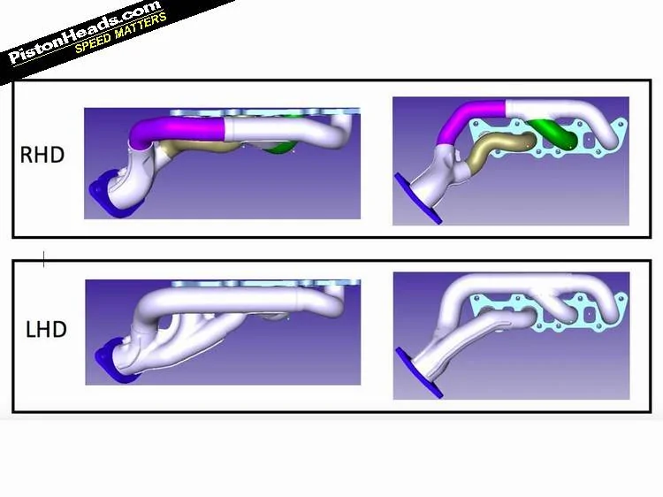

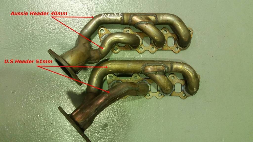

The power is there but to be honest the gearbox makes the Mustang feel a little slow. I mean, we only have 444hp compared to 460hp in the States anyway (RHD, but my RX-7 is definitely quicker in a straight line and everywhere else honestly). The 4.09s will do a lot for more engagement and make it "feel" quicker. I'm not sure there will be a huge 0-60 mph benefit but in gear acceleration will be improved and I'm looking forward to comparing 30-70 mph and 60-125 mph times.
By the way, the headers we get on our cars in the UK are really terrible aren't they?
