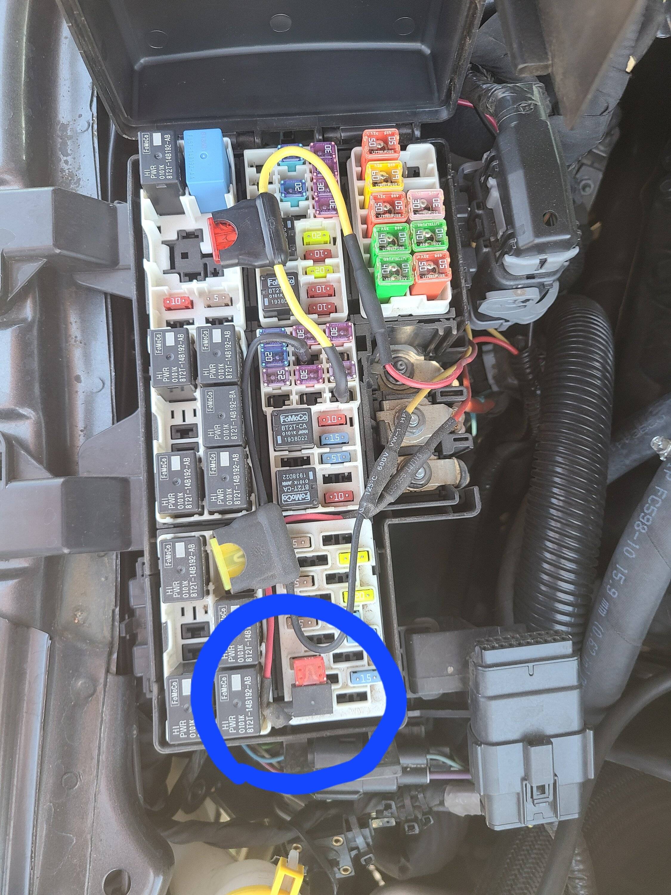

Yeah if you could later that would be much appreciated! So you wired to fuse box under the hood and assuming went through the grommet to mount under the passenger feet area ?
Yes I ran it thru the grommet on the passanger side wheel well. I circled the tap I used for the lights. The other two are for my meth kit.
Thanks dude ! Really appreciate it, did you hook up the optional aux cable for the "door assist" so it lights up when you open the doors ?
