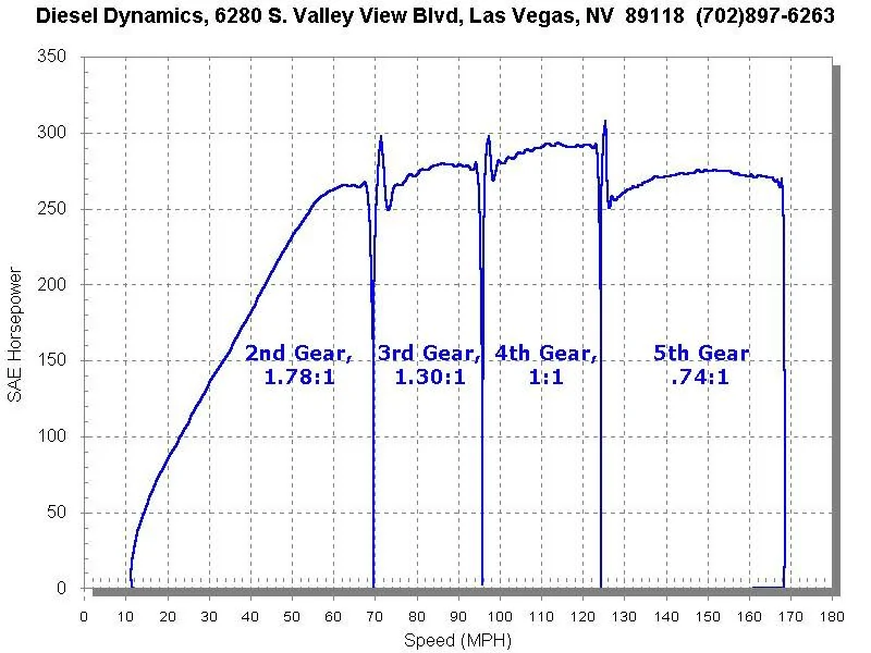

Went one step further, from our friends at Dyno Jet: Any gear other than 1:1 will show some amount less power due to the fact that power is being used to accelerate the drivetrain, engine internals, tires, etc at an faster or slower rate, using mechanical advantage. This mechanical advantage also increases frictional loads which further reduces the power to the wheels.
Also, a dyno graph to show the difference in multiple gears....

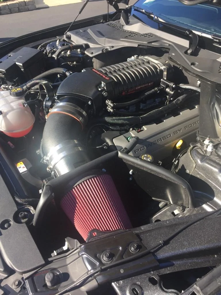

This thing is absolutely amazing. Runs beautiful! Whipple did an amazing job with their tune and Tasca did a top notch install. I couldn't be happier.
Jaime
Very nice Jaime!
Very interesting. Thanks for sharing. This definitely overrules my initial feelings on it. I admit to never have really looked for it, and just never really noticed it I suppose.

Since this was at a diesel place, was this a turbo car/diesel truck per chance? Turbos load differently than SC and NA cars by gear. It's also showing against speed, so how are you calculating torque?

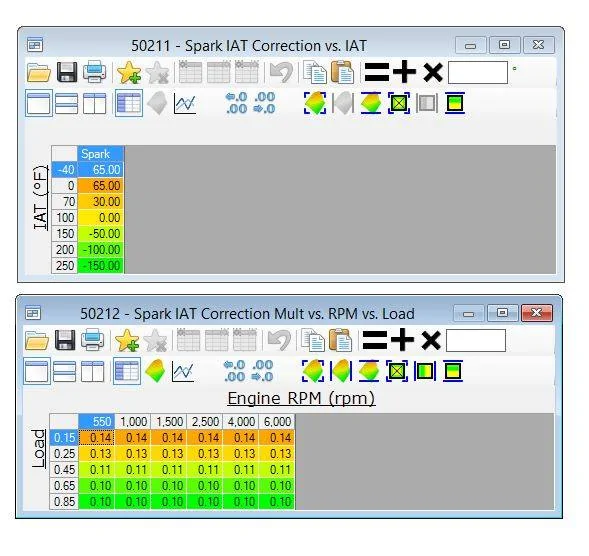

Edit: I see the different scales, wow is that weird, HP and TQ on different ones.
Also what is the analog input? IAT in C?
There is way too many variables, just because of two different gears. Looks like there is also an IAT difference that can also be causing a difference.
Correlation does not mean causation.
On a stock Boss 302 Calibration which I am looking at right in front of me (silver key), for every 10* in IAT temp it will pull 1* of timing over 100*F, In the ECT (Engine Coolant Temp) over 180*F it pulls 6% of the value in the spark correction table. I'm not showing the silver bullet to prove why, but giving you more variables to consider. Gear ratio could be the reason, transmission gear could be, IAT and ECT correction can be as well. Hell, from the information given we could say vehicle paint color could be a reason because you can't correlate anything to one particular value especially with back to back pulls.
Temps can go up, oil gets thinner, hp goes up. Temps can go up, and spark correction can kick in, and hp goes down.

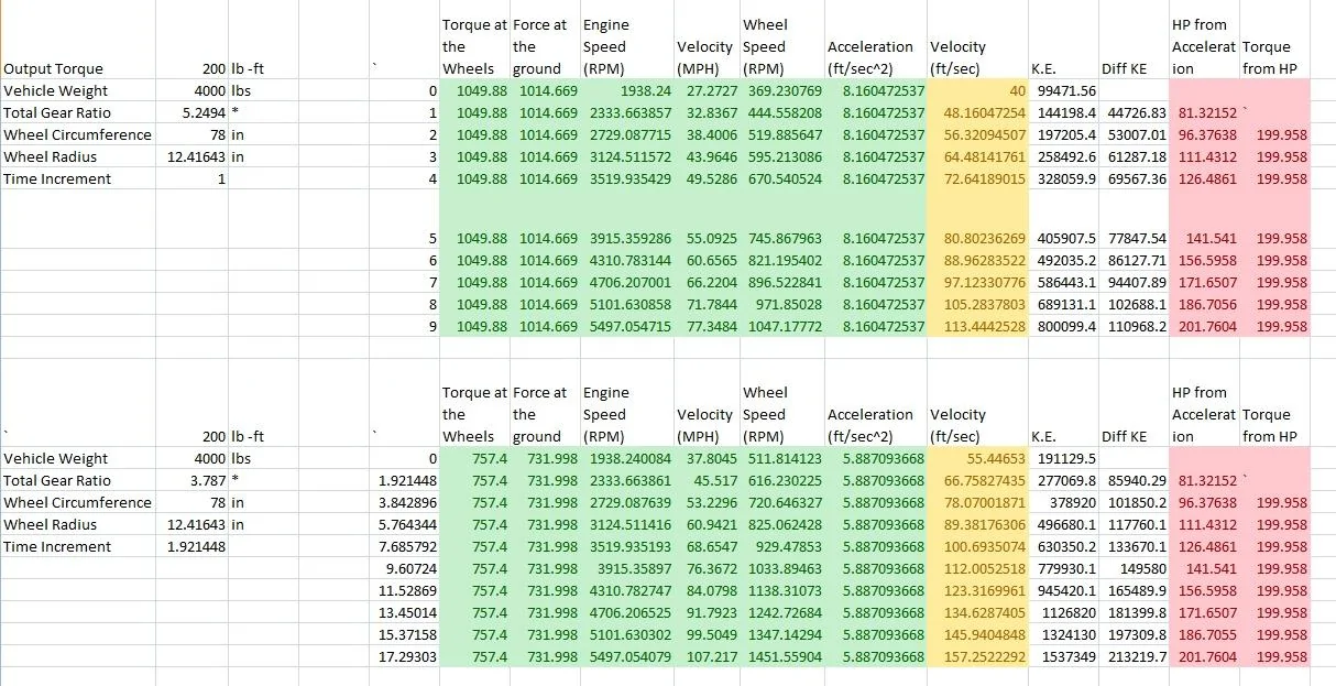

I've just shown you the math and science behind how a dyno works, how gears affect hp output as a torque multiplier, and the other variables by displaying the actual tables within the tune that can affect a car with back to back pulls within minutes of one another.
A dyno measures hp at the wheels, then back calculates engine torque which is what gets displayed on your graphs. Gears (rear and transmission) only affect a torque rating at the wheels after power has been put through the drivetrain.
Until you can show me two runs in two different gears with all variables the exact same, IAT, ECT etc, as well as all other global and local spark modifiers as constant, your graphs are not evidence. Now in my example, yes 5th gear has the potential to be a lower readout, if the IAT, ECT and any other modifier is beyond the timing pull thresh hold. This can also be for a 4th gear run, or a 3rd gear run etc etc.
I've posted the calculations, feel free and debate the math. This isn't my first rodeo either, but guess what, no matter how much experience you have, doesn't mean you're not prone to mistakes nor are you the final authority on how everything works in the automotive world. I have no doubts you're a smart person with a lot of experience under your belt, but unfortunately you are incorrect in this matter.

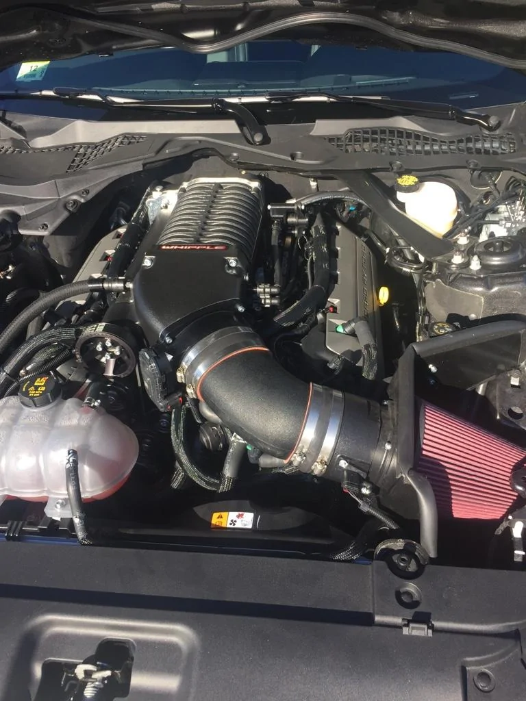

I really wish the strut bar could be reinstalled after the whipple install. How close is the whipple to the hood after install? Is there room for a modified strut bar?
No room what so ever lol. I have a impression of a small part of the SC on the hood insulation lol.
