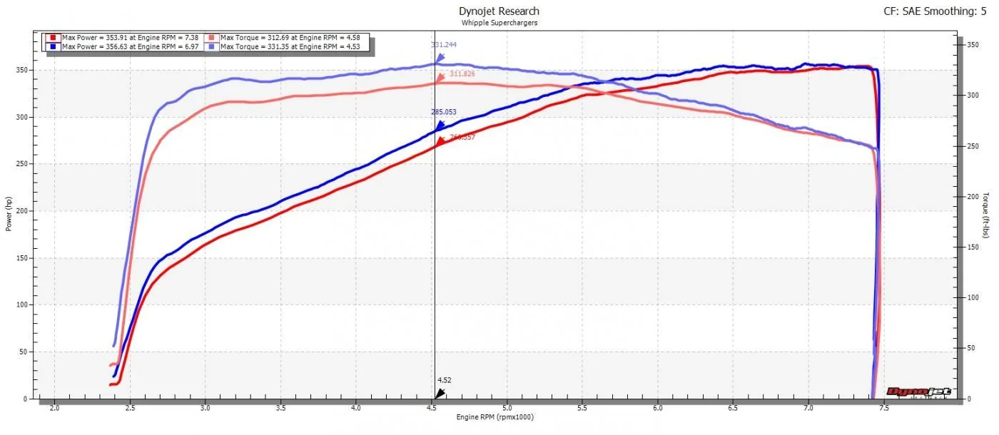

Not to beat a dead horse here, but I took a few minutes of my day to show you, actual facts.
2012 5.0L Boss 302, 100% stock (no track key), 91-octane. 3 minutes between runs, 5th gear being the last run. Notice the TRQ difference......

What wee it's cylinder head temps each run? Iat? How does the spark vs ect and tables look?
I appreciate you doing this but there's too many factors.
It's not black magic or trickery. He's just simply saying that the same car on the same dyno put down different numbers in 2 different gears......

So you're saying that if a vehicle sees a warmer ect or iat setting it won't pull timing?
I appreciate what he did. Although in my experience and others this is not the case. On an automatic car yes gear makes a difference. Manuals not so much.

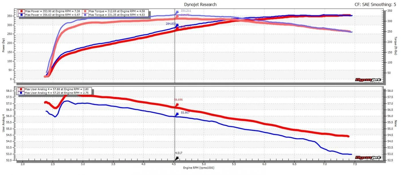

Seriously?? You have to be kidding. This is a 100% stock Boss Mustang, 25k miles. I made 10 run's today, all temps are within 5deg. There are no other factors, timing was identical on 5 runs!
I've got thousands of hours on the dyno. I know for a fact many others have come across this. Again, do a search, you will see it is FACT.

Ok cool man, you're right everyone else is wrong and the dyno graph is a lie. We all yield to the great and powerful Process. :hail:
