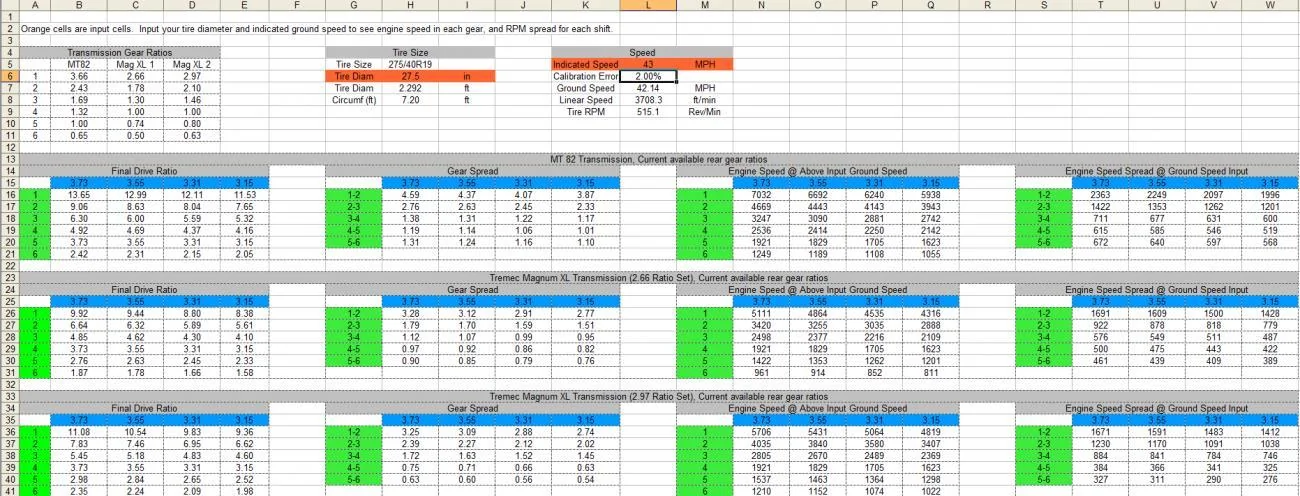

Wel I have a Shelby but I can speak to 3:73 gears out back. I run a Trinity TVS with all bolts on. I make 659 Tq. You will be fine with 3:73's and a 6 speed. As for launching, you just need a good suspension setup, and some grippier tires :headbang:
In the 1/4 I do have to shift to 4th, but let me tell you, a PD blower and 3:73 can net a lot of :) per gallons...

Shelby has a 2.97 first gear ratio, the 15 has a 3.66 first gear ratio. A 15 with 3.73 and FI will see 5th gear in 1/4.

Shelby has a 2.97 first gear ratio, the 15 has a 3.66 first gear ratio. A 15 with 3.73 and FI will see 5th in 1/4.
I knew one of my buddies would step in with the exact info lol. Thanks :)
wow...did not know the gear in the trans was that much different. So yeah I guess maybe even going to a 331 in a GT may be good for that car.

You'll need 3.31 to avoid a 5th gear shift with fi on a 15
