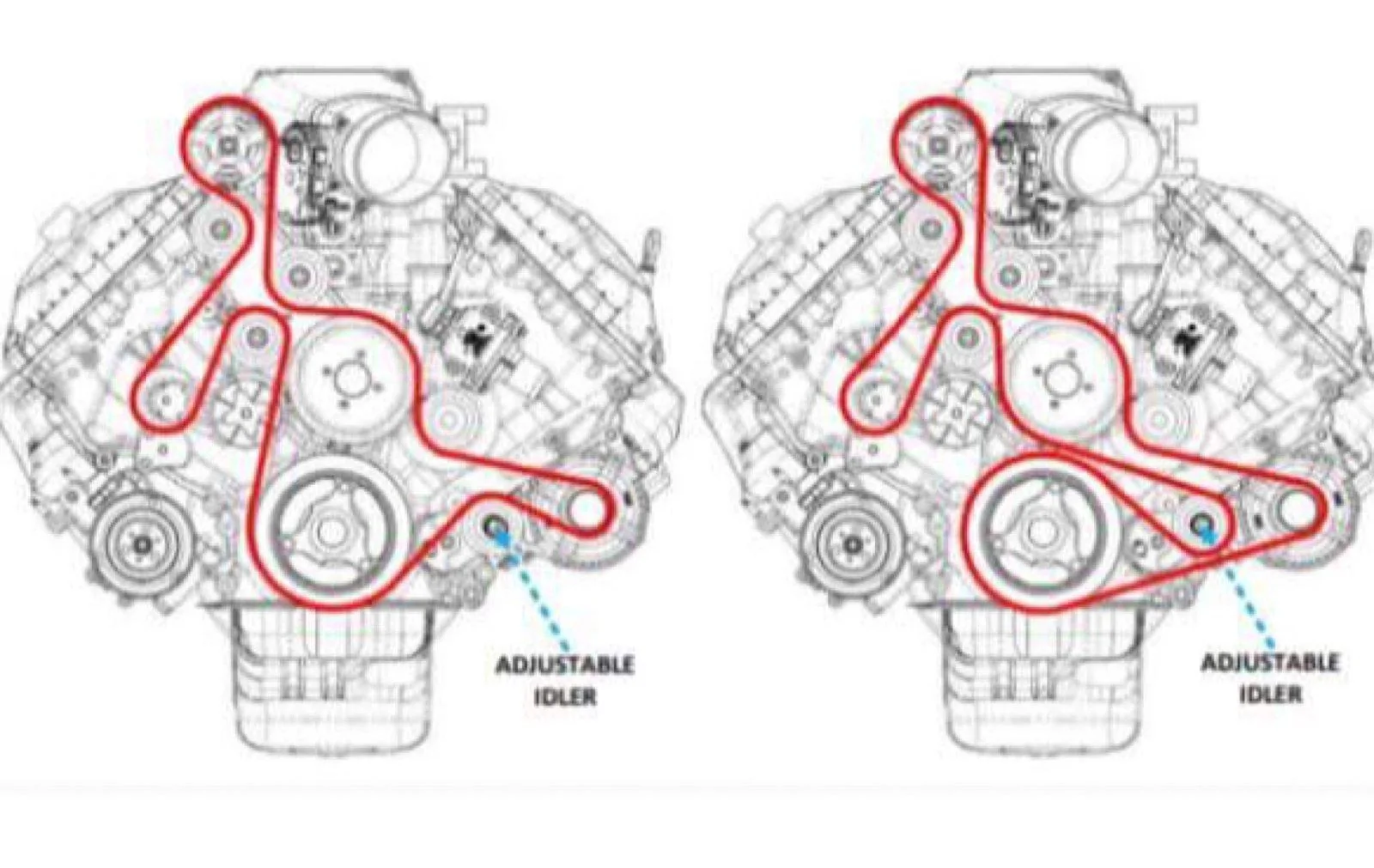

I have a 6 rib on my 2016 gen 2 kit. The Gates part number on the belt that came with my kit is K061066. Be careful as there are two different belt routing diagrams and sizes of belt depending on when you got your kit.

Yeah that's what I'm confused about. I have a gen 3 stage 2. bought and installed in February this year

Right side is the preferred routing. Use the K061066 belt for that one.

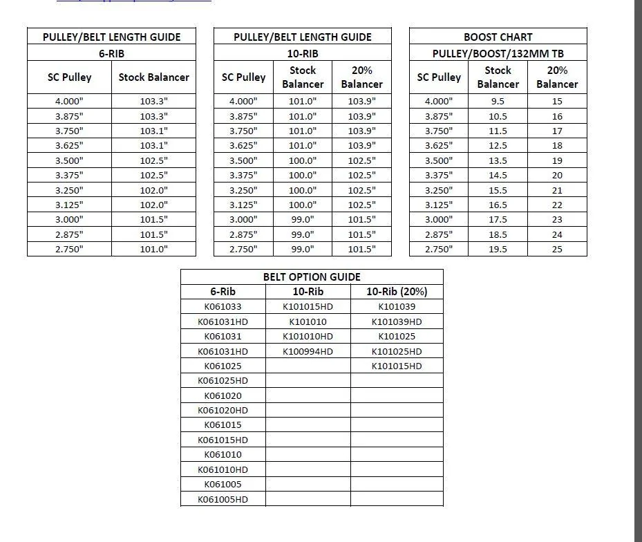

Just FYI. I asked this question in TVS/Whipple group on facebook. Dustin Whipple himself jumped in and said they stopped using RPM belts completely. Said they had a ton of failures. There is a new list of belt lengths out now from whipple and all are using the standard gates belts. Last page of this link has the sizes and part numbers....
https://whipplesuperchargers.com/index.php?dispatch=attachments.getfile&attachment_id=197
I Switched to the recommended belt listed in that link and all belt slip stopped.

RPM belt blew off my car today after a year......luckily I had a spare in my trunk and some tools but its not really impressive
Whipples website shows a shorter 102" belt and not the K061066 which makes things even more confusing
I ordered a new K061066 for the car,since thats what came with my kit
Just FYI for Gen 5 owners that guide does not apply
I now have two 102.5 belts that are way too long for the 3.5 pulley .
