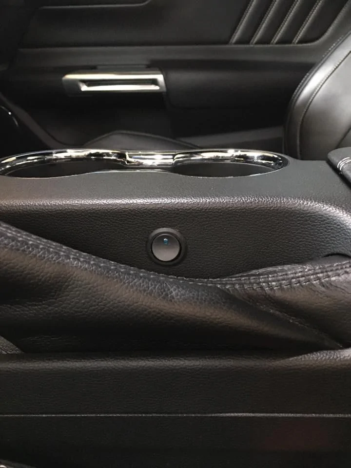

I have contemplated the toggle switch myself. But those of us older guys, that wen't through a smoking pot phase, can't trust the memory to remember to kick the dam things on when I should. LOL
My memory sucks so I put my switch on center console right next to E Brake handle with an LED to remind me lol. I'll try and post a picture but no TapTalk SUCKS
