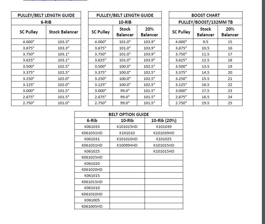

Update after a weekend of additional installation.
1. The belt I received with my kit was a Gates K061025 (102.5"). Based on the Whipple belt sizing chart I needed the K061031 (103.1") for the 3.75" pulley that came with the kit. I picked one up from O'Reilly's. Tight, but it fit fine with the adjustable idler at about 90% towards passenger side. The auto tensioner is pretty close to it's upper limit. As it heat cycles and stretches some I'll adjust that idler more towards the drivers side. The 102.5" would not go on with two grown men honking on it and the adjustable idler 100% towards the passenger side.

I'm at the step where you attach the relay wire harness near the fuse box and make those connections. I did hit a snafu with the MAF extender harness. Kit comes with an extender for the MAF and the throttle body cables, not labeled which is which, but neither of those extenders worked for the MAF, have an email into Whipple tech to get resolved.
Whipple belt sizing chart for reference:
