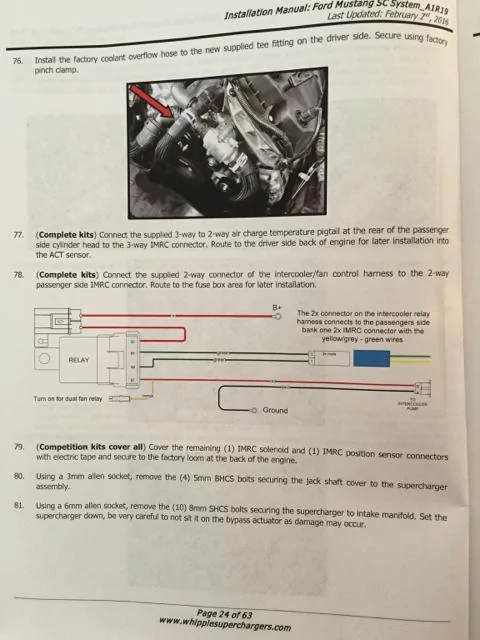

Can somone help me out on step 77 and 78?

Where do I leave that relay? Since the fan realys says Im sopost to sandwich it between the fuse box and fender hole

Put it out of way up on windshield after plugging in connector at back of block.
The relay mounting and zip ties I waited till final button up as they are best out of way till then.

Same here I waited to the end to make things neat and tidy

Like those guys said. Just plug it in an leave it out of the way for now. Later on when you install the intercooler pump and fans it will tell you where to run the wire
