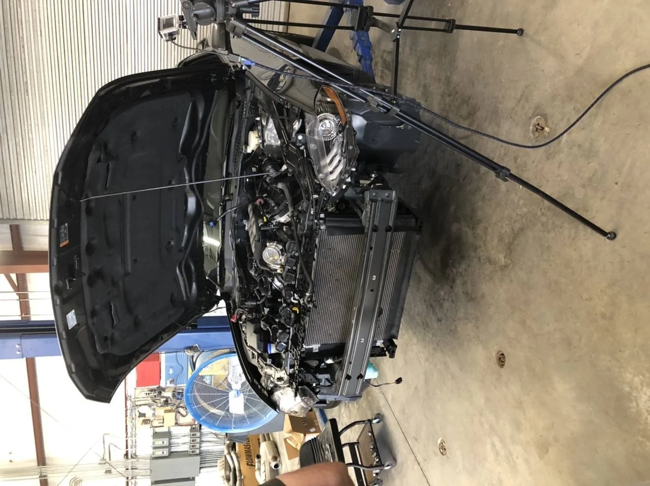

Just finished a Procharger install.
No way, even with 2 people, to do it in 5 - 6 hours. First time with 2 really good mechanics, figure a day and half.
I thought 5-6 hours was optimistic, but I have no clue, honestly.
