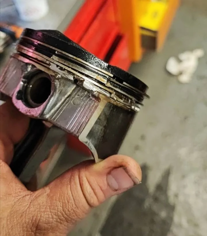

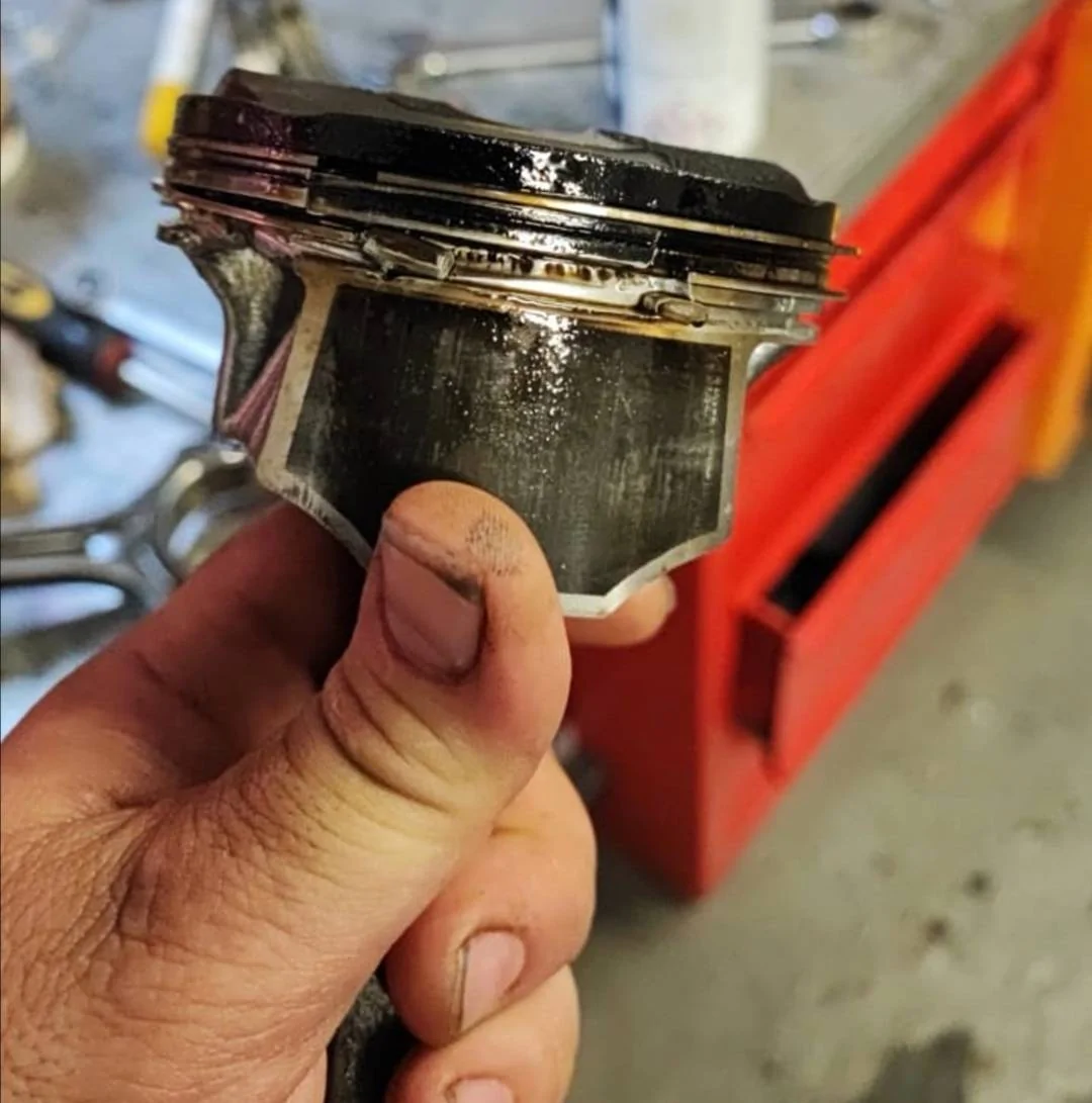

Fast forward a few weeks later, had oil smell and some faint white smoke come out of the exhaust after a spirited drive. Checked the engine, loss of compression on cylinders 3 and 4 , took the engine apart and here are the results:
Pistons 4 broke and 3 had some damage. Corresponding cylinders had some damage as well.
I am going to need to built the engine, forged pistons, rods and sleeves and probably gonna run headers with high flow cats and take that damned gpf filter off. And most important of all , a custom tune.
Was running the base gen 5 stage 2 Whipple tune with the 3.875 pulley with an H pipe.
I have read guys are running base Whipple tune with a stock engine and this didnt happen to them but unfortunately here we are.

oh no! Sorry to hear, thats no good. I wonder what the actual cause was for that??? :facepalm:

Trying to figure out the same, not sure what the root cause is but the stock cats + gpf filter seem to be a major restriction of the system, maybe the tune played a part.
Oh well, back to the drawing board
