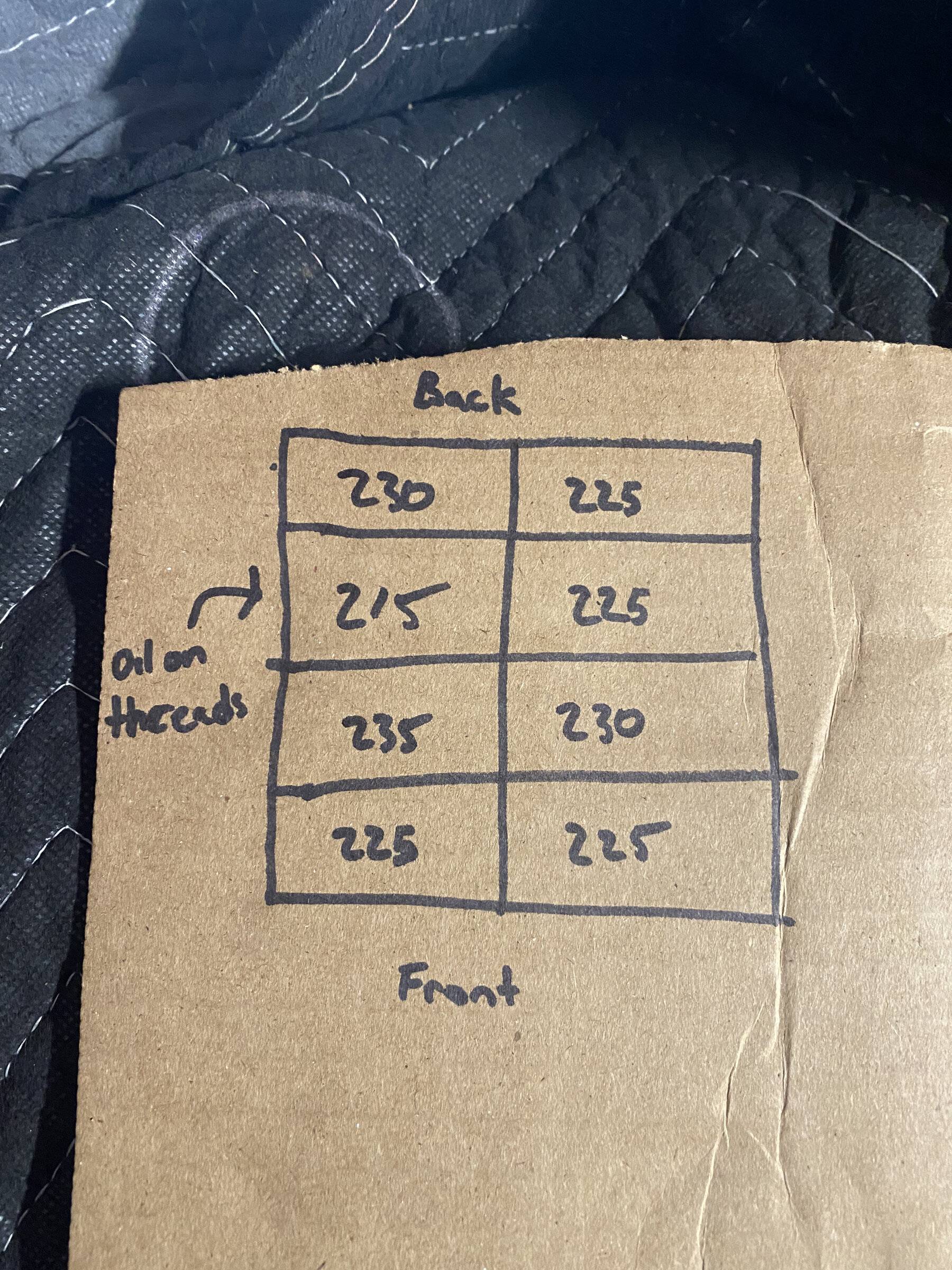

So did a compression test tn and cylinder 3 was slightly lower than the rest. Also when I unscrewed the compression tester there was oil on the threads. Put new plugs in but car is still smoking like a chimney and smells like something is burning. And when you rev thr car at idle it’s still very sluggish and barley want to rev up when you step on the peddle. Anyone have advice on what’s the next step I should take?
