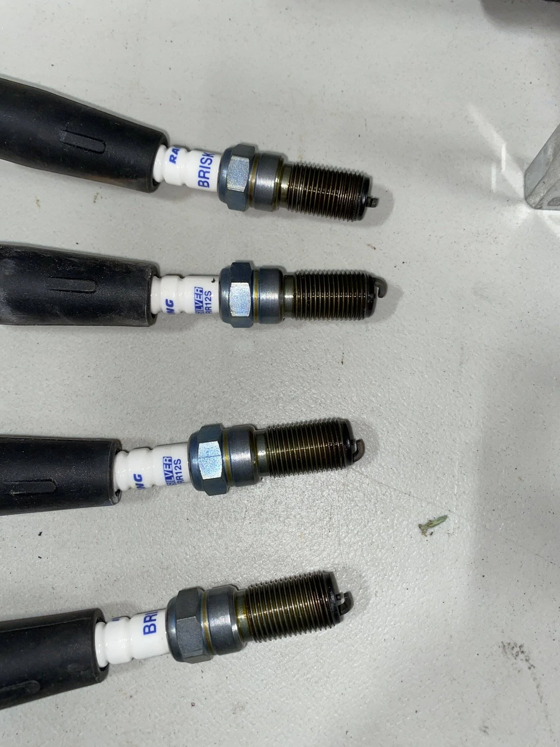

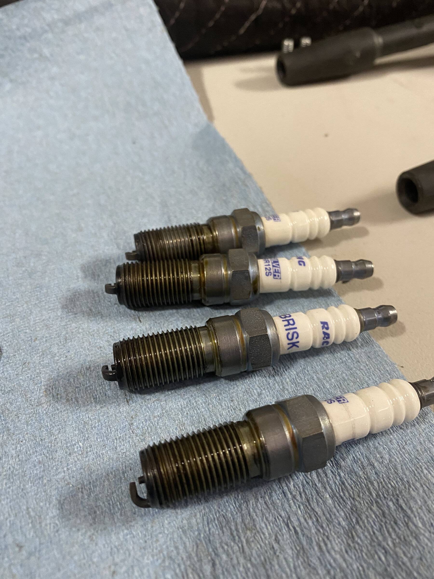

Compression test looks OK, just the one cylinder is a little lower, but close to the 2% variance. Got a picture of all the old plugs?

I'd be happy with those test results. I can't see the electrode area of them, are any noticeable cleaner? Could signal that you have a coolant leak and the steam will clean the plug.
Somebody already mentioned it, burning coolant has a very distinct sweet smell so it should be obvious if that is happening.

Nope all plugs were similar and electrodes looked good. And no smoke wasn’t sweet had a burning smell to it tbh. And like I said number 3 cylinder when I pulled out the compression tester has oil on the threads but no other one. Even did it twice and got got oil both times
