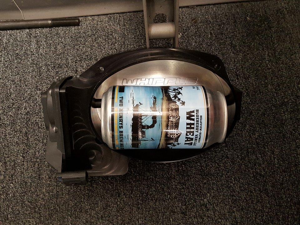

Look at it, just look at it!

Just a lil ole TB. No big deal.

Wow that thing is a monster!! Do we have any flow specs on it versus the 132mm version?
