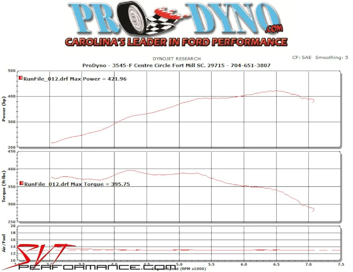

The problem with SW isn't the headers. The headers have been proven here by several members that it performs as well as the other brands. But so far Barrel is the only one to dyno a full SW set up, I have the same set up but haven't dyno'd. So there has been no test to prove the SW catback isn't restrictive.

Do you have links with SW headers and number OTHER THAN Anthonys car which uses a different tuning software, we want to keep this as close as possible when comparing.

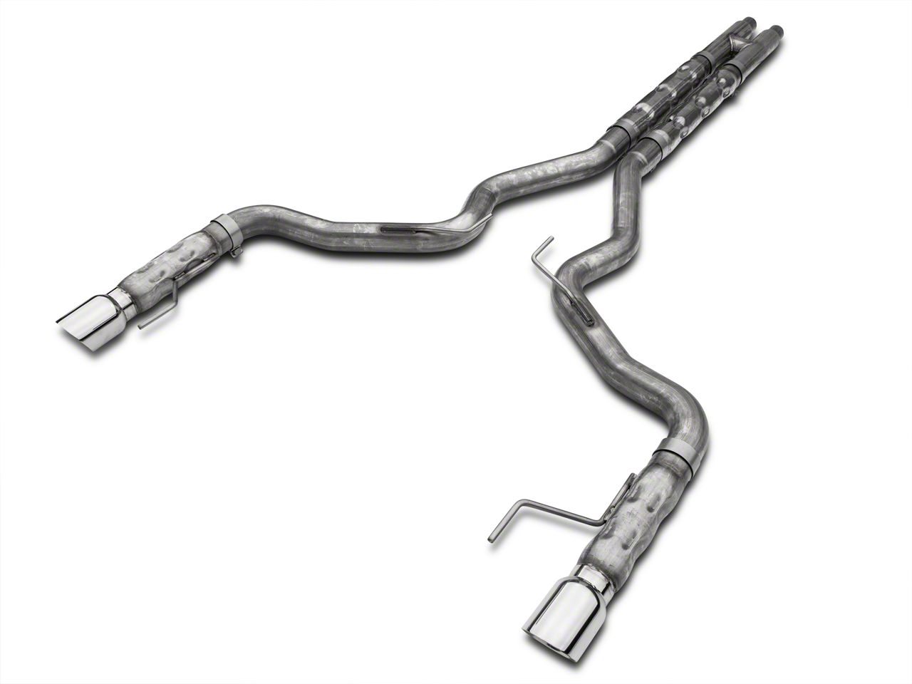

not really,
the headers are the exact same headers, if your doing the full system,
you have the headers, into their retro chambered resonators 3" pipes, then retro chambered exhaust. The only difference is a little bit of routing. which isn't going to change anything as far as power.
once you go to a full system, you take the resonator out of the equations.
like I said, we'd be happy to test the same car out back to back. I don't think your going to see a big difference. we haven't seen that on previous year coyotes. you have some cars dyno higher and some lower. The only way to really know, 100% is to do each system back to back on the same car.

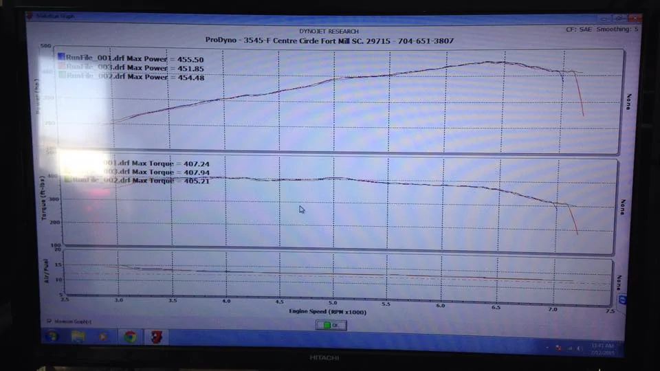

Here is another example of SW headers and catback w/ JLT intake.
