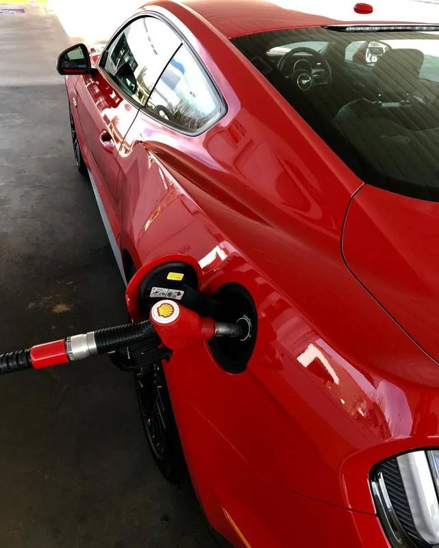

I always use 98 Shell V-Power, although there is BP Ultimate 98 in the tank at the moment (Christmas voucher.)
This is not a dig at the OP, but I just don't understand why people even consider 91 ron, even if Ford say it can be used. The idea of buying a V8 powered, high performance coupe and then cheaping out by using or even thinking about using 91 ron is strange thought process. The only time where you would use 91 ron is if you got stuck and had no other option (rare these days though.)
