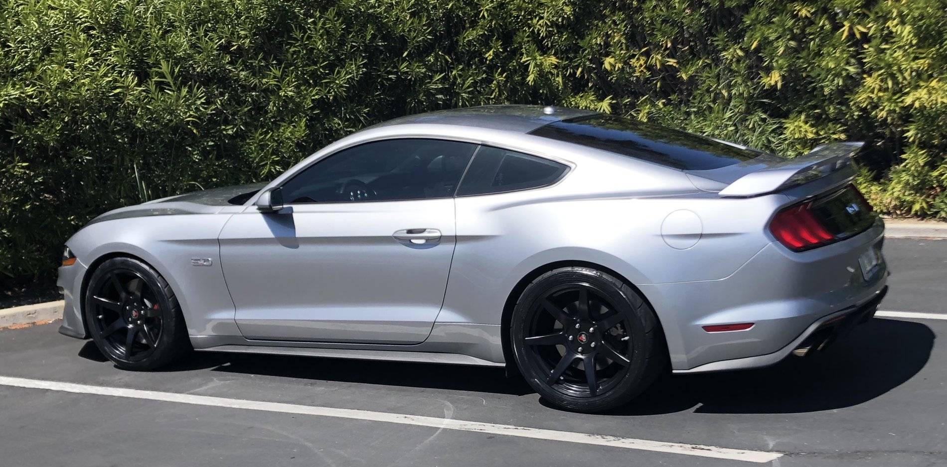

I’m running the BMR min drop (SP763) on my 20 GT with an Edelbrock and it sits pretty level.

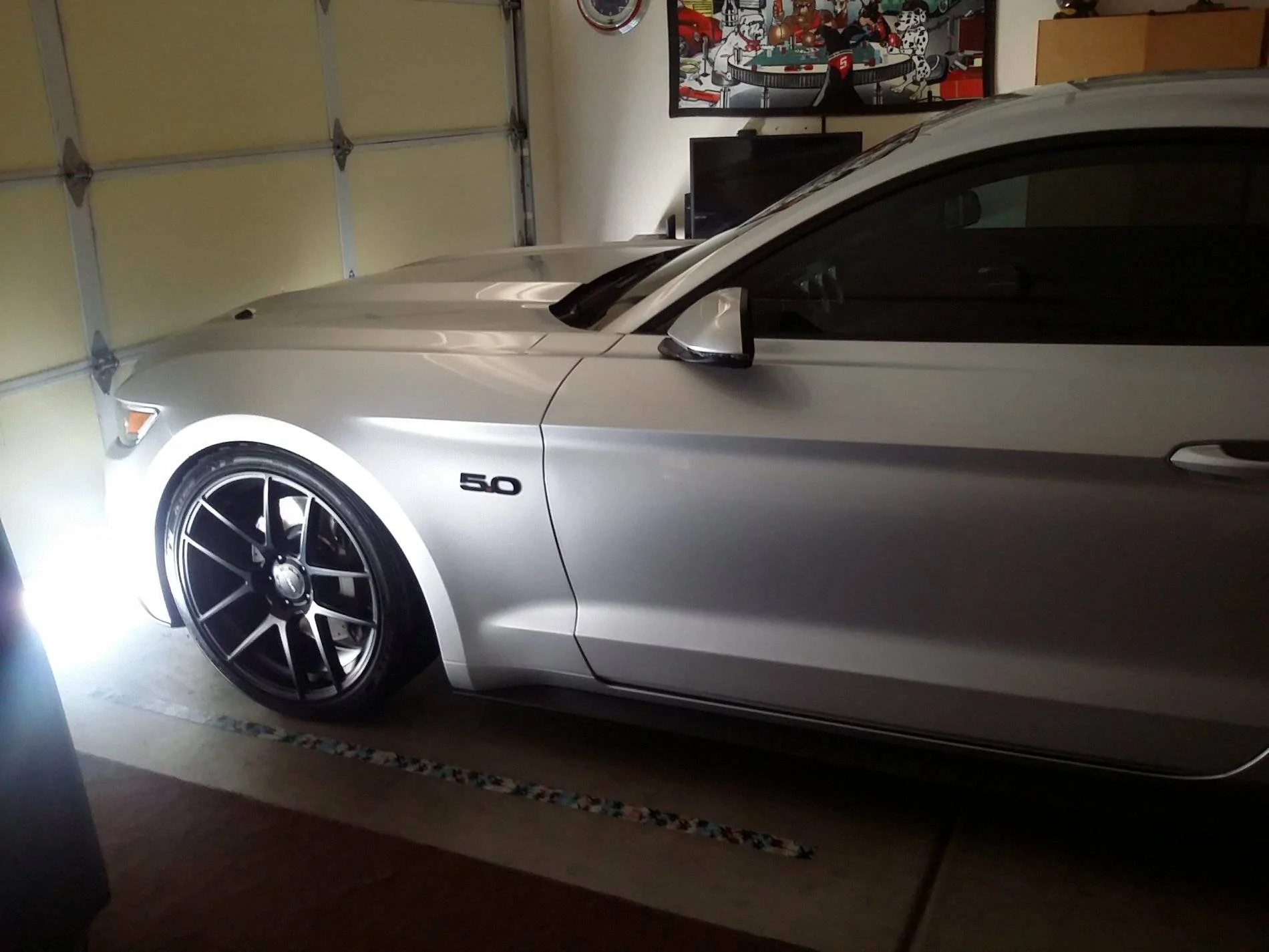

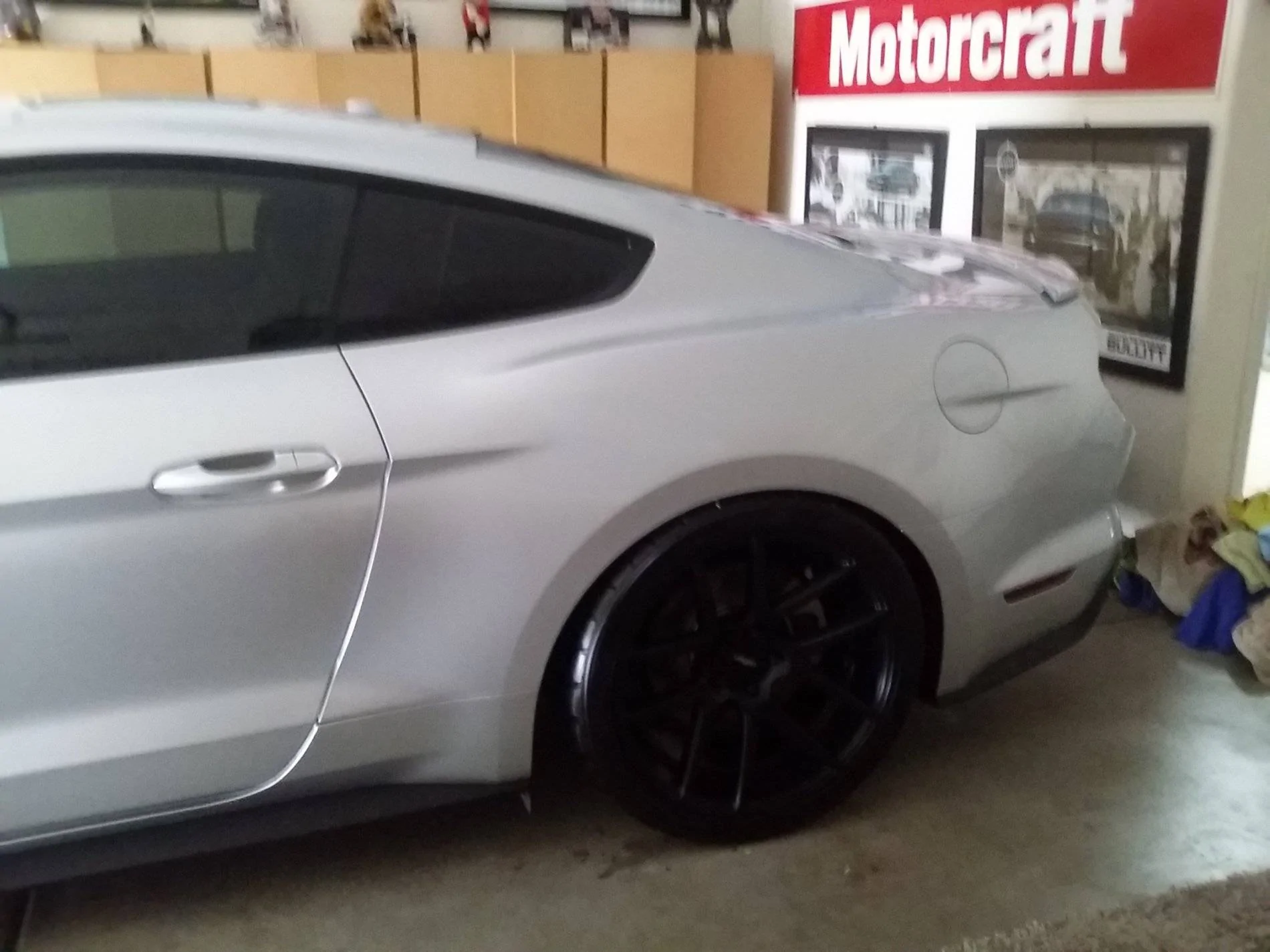

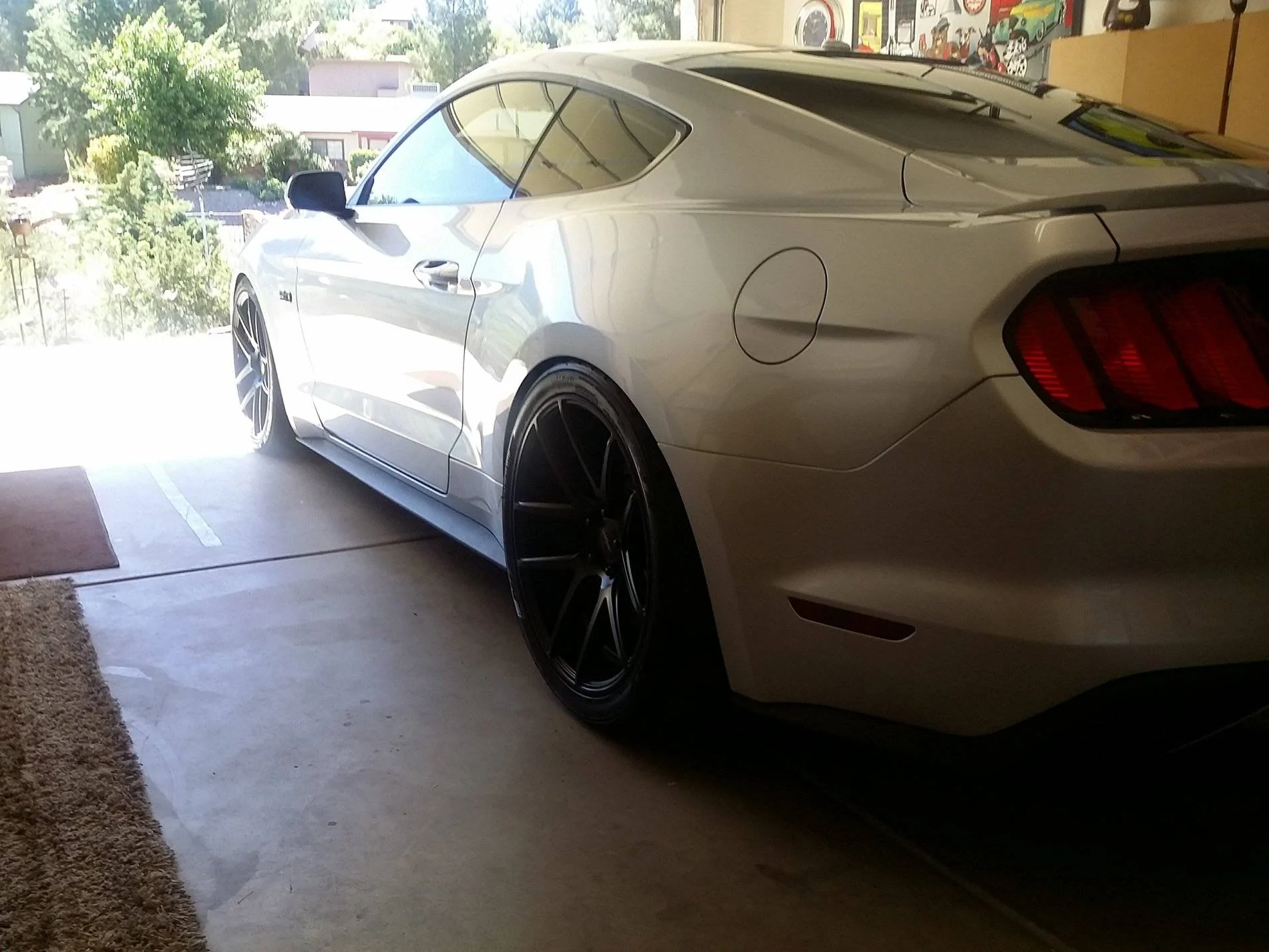

Eibach sport lines with a prcharger .

That bmr sp763 actually look really good. I guess I was just scared of the 7/8” in the front and 1/2” in the rear measurements but it looks really good on your car. How do they ride and are the wheels 19” or 20”?

How do the sport lines ride and what size wheels are they? Thanks
They’re 19 inch wheels and it rides better than stock.

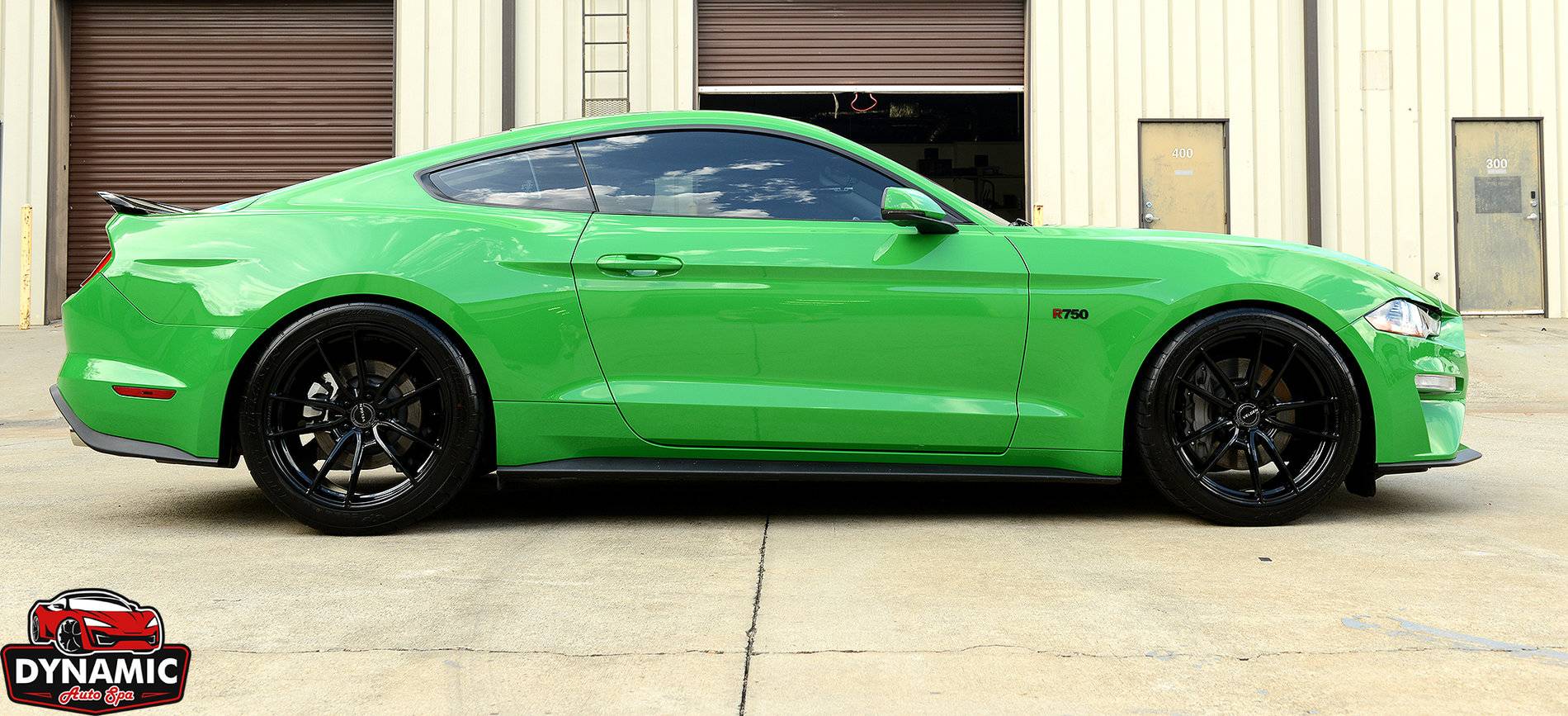

Steeda Progressive with Roush Phase 2. 20" wheels.

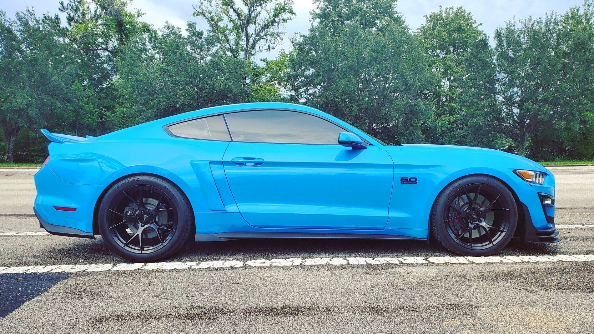

I would go with springs with a higher spring rate, due to the extra weight of the blower (it's more than just about final ride height; its about the springs ability to control the extra weight and reduce roll, nose dive, etc.). I'm using bmr sp083 with a whipple. Front settled about 1/4" or so in the front after the blower. Here is the result:

Not the best, but think its more the 750whp than the springs lol. Car is set up for all around performance & handling. If I was primarily doing drag, I'd go for a lower rear rate.

275/35/19 and 305/35/19
