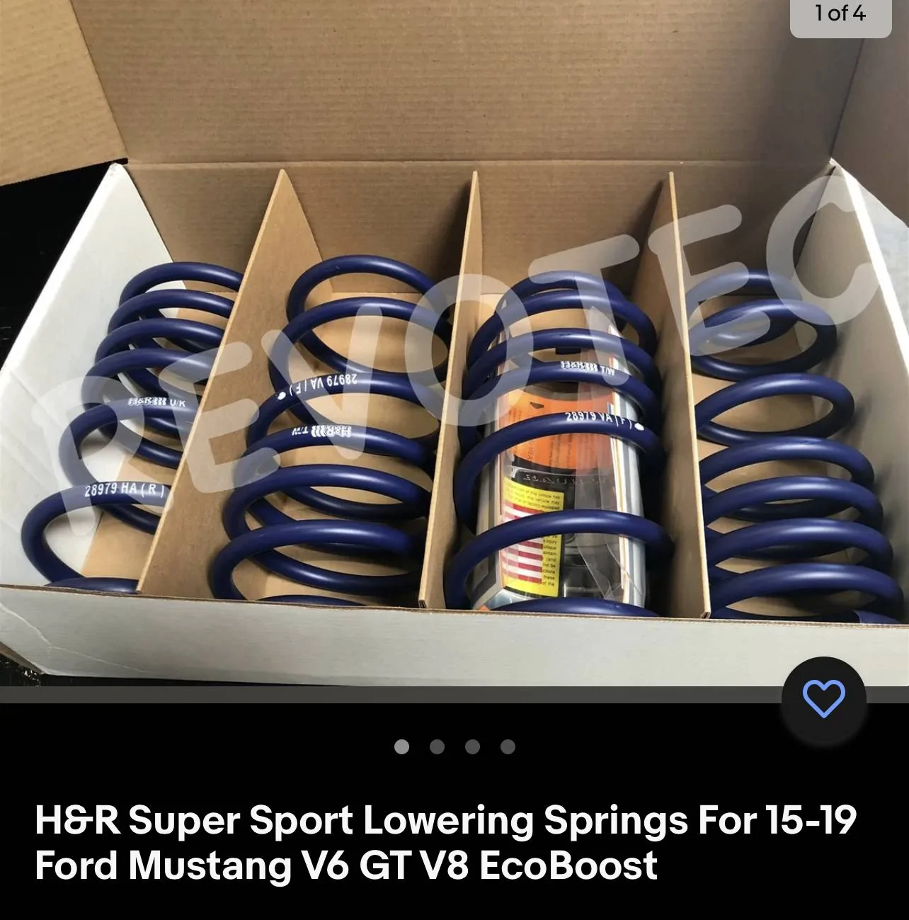

H&R has a set that will drop you 1.75” all the way around. I have a set. Haven’t install them yet but will soon enough.
Edit: It specified they will clear 20” wheels. But I won’t install them with out camber plates.

That sounds perfect for me. What supporting mods did you have to do? Do you need to get camber plates? I think I will be ordering these

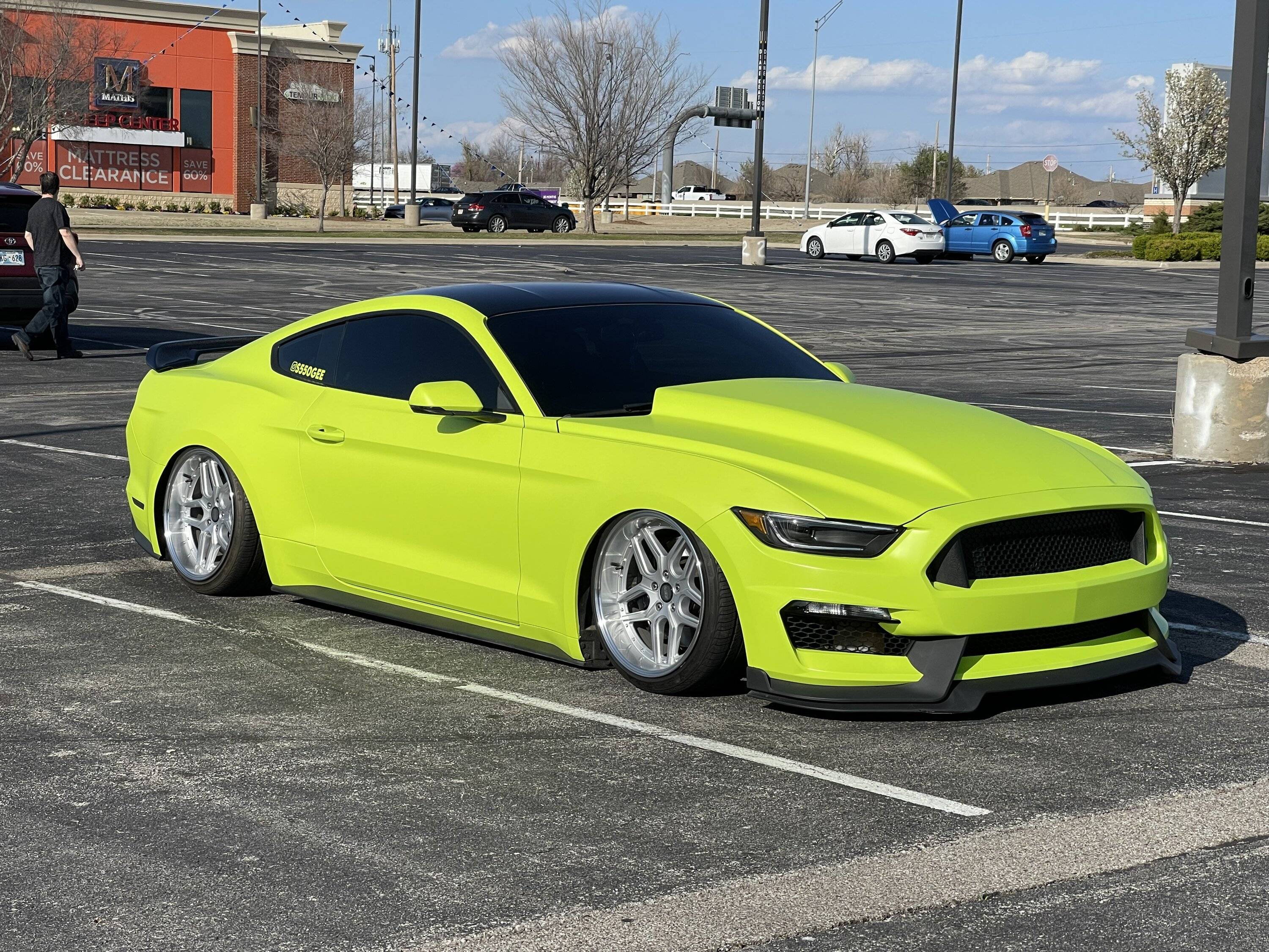

I see this guy around town. I think his is bagged however. Looks great though.
You’ll have to get new set of shocks and struts along with camber plates. Steeda has a good selection and yes camber plates are a must. I mean you can throw them on stock suspension but you wont get any of the good that comes from a properly lowered vehicle. Also do you have magnaride? If so, you’ll have to get coinciding equipment that will work with your vehicles suspension system, unless you want to scrap the whole system all together. These springs won’t work on cars with magnaride just fyi. For reference these are the springs
Edit: I haven’t lowered mine yet. That’s gonna happen in the next couple of months.
