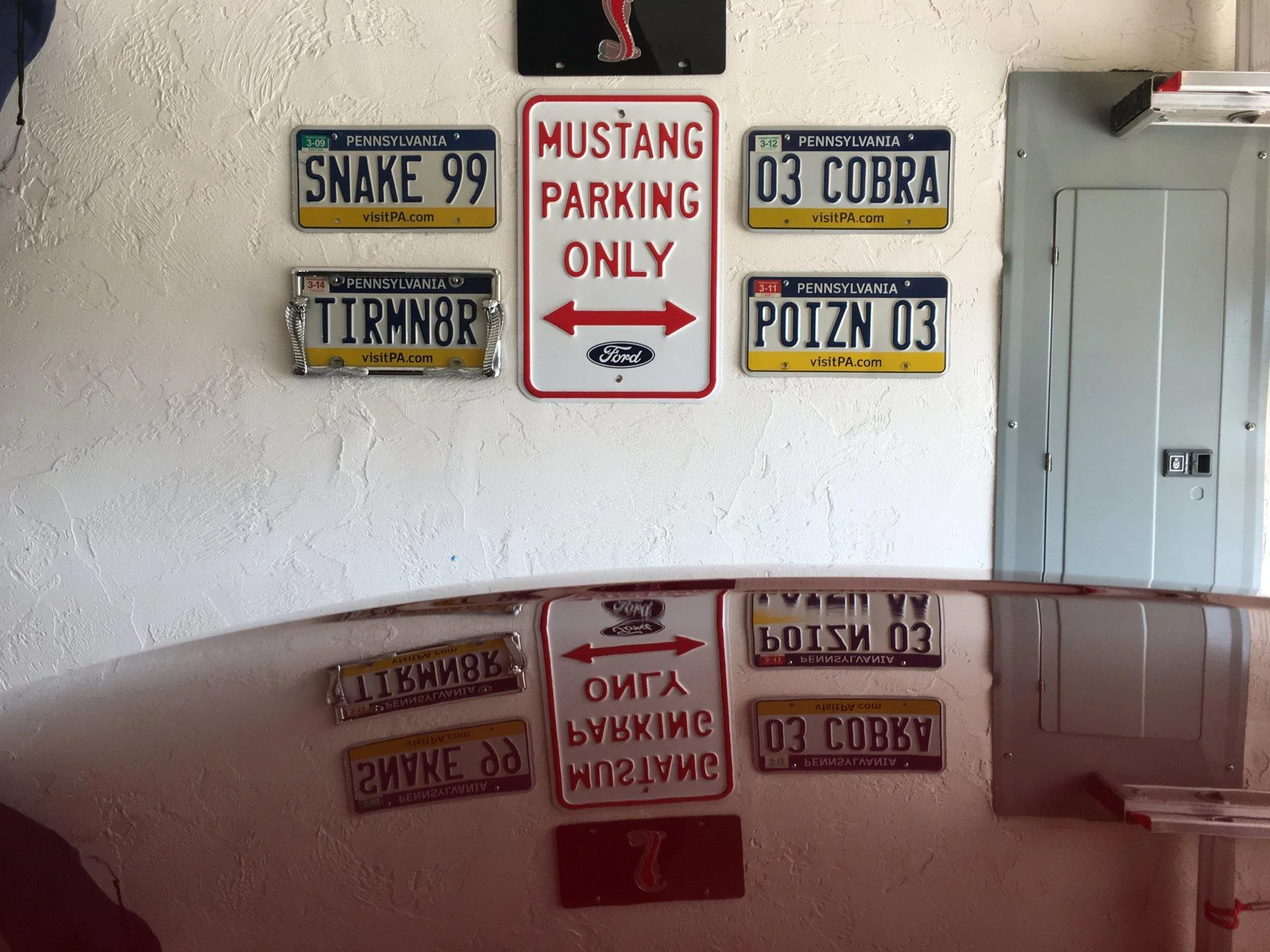

I just applied Adam's ceramic coating and ceramic booster, the kit was about $100 on Amazon...this is the reflection of some garage wall signs in the roof of the car:

Looks amazing. How long did it take you from start to finish? Also how long it supposed to last?

Thanks! It was REALLY easy to use. Here's a link: https://www.amazon.com/gp/product/B07PQ2BL92/ref=ppx_yo_dt_b_asin_title_o01_s00?ie=UTF8&th=1
I got the complete kit with the primer, ceramic coating, and booster plus 3 super soft towels. It says it should last 6-8 months. It's much easier to apply and remove than regular wax. I washed the car with dish soap and dried it; wiped on the primer and let it evaporate (I think it just might be some kind of isopropyl alcohol); wipe on and off the ceramic, and let it "cure" for at least 4 hours. Then wipe on and off the booster. The wipe on/off takes maybe 20 minutes per product. The car only has 3000 miles on it so I didn't need to clay bar it, but I've used Mother's clay bar on other cars and it does a nice job. Now THAT is more labor intensive.

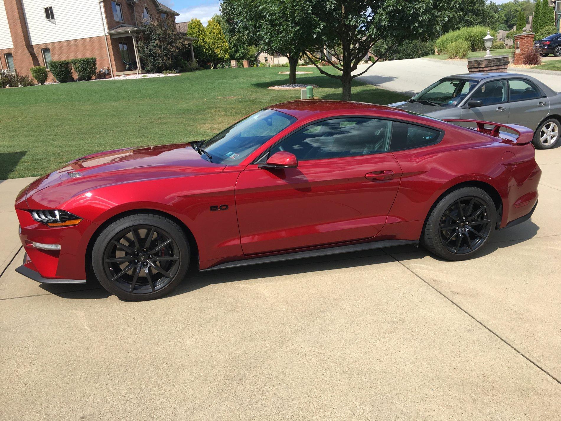

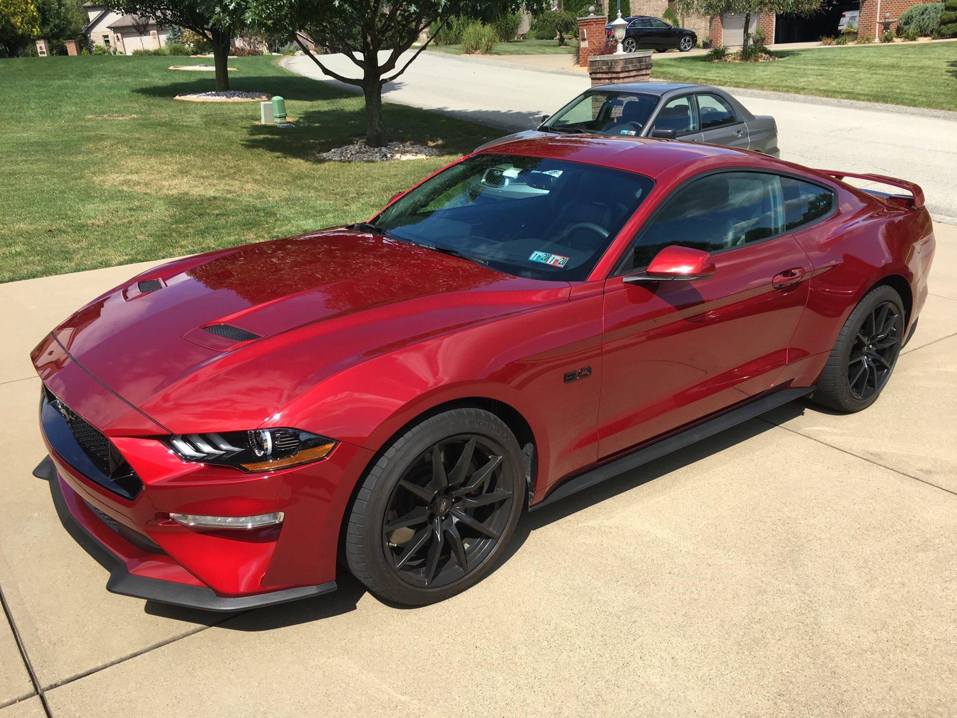

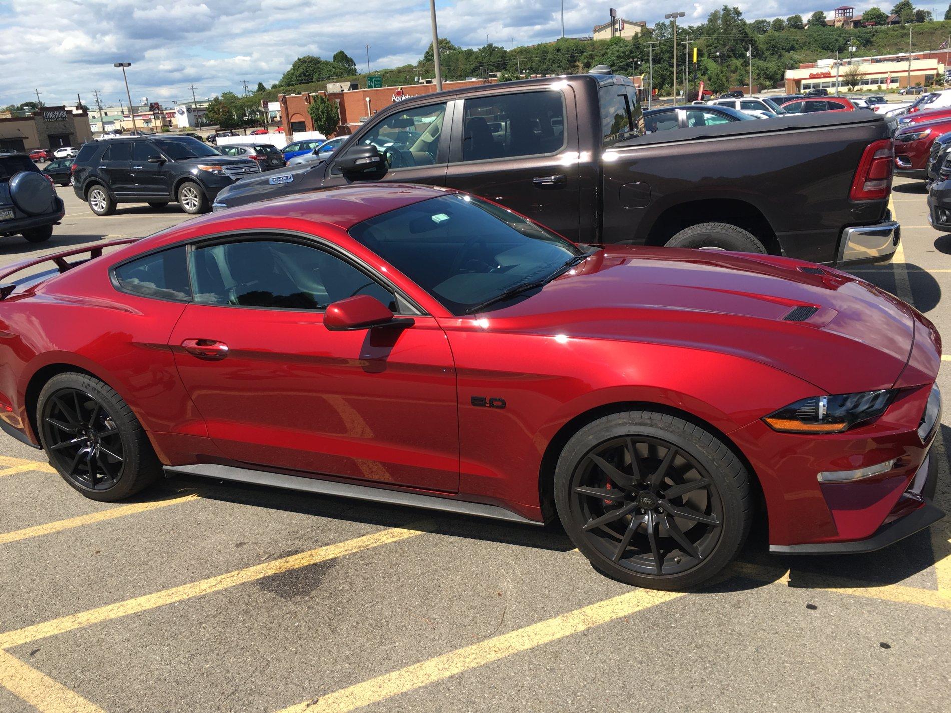

Looks really good. Will consider it for my wife’s car (I have detailer applied Gyeon on the Mustang). Could we see some pics of the entire car. I love Ruby Red.

Oh no, don't make me post pictures LOL! Thanks. Snapped one just now coming out of the mall (some guy rolled his eyes as he walked past) and two more in the driveway. Here you go...
