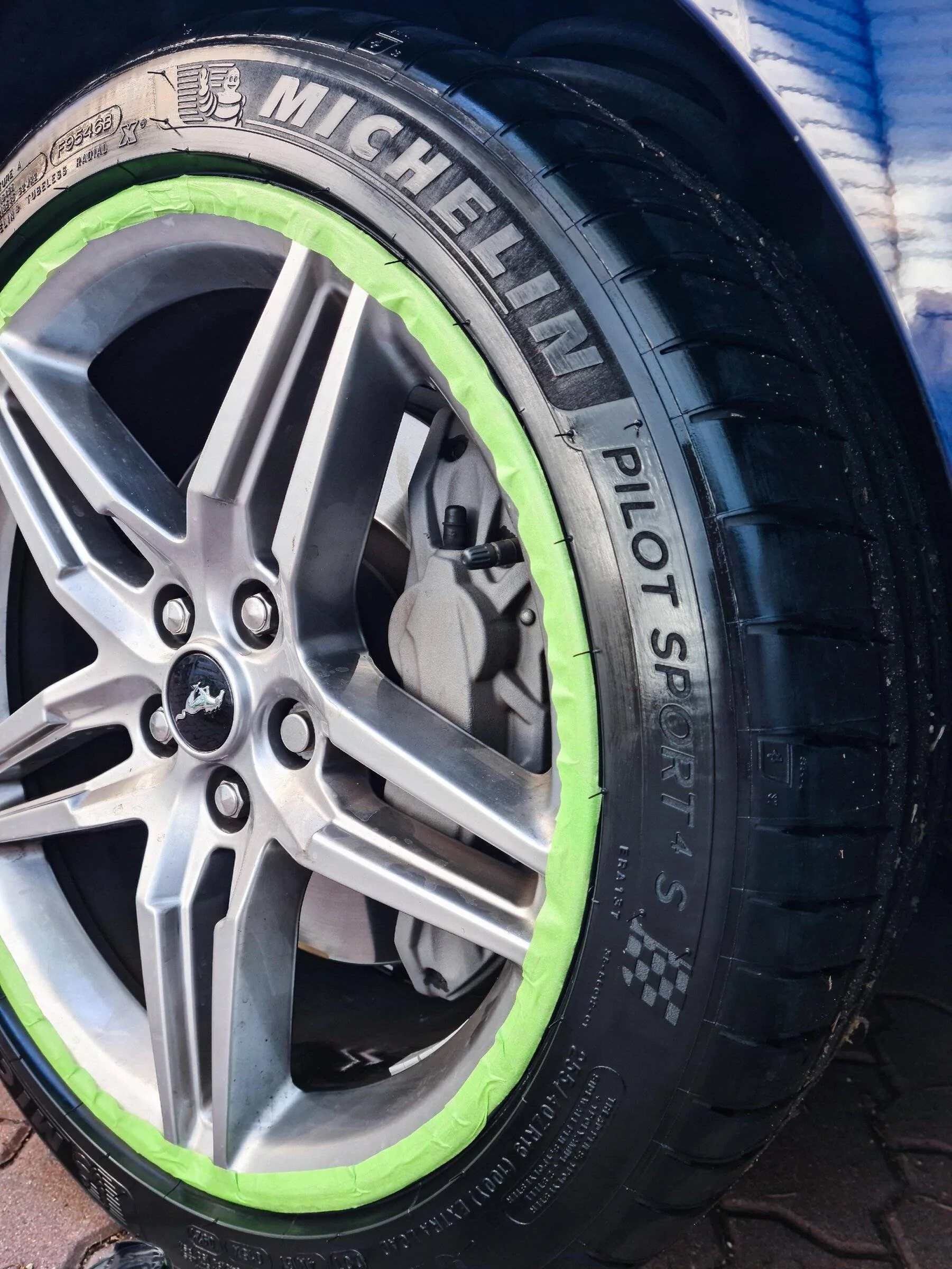

Correct. EU Spec EcoBoost Premium comes with 4 piston brakes on the front. Correct OE numbers are 2044140 for brake pads and 2470369 for disc brake rotor. However OE brake pads are insanely expensive. I put aftermarket Delphi Technologies and they work fine, but are squealing, which is kinda embarrassing at car meets. Next time I would go for Febi Bilstein, Stoptech or Hawk Performance brake pads. I guess you have the same front brakes like I do.
