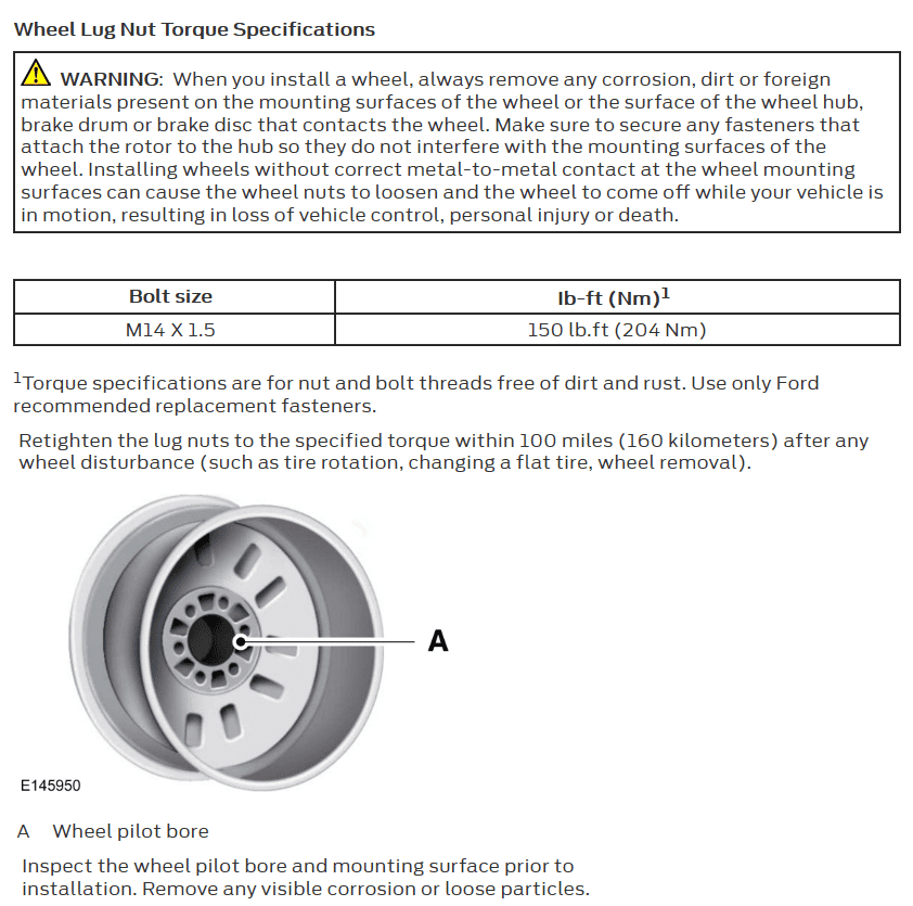

I'm a newbie to the torque war. Will anyone tell me what the torque rating is for 20" Mustang wheels using stock lugs without spacers, please.

I would consult the book, but, the dealer forgot to put it in the "secret" compartment in the glove box. I cannot retrieve it until Tuesday. So with all the knowledge this group has shared in this space I figured I would get a reliable answer. I was told by some that I should be careful of what I ask though. It may result in a simple hypothetical question of "what time is it...", and being told how to build a clock. Too hard to believe something like that would happen here. Or would it?
from the online manual:
https://www.fordservicecontent.com/...etCode=US&bookcode=O94050&VIN=&userMarket=USA
