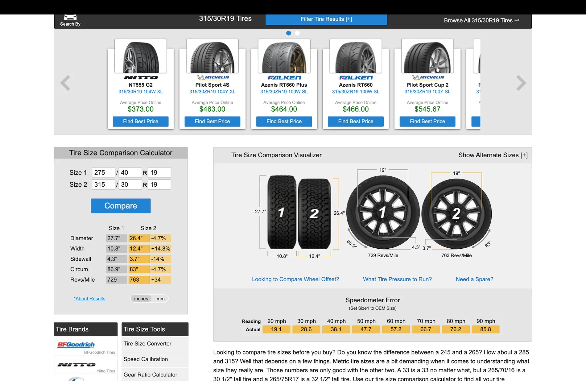

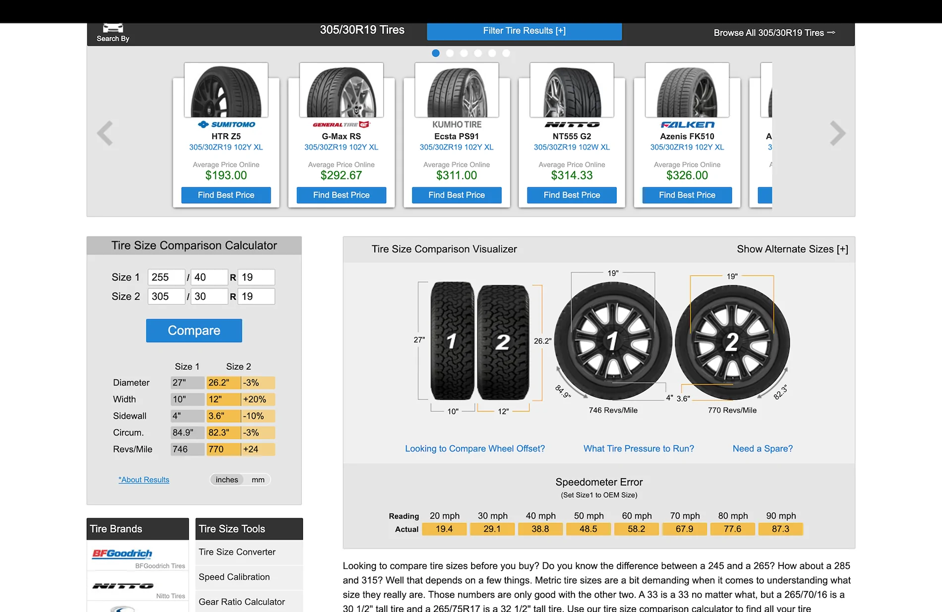

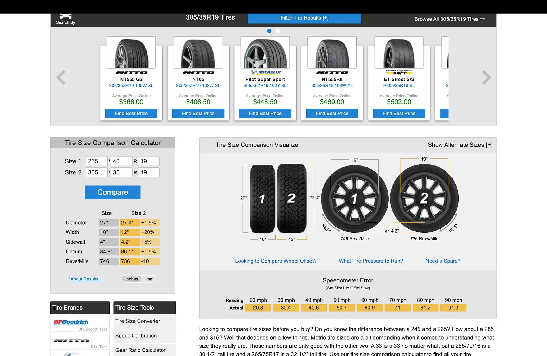

A general rule of thumb is to stay within 3% of the existing circumference. You can stray from this figure, but the more you do, the greater risk there is of speedo, ABS or shift point differences. In going from a given diameter to something way shorter or taller, you're effectively changing the gear ratio of the diff.

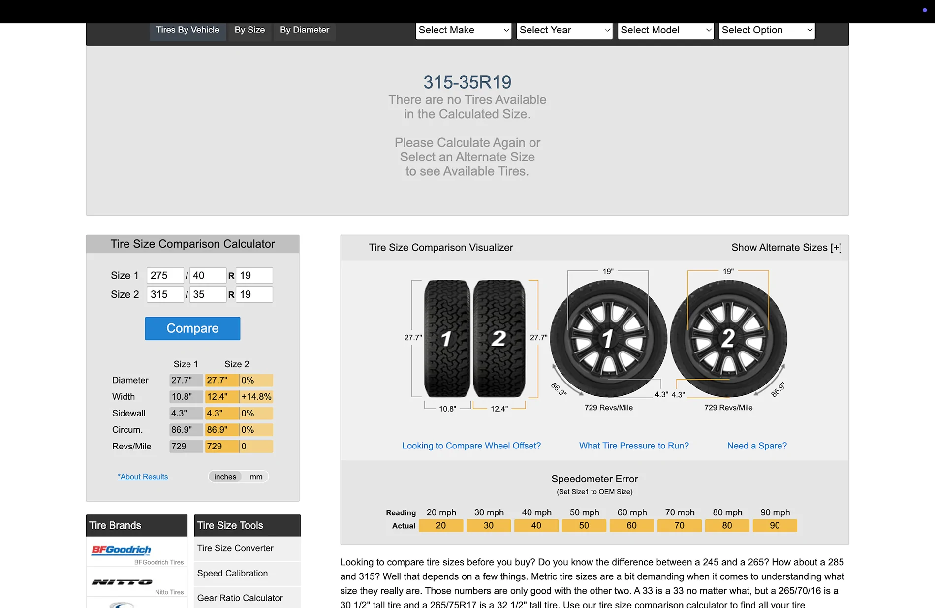

I did some initial comparisons, first, doing a straight swap. In the direct swap scenario, the fronts are within 3% of factory. But the rears are close to 5% out. In the second comparison, I changed the tire profile to a 35 sidewall; this brought the circumference much closer. I did not study tire sizing on-line or differences if going a bit skinnier on the tire width. This exercise was just an initial "what-if".
From a quick read of one of the threads referenced above...One thing to keep in mind: going from a 40 profile sidewall to a 30 could produce a greater gap in the wheel arch. Going back to tire sizing, at least a few commented on using the HP rims, with a slightly skinnier, 35 profile tire; this reduced the wheel arch gap, increased tire selection choices and brought the circumference closer to the originals.
For those that did the straight swap, rims and tires, I didn't study the threads for their feedback, how things were (speedo, shifting, etc.) afterwards.

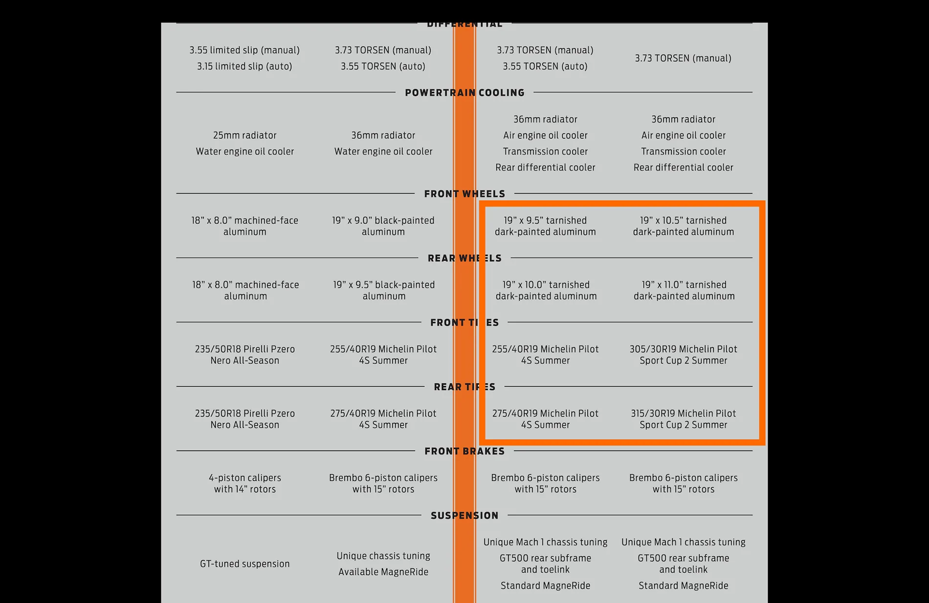

Wheel offsets, so you can see the differences.
Mach non-HP wheels are +40 front, +52.5 rear, 255/40/19, 275/40/19, 19x9.5, 19x10.
Mach HP wheels are +24 front, +52 rear, 305/30/19 and 315/30/19, 19x10.5, 19x11.
The non-HP to HP rim swap is straight take-off and put-on. No suspension changes will be needed. In changing the rim and tire size, it'd probably be a good idea to get an alignment, if anything to ensure the bits are dialed-in nicely for the new tires.

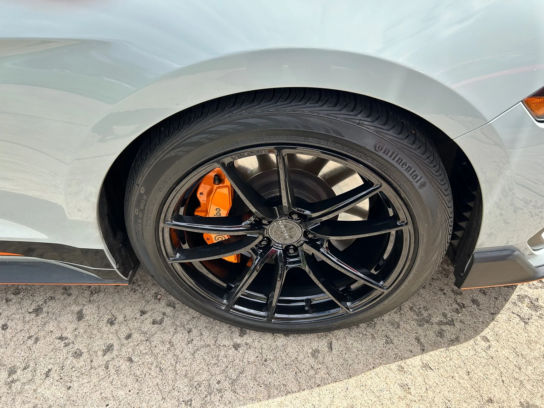

Well done! Thank you so much! I will save this for future reference!
Of course I am about to throw a wrench in the whole thing for aftermarket instead
Actually whittled down to what I want…
These Niche wheels, 19x10, square setup.
Question is which Michelin Pilot 4S size? Thinking 285/35, but can I go bigger? Don’t want anything sticking out too far or rubbing.
I am probably forgoing the fender flares.
(I have a 20x10 square setup on my ‘15 GT which I love. Michelins are 285/35 on it)
Thanks so much 😎

You can go bigger like a 295/35 but not ideal on a 10. 285 is ideal on a 10. Congrats on the car! She’s beautiful
