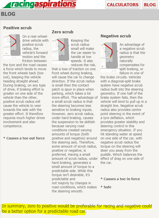

Changing offset will:
Affect scrub radius
Affect tire wear
Affect steering effort
Change spring and sway bar stiffness
Alter track width
The reason are explained in part in these links. Some good reading below :
Scrub radius
https://www.moderntiredealer.com/ar...-customer-understand-why-wheel-offset-matters
Changing track width by changing offset
http://forums.pelicanparts.com/pors...ct-difference-wheel-track-width-handling.html
https://trackmustangsonline.com/threads/getting-a-wider-track-width-worth-it.6891/

Do you know if the S550 comes with a positive scrub radius? If so, do you know how much? I tried chalking the tires but my results were inconclusive. Also, I can't find anything specific or consistent. I've also found as stated above that negative is generally used for safety now, but also found that (paraphrased) "most cars including rear drive are now being built with positive scrub angles."

Hi Dave,
I do not know for certain what the factory scrub radius is on the S550. Your typical economy car will FOR SURE have negative (the car will track straight in undesired road conditions) but manufacturers may design "sporty" cars with some positive scrub to give the car better turn in because they know the target audience of that car would prefer it that way.
Without actual numerical values, I can only speak from experience. I run 285/35/19 ET35mm square on the track and it feels great. I've driven this setup on the streets only once and it felt as though the steering was more immediate and direct but that could also be from the wider tire profile.
