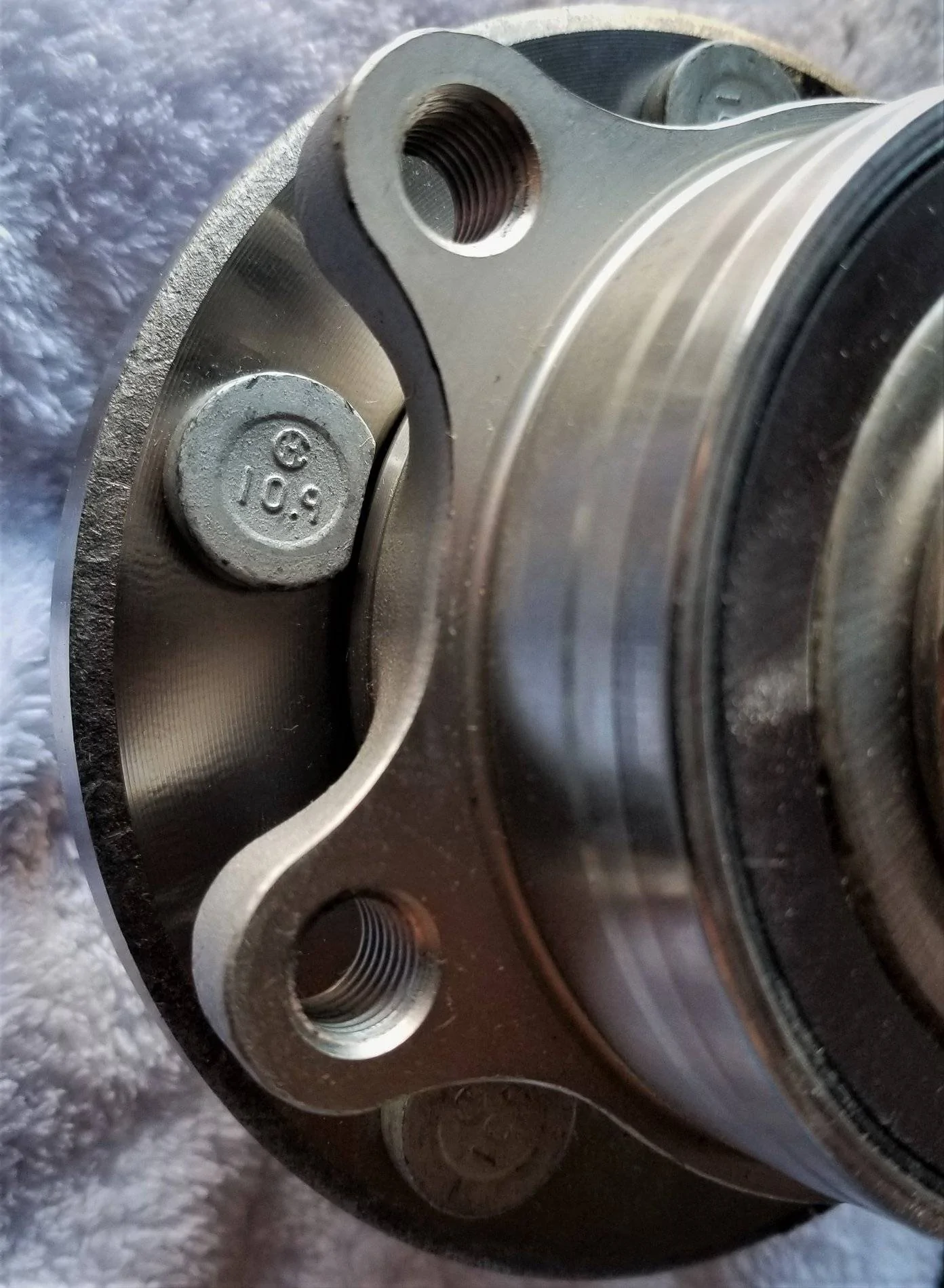

The factory studs are an M14 x 1.5 size. That correlates to a .551 (or ~9/16") and the closest number of threads on the chart would be 18, so look at the 9/16" x 18tpi columns. I forget what grade the factory studs are but I'll look to see what I've pressed out in the past. Regardless, charts like the ones linked are still generic as there are quite a few variables that have an impact that aren't necessarily given consideration.
Epiphany
Oct 11, 2015
78
7,983
13,643
Global
I like to disassemble things.
I grabbed a GT500 hub from the shop to verify the factory wheel stud grade.
So you'd be looking at the 9/16" x 18tpi under the 10.9 heading which shows 170 ft-lbs dry and 130ft-lbs with Ti64's lube. Both figures are a bit high and I wouldn't use either one of them.
