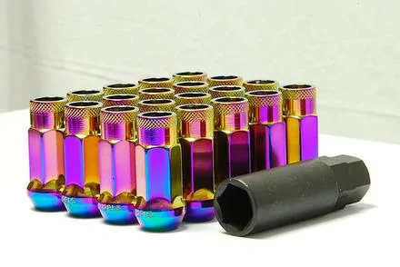

i was looking at these ^ because i don't want to deal with rusty wheel studs, and ^ can be bought with optional end caps (if the stud dosen't poke through)... but i couldn't find any other in aluminum or from a reputable brand.
i figured if these start to rust for the reasons you shared, i could just wire brush them up and hit them with rustoleum or similar.
for several times the price ZL1 has long titanium lugs

I have these as well and so far they have worked fine...and look much better then factory chrome IMO. However I left them open not using available the caps.
When you first receive the packaging states max torque spec around 85ftp. I contacted Mackin direct to ask about the 15ftp GT 350 spec as that model was listed as comapatible on website and they said it would be no problem.
So far mine are holding up like new but mine are in color pictured.

how long have you had those? i wasn't sure about those because i was worried about fading and damaging the finish because i swap wheels/tires more than i want to...
Since last July and I also take wheels of when I detail the car...at least 3 times since.
