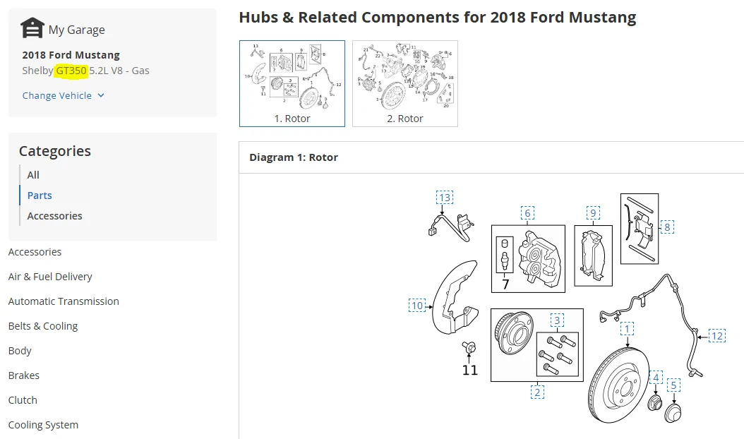

Do you mean the diagram of a mag ride doesn't have a cap?
The diagram shows an S550 rear floating-caliper brake assembly for a GT or an Ecoboost model. A GT350 uses different running gear than the rest of the S550 product line and there are no caps on either axle because the hub design doesn't allow it.
Understood. It seems the Ford parts system is misleading because it lists a cap in the parts list and diagram for a VIN of a mag ride 350. Why doesn't a cap fit a mag ride hub?

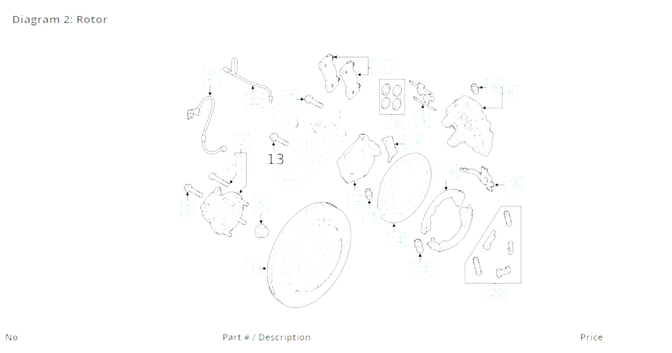

It's a quirk in the parts system on the website you're on. I went to Levittown and got the same result, but when I scrolled down the page, I saw this, Diagram 2, which is thee correct one:
