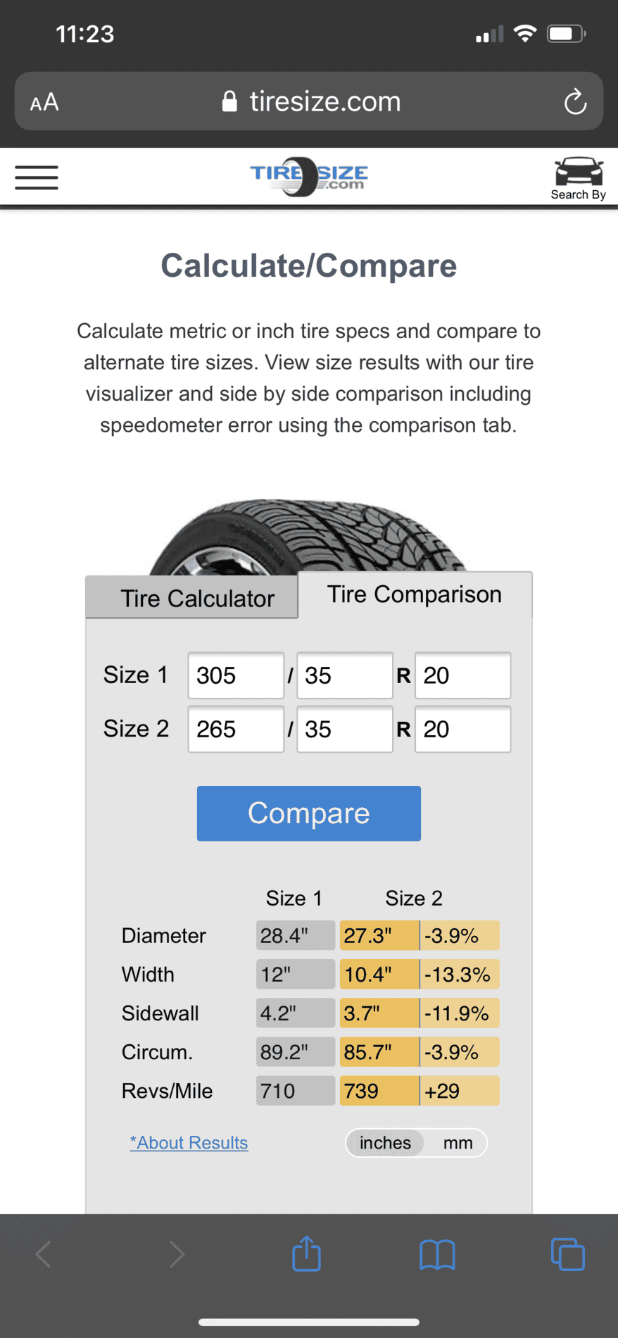

305/35 20 i think fits and people here use it, but it is kind of tall; see attached tire size calculator comparing to the factory 20” size. I would suggest finding a tire you like that has sizes for both wheel sizes vs just picking a tire size. There are other options which are likely cheaper if you’re mainly DD driving the car and occasionally being rowdy like any other mustang owner would be. 285/35 would also fit the rear width and likely open up tire selection.
