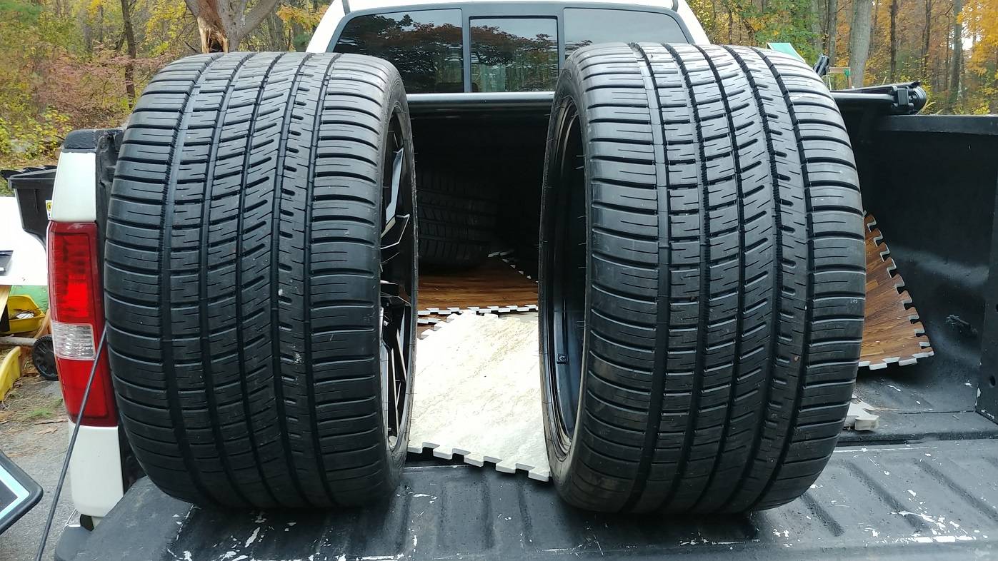

19x11 +50 with 325s fit nicely. They poke out just a tad bit at static OEM height (will probably tuck on a hard launch or lowered), but there is plenty of room inwards. So a +54-56 offset would be perfect.
