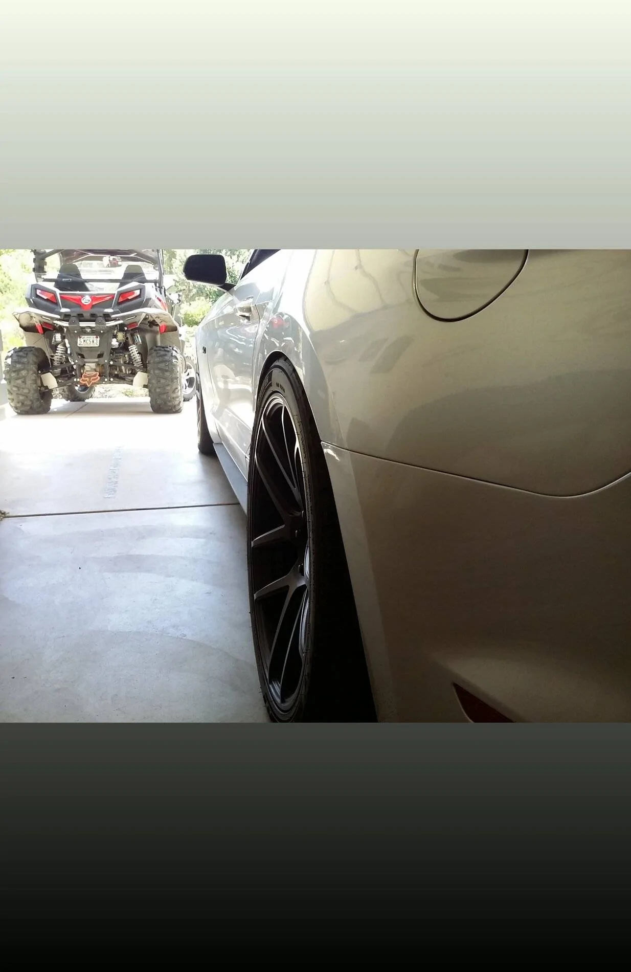

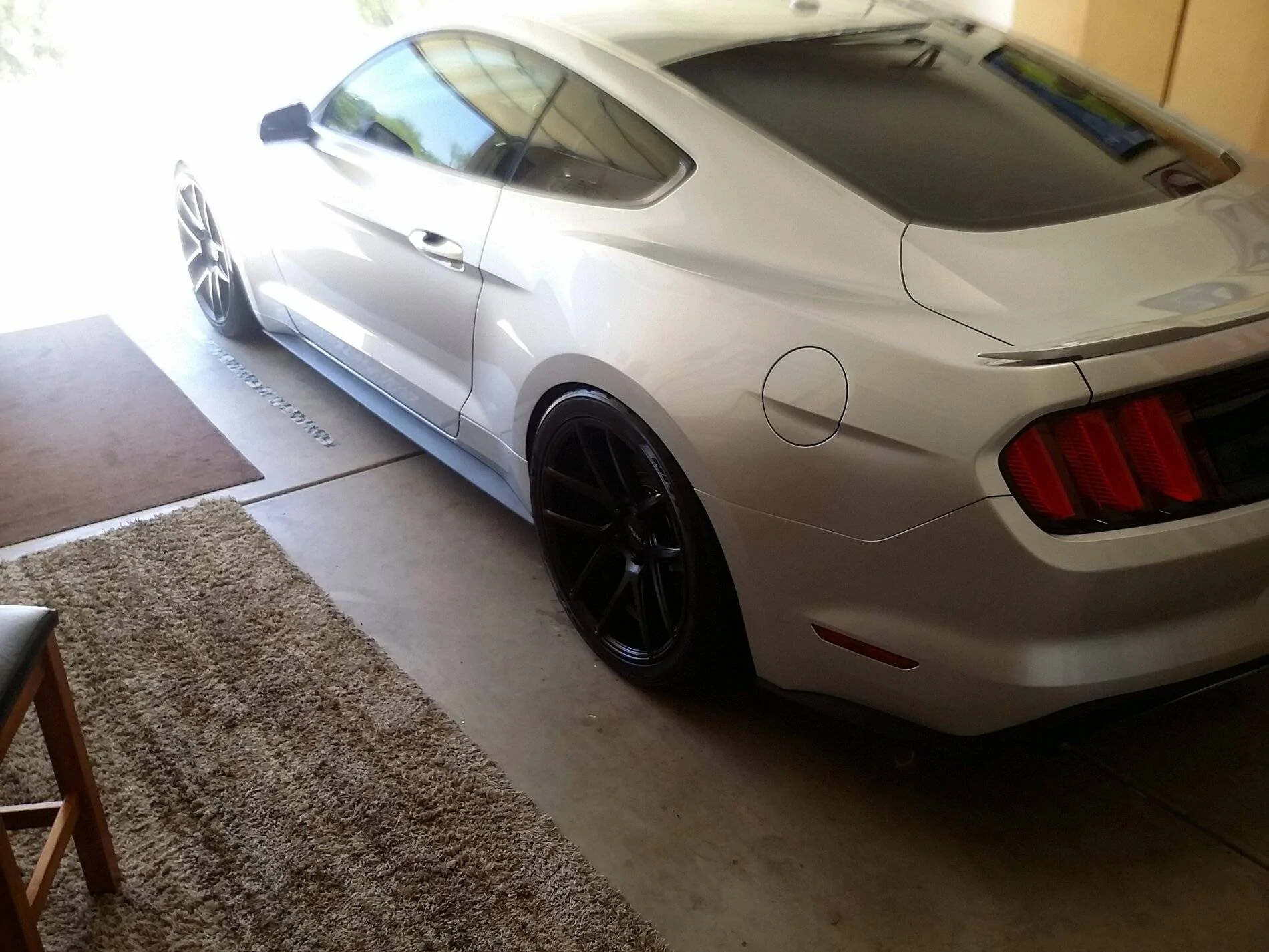

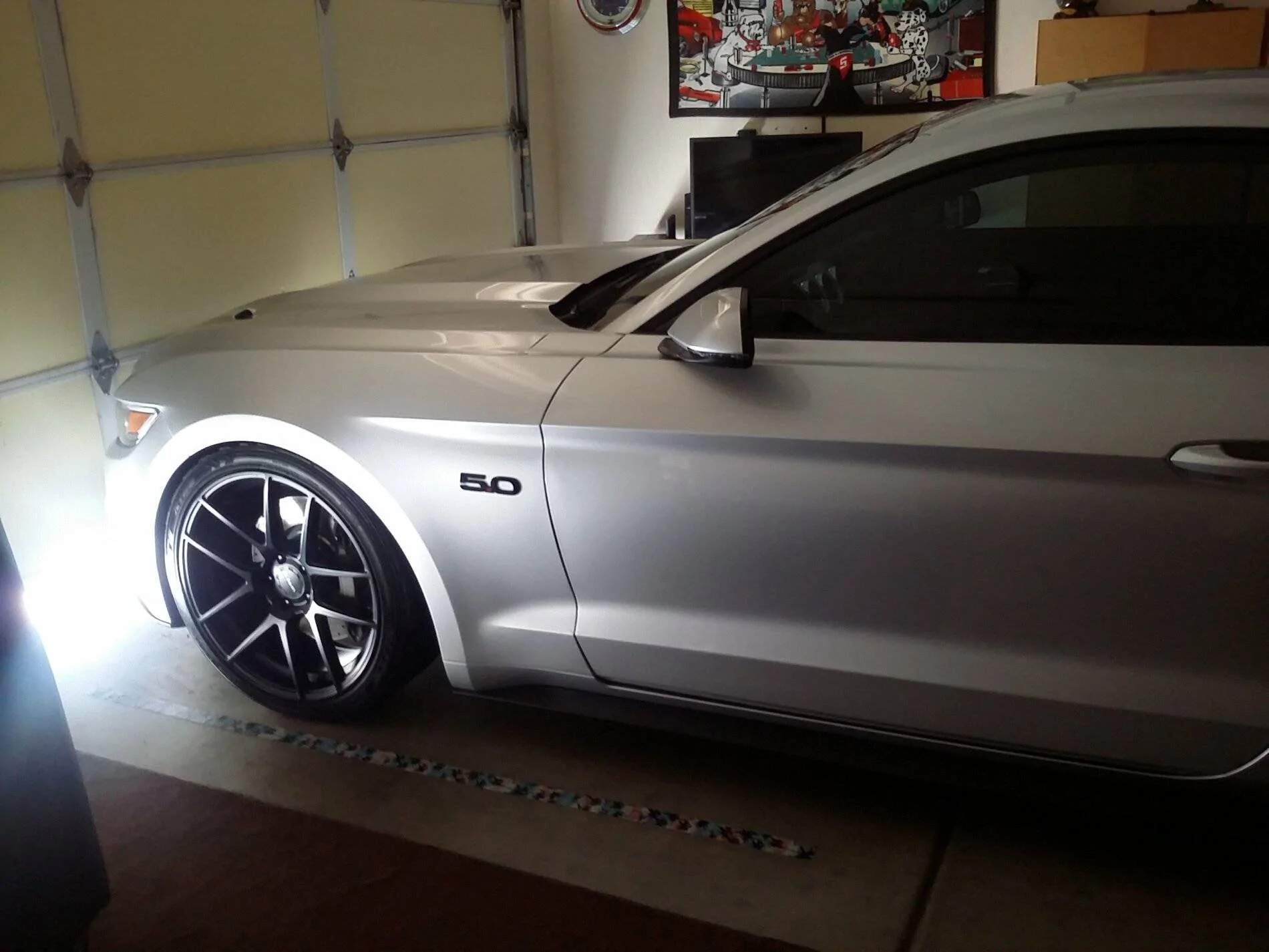

Might consider spacers , running velgens with following specs , on a sportine drop , so approximately 1.5 in front and rear fronts 255/35 20 wheels 20x9 +35 rears 305/30 20 20x10.5 +45 . No rubs and set flush ..
Why would he consider spacers? With +20 offset his front wheels will sit 15mm further out than yours, and his +35 offset rear wheels will sit about 4mm further out than yours (taking into account your wider wheels).
Your right ..... the offsets always screw with my math in my head .

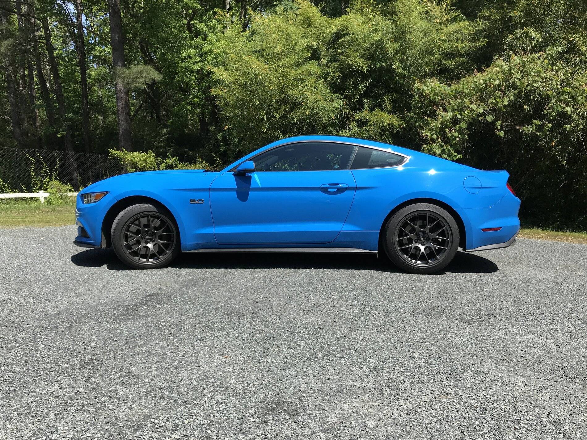

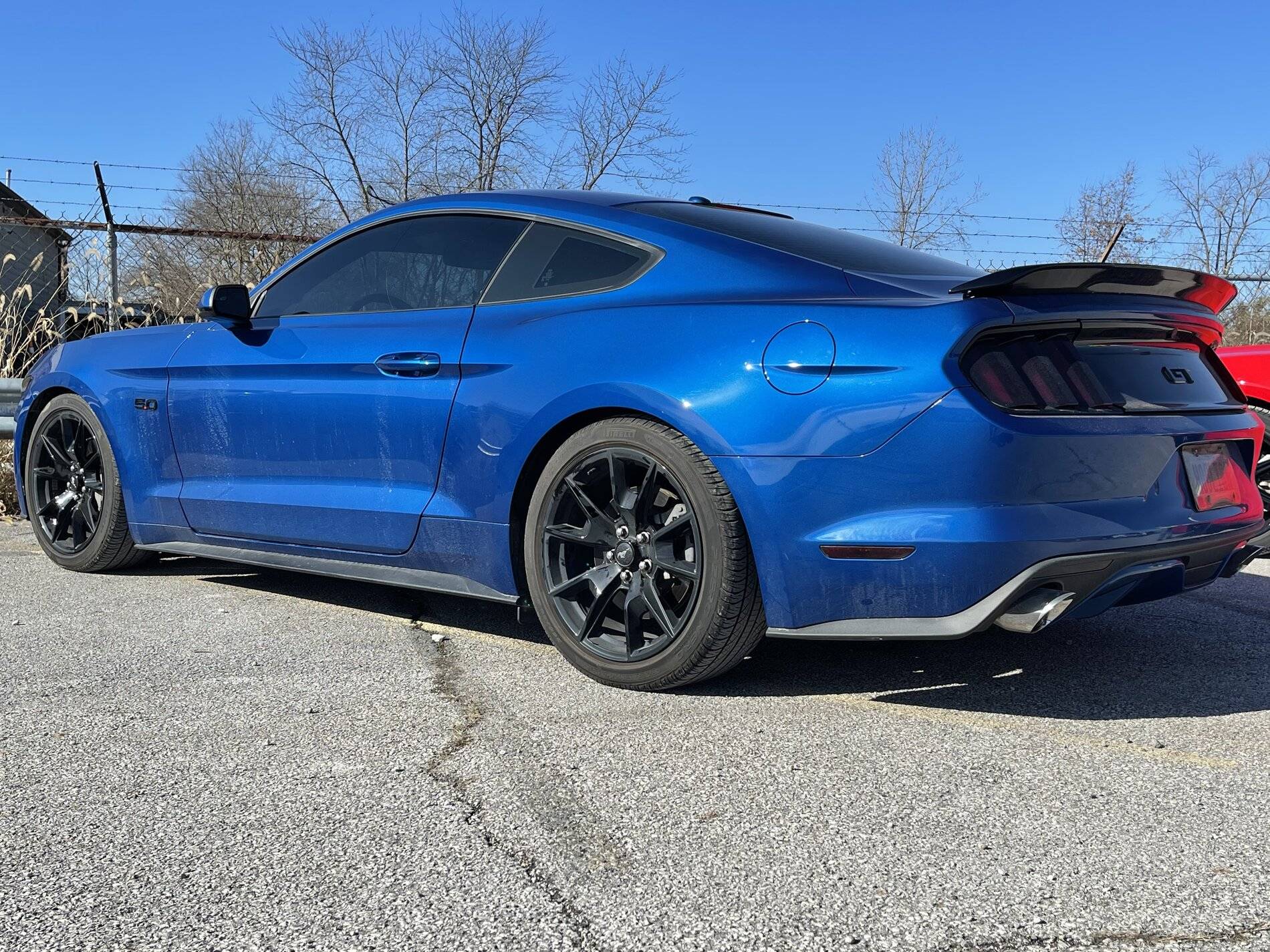

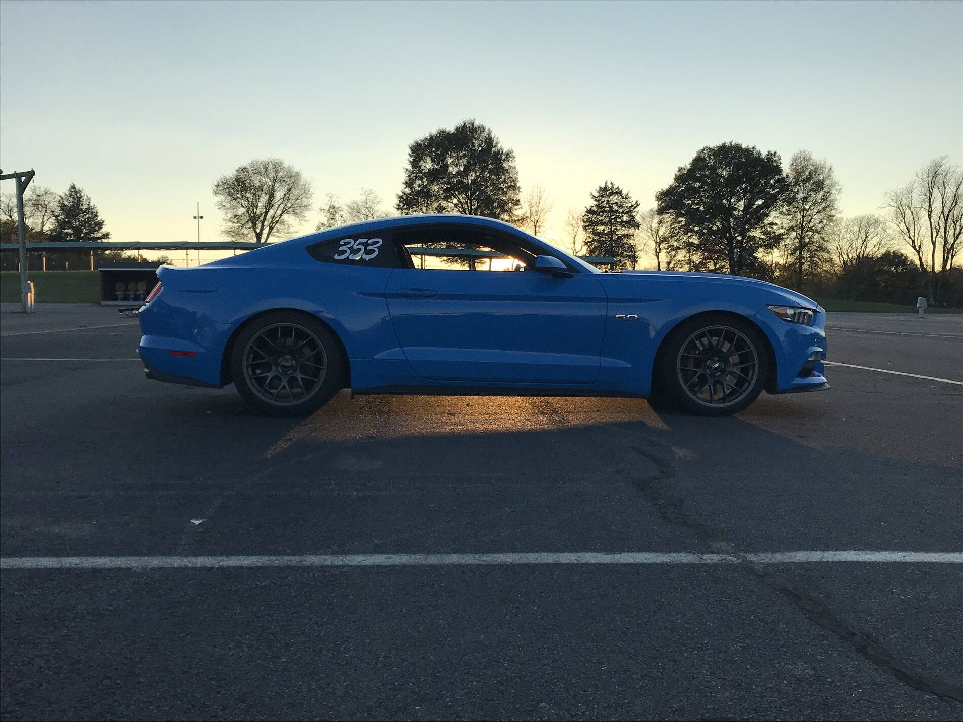

No, but it might mean that the relationship between the rear and front ride height changes. Best is to use that calculator to see. In my case, I calculated the tire sizes to: 1) keep the speedo close to OEM, and 2) keep the rear tire height difference to the front tire height similar to OEM. I was coming from 255/19/40 and 275/19/40. Going with 275/19/35 and 305/19/35 did the trick. Depending on the height difference you might want to raise/lower the front or rear if you are able. I’m not familiar with what you bought, so I don’t know if you can. But since your front wheels are narrower by a good bit, there should be no issue at all.
Here are a couple photos of before and after lowering about 1”. You can do the math in the calculator to determine the height difference of my tires to help visualize how whichever ones you are shopping for might fill the fenders.
