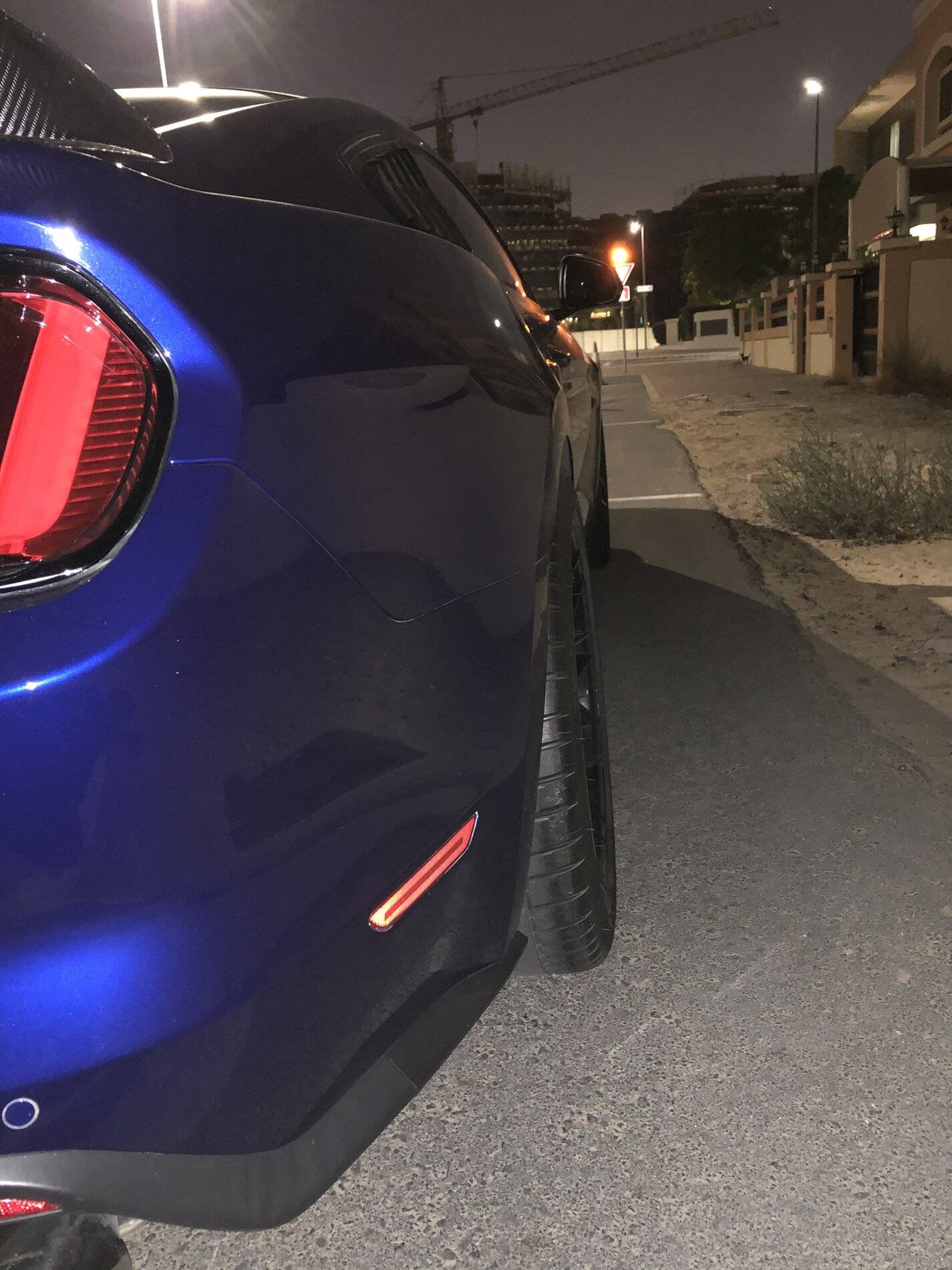

It’s night time where i live now im going to take more pictures in the morning
The car looks almost perfect
In the front it’s perfect but from the back it is poking from above about 3 to 5 centimeters but it does not rub so I’m trying to find a way to make it sit inside the fender wall so that it looks perfect
I have to say that I really do not like a lot of poke but your car looks just plain mean. And I mean “mean“ in a good way. Do want want of course, but maybe live with it for a little while and see if it grows on you.

So the offset is depending on available options that the manufacturer typically provides.
that being said we have done 10.5 ET 40 before and it works. You can do a few things.
1 you can change the tire down one size which helps with the overhang.
You can also adjust rear camber a bit to tuck the top of the tire in a bit.

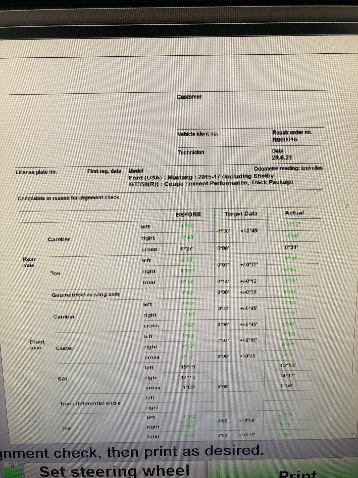

So I figured what’s the problem and it is indeed the camber and thats why the left tyre is poking more but unfortunately I couldn’t find an alignment shop in my area that does camber to mustangs.
All of them just say that the car does not have any camber adjustment
here are my current alignment settings and clearly the poke is from the camber
I will try to find an alignment shop and set both to 1.6 which should be perfect fitment

Thats wrong the S550 has a IRS there is a camber adjustment that can be done its not much but they can make some adjustments.
Now since the left is sticking out more then the right ( I cant see the screen shot you sent) I would want you to make sure the rear is dead even. There have been cases where the rear is shifted to the left or right by a factor of 1/4" (5 mm)

Once i find an alignment shop I’ll have them make sure that the the alignment (especially the camber) is exactly the same on both sides
