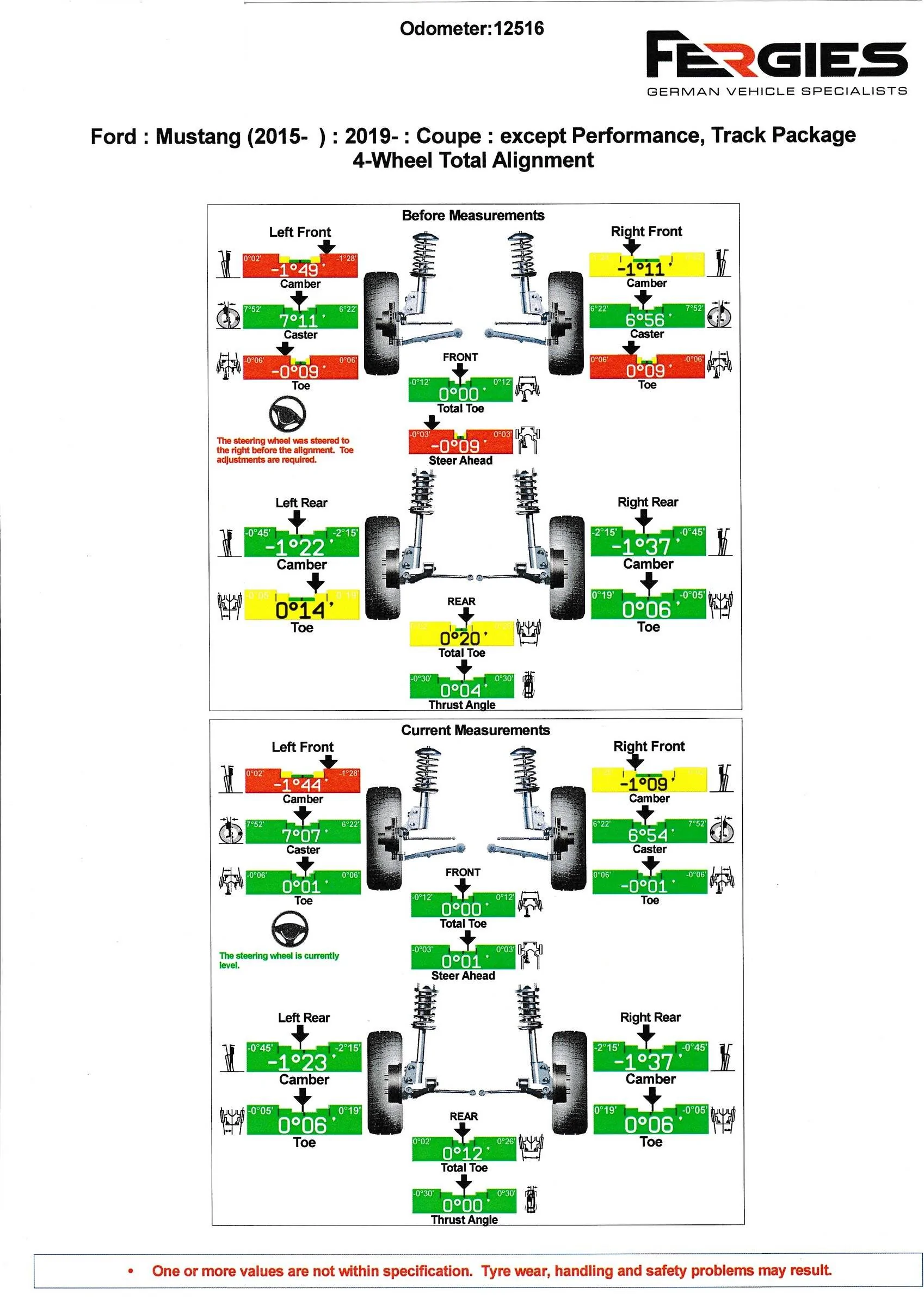

Fergies FTW! The car drives so much better now! No more wobble and the rear is so stable now. Interesting thing with the front though. They weren't able to fully adjust one of the settings and said that as per Ford instructions they have to drill holes in the suspension to get access to the bolts. How weird is that!

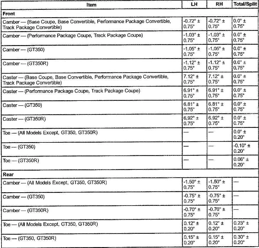

Is it stock ?
Some garages have to look up the car under US, Ford, Mustang on their system as the Mustang doesn't show up under Ford.
So took it to Halfords and the same thing can get the specifications for the car so I gave them this print out so thanks again Cara much much better now
yep, that’s what they told me. The camber bolts are a workaround to that as i understand it.
glad you’re all sorted :rockon:

here's my results before and after. The car now pulls to the right :frown: FFS

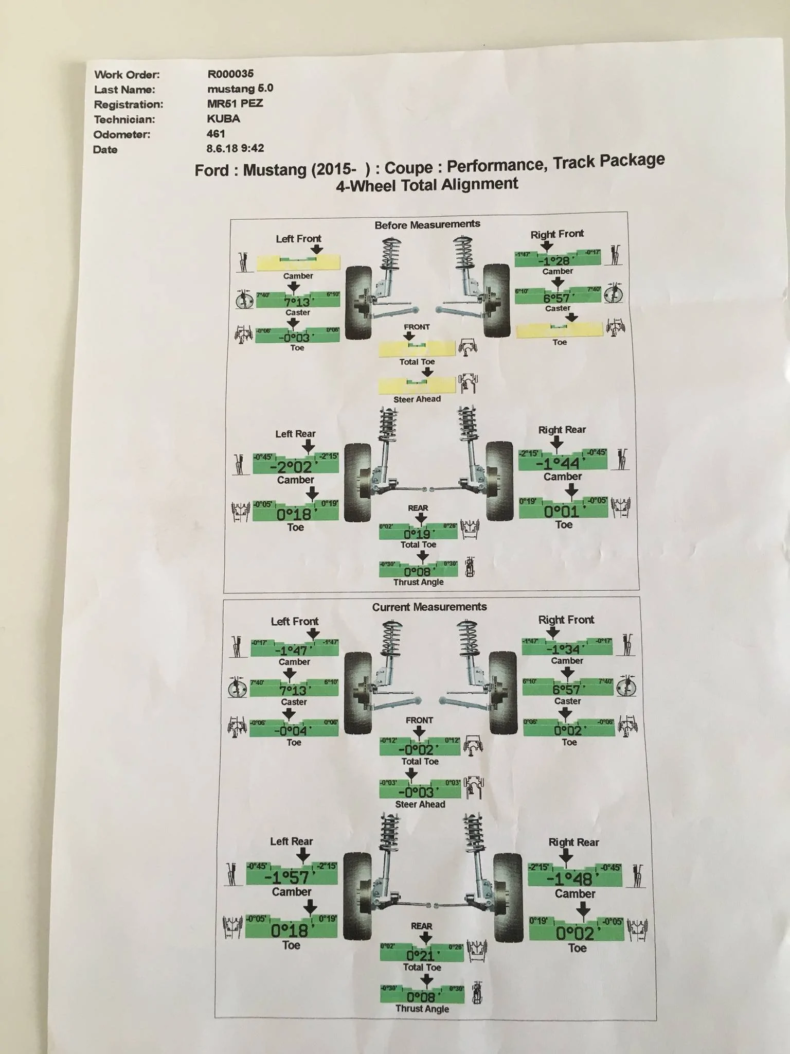

This is how I did mine
This got to be a joke. I don't think I've seen worse job for a while. Toe in front / rear is all over the place. Hopefully you didn't pay for it.
