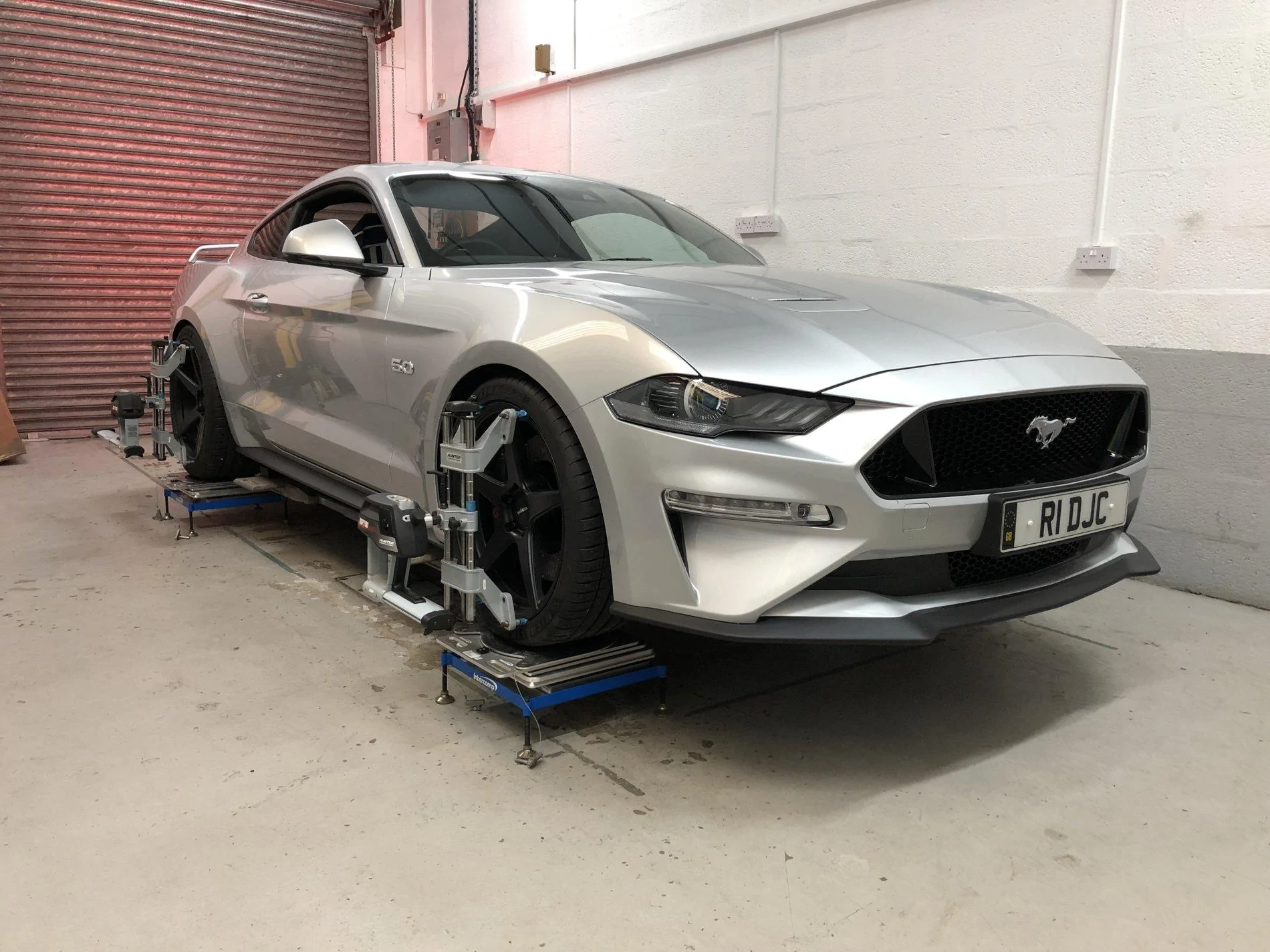

Had mine done last Saturday by this company who i always use for all my suspension, exhaust, brake, wheel alignments https://www.spires-st.com/
