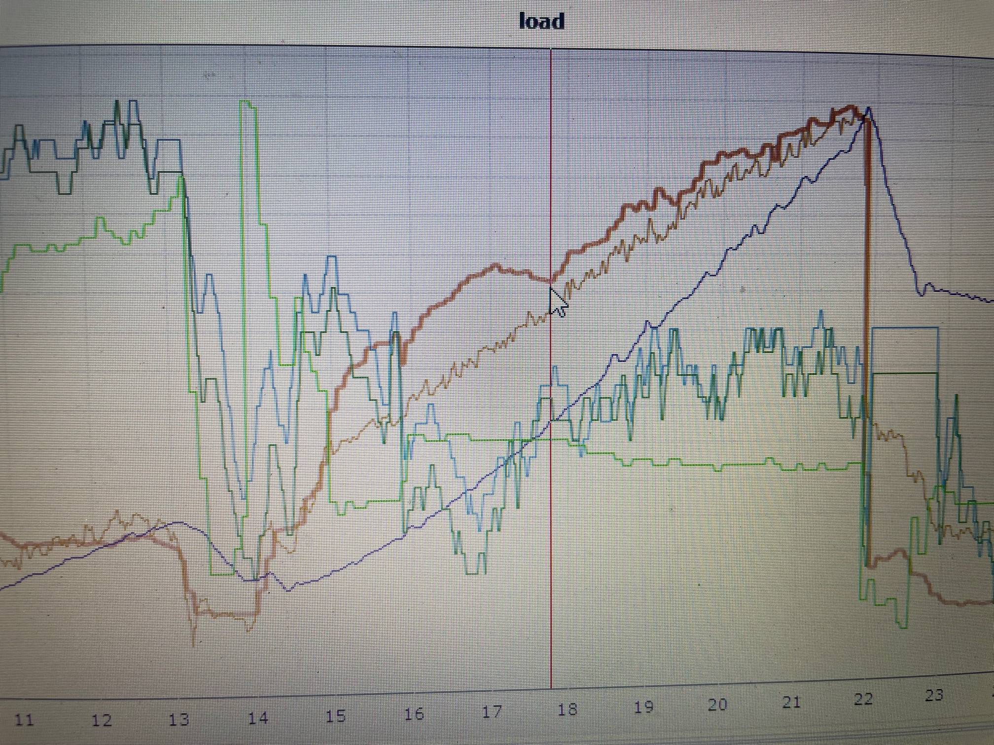

Here's what the current log looks like (brown line) and you see the dip at 4K.

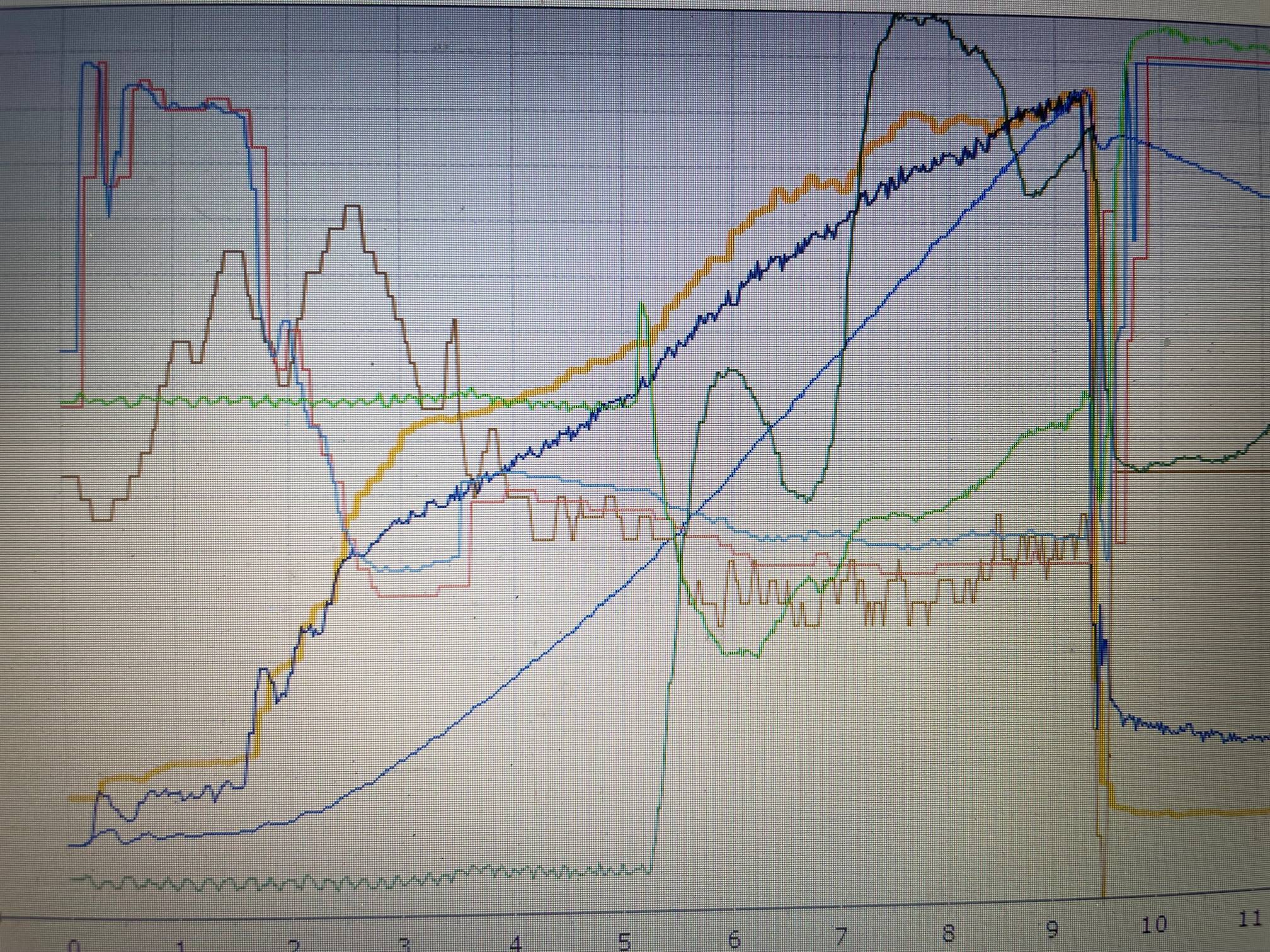

Here's what it used to look like with a smooth increase in load (yellow line) through the RPM range

Are your STFT spiking positive or negative?
