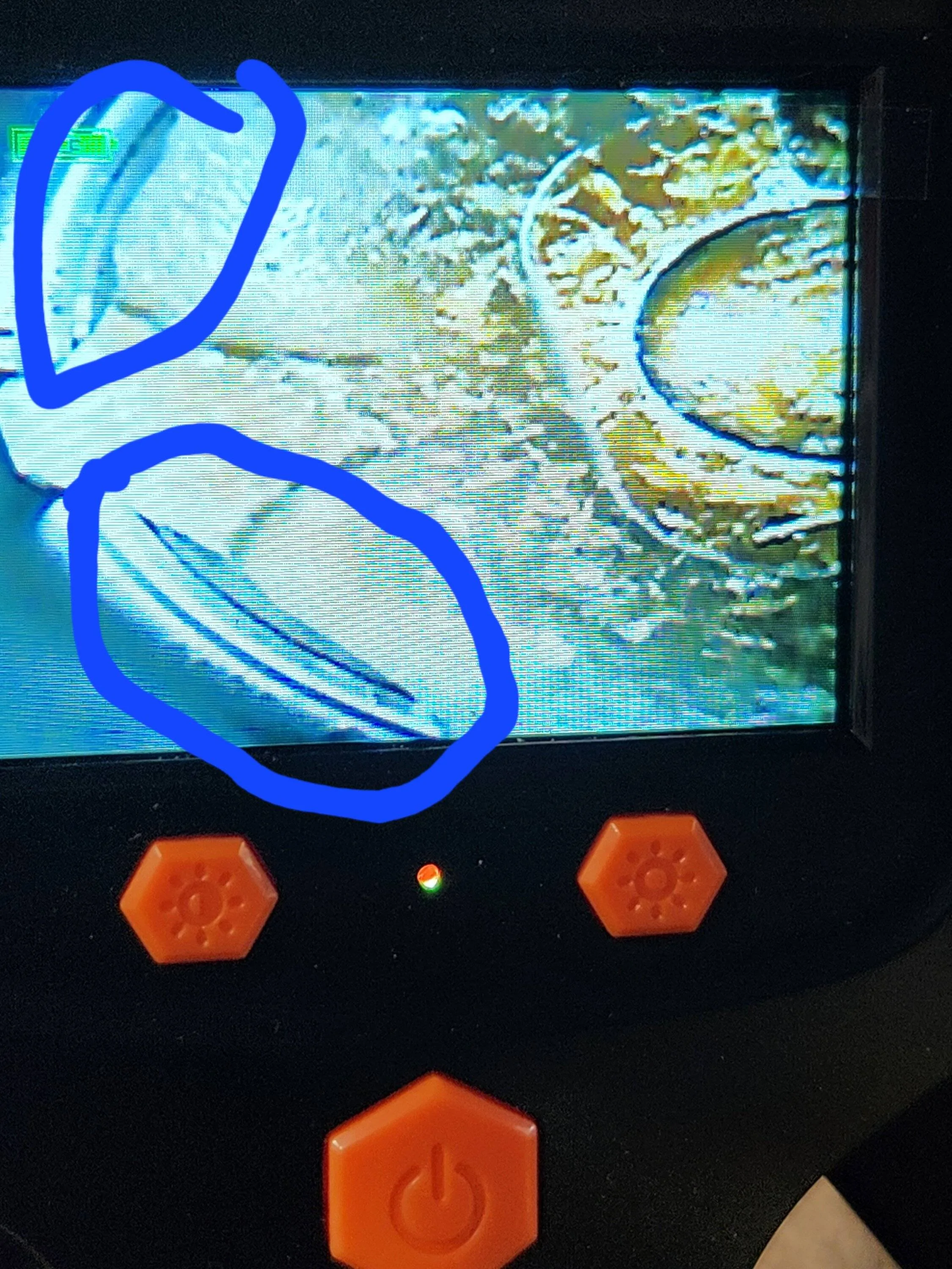

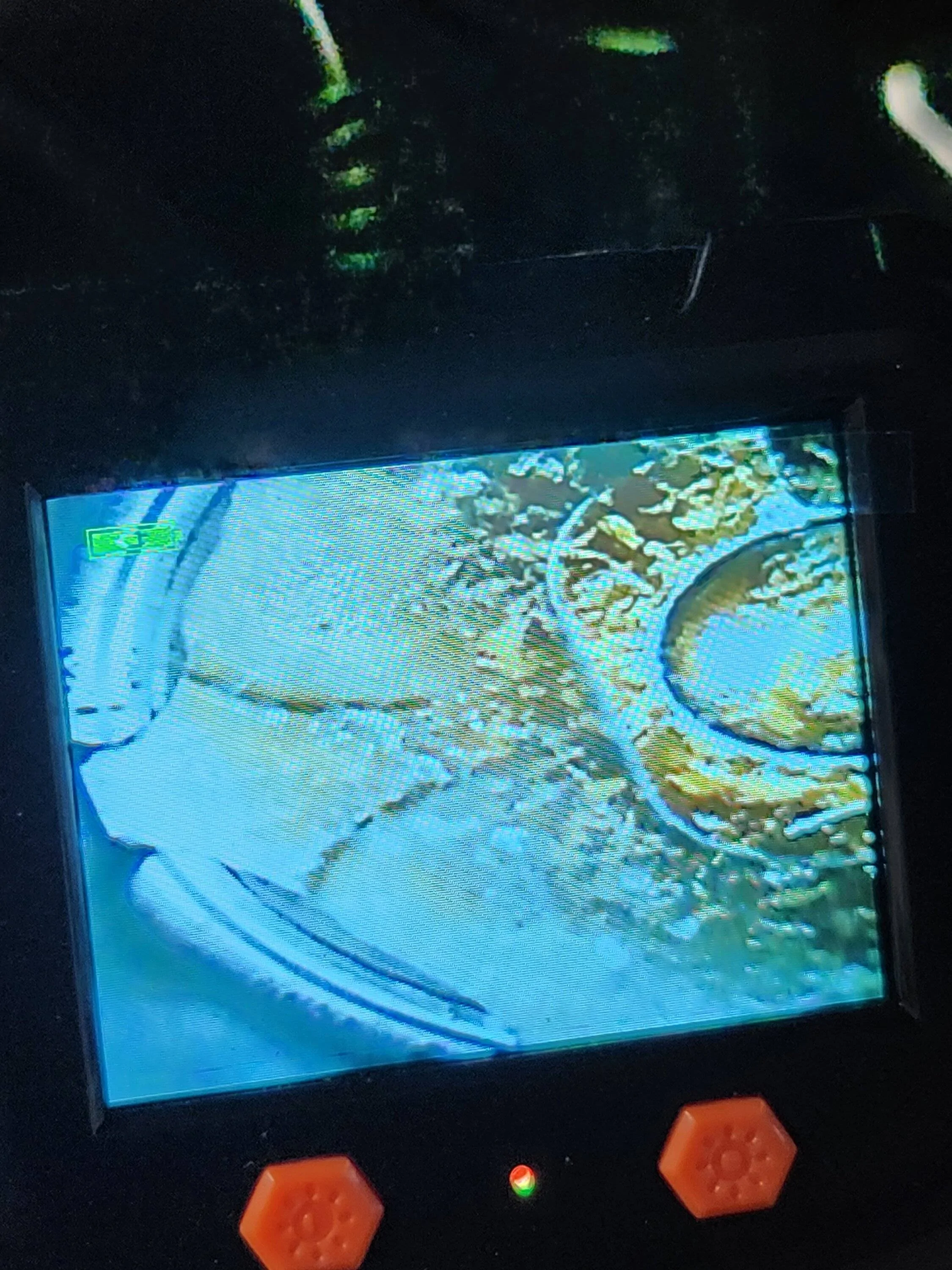

Ringland failure is probably the most common thing. That .009 gap on the top ring is too tight for the heat that FI can make when doing multiple runs or long duration runs. See the pics below for an example. My stock clutch was on borrowed time as well. I ordered a Vengeance Stage 2 a few weeks ago and it was delivered yesterday. When the new build goes in, the Vengeance is going in behind it.

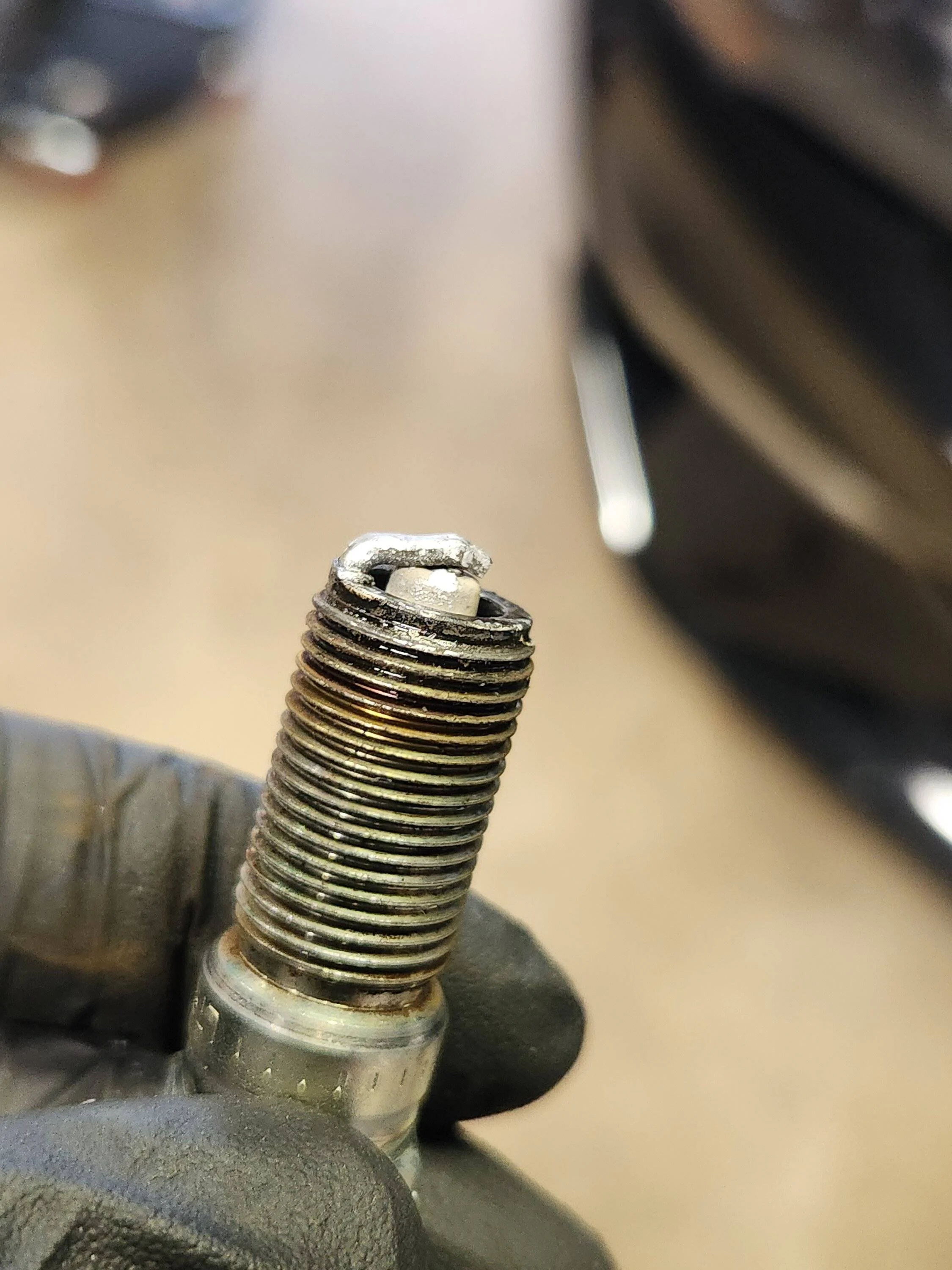

Well if your lucky then unlucky like me you'll go 85k miles problem free on a stock motor and trans. Then a spark plug will break and take out cylinder #3. I really thought I'd get 100k boosted the way things were going...
