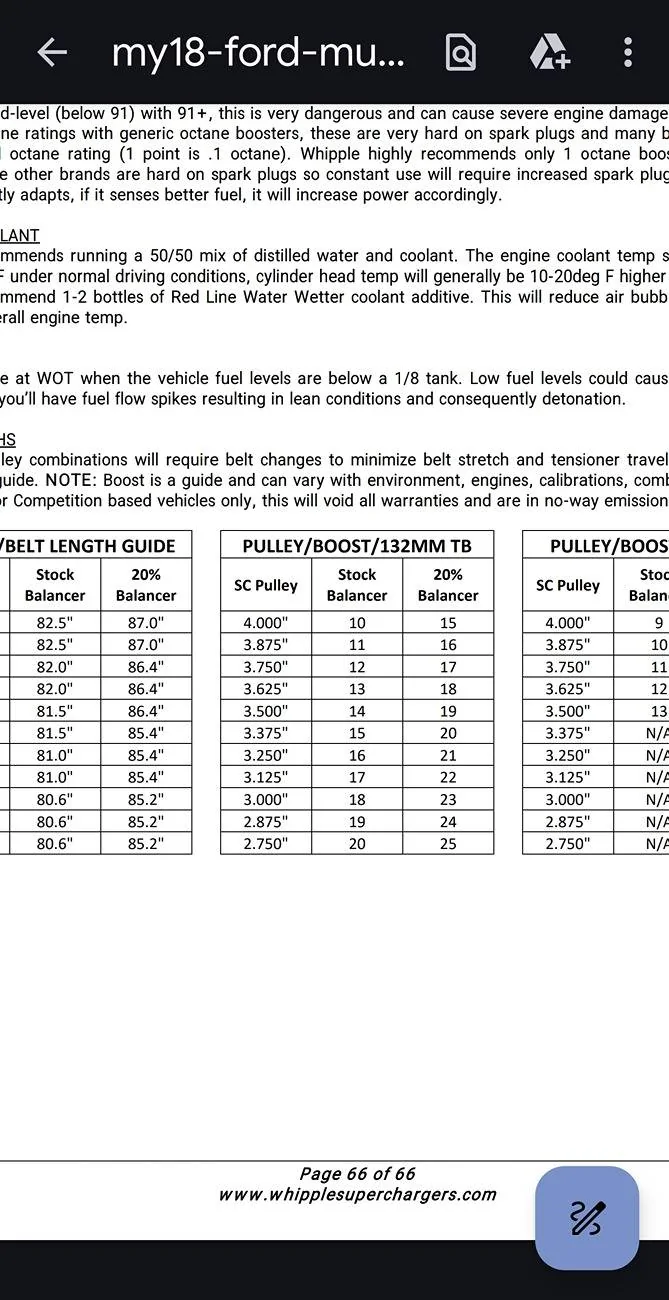

Upgrading my fuel system to a fore innovations triple 285 pump set up so I can run e85 and drop the pulley size. What is a safe amount of boost/pulley size for my set up? Currently i make 10 psi on the 3.875 pulley. Car is a 2018 mustang gt pp1 with a Ben calimers stage 3 mt82-d4, Gen 6 whipple stage 2 3.0 liter, mantic clutch, qa1 carbon fiber drive shaft, geforce renegade axles, gt350 primary timing chains, boss 302 timing chain tensioners and guides, mmr hd secondary timing chains, boundry billet oil pump gears, boundry billet crank sprocket, crank support, catless long tube headers, id1050x injectors, a bunch of bmr rear suspension components.

2.75 is showing 20 lbs of boost based on whipples chart. My motor isn't a built motor so I think that is not a realistic amount. I figured a 3.25 pulley would be the max and still probably not super safe because that is showing 16 lbs of boost.
