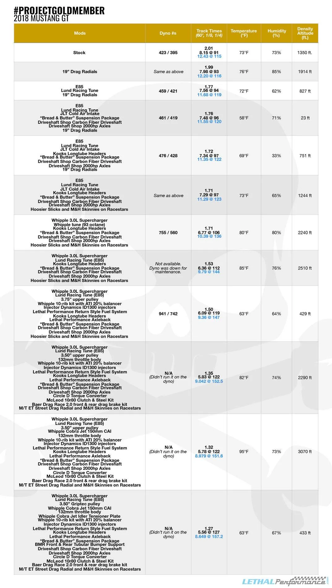

Lethal performance did alot of testing with this, so has PBD and Lund. Consensus ends up being for the majority of NA cars, stay with the stock airbox and a drop in dry flow filter. You wont make the crazy advertised gains that these intakes claim.
As far as GT350 TB, i think its been done, and would require tuning, but theres really no point in messing with the stocker, you wont out-flow it NA. Driveshafts have been done to the 1 piece, its a fairly common mod you can search for on here, plenty of results.

CAI in a MY18+, I'd personally skip it, just get a $50 panel filter for the stock airbox. I'd also forget about the GT350 TB, doesn't make any sense with the MY18 intake manifold which is excellent BTW.
So a panel filter, or if you really want, a CAI + resonator replacement, will pick up a few HP, sounds better, and it's cheap.
If you're OK with a tune, that's where you're going to net your biggest gains, and yes, it will increase the gains from the other mods a bit. A good 93 tune is noticeable, especially if the tuner changes the shifts on an A10, a Flex or pure E85 tune really wakes theses cars up.
