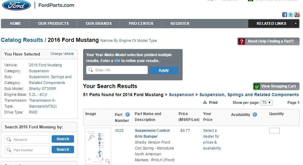

Here's some more info on the shelby R parts. It's a slow day at work. The front part numbers don't look right and the prices change from place to place but this is from fordparts.com so it could be used as a benchmark.
GT350R (non magnaride)
Front struts: 18124(AST-84786) - $231.58
Rear Shocks: 18125(ASH-25844) - $191.30
Front Springs: 5310 - $33.53
Front Sway Bar: 5482 - $72.03
Rear Spring (R): FR3V-5560-K - $91.23
Rear Spring (L): FR3V-5B589-L - $91.23
Rear Sway Bar: FR3Z-5A772-G - $71.83
Source: http://www.fordparts.com/Commerce/CatalogResults.aspx?y=2016&m=Ford&mo=Mustang#Search

This is NOT CORRECT!
Ok then I'm done posting bum info ha. It's from fordparts but if you've ordered and have the right parts then I'll defer to your real world experience.

I have a gt350 track pack. And I'm a self employed mechanic that deals with the ford dealers parts department on nearly a weekly basis. I've swapped all my track pack parts for R springs and bars. The listing they show on the site you posted from is old and dated. The R and non R rear bars used to be the same for 2015 but since changed.
Only base Gt350's could be had without magneride. the tech, track and R all have magneride. The R magneride dampers are different from the track and tech because of the dampers valving.

Also you can't fit GT350 rear dampers to a normal S550 without swapping to GT350 control arms. The pockets and attachments are different.

Sounds good to me, firsthand knowledge > the internets. Now I can't say I didn't learn anything new today. My posts are updated :cheers:
