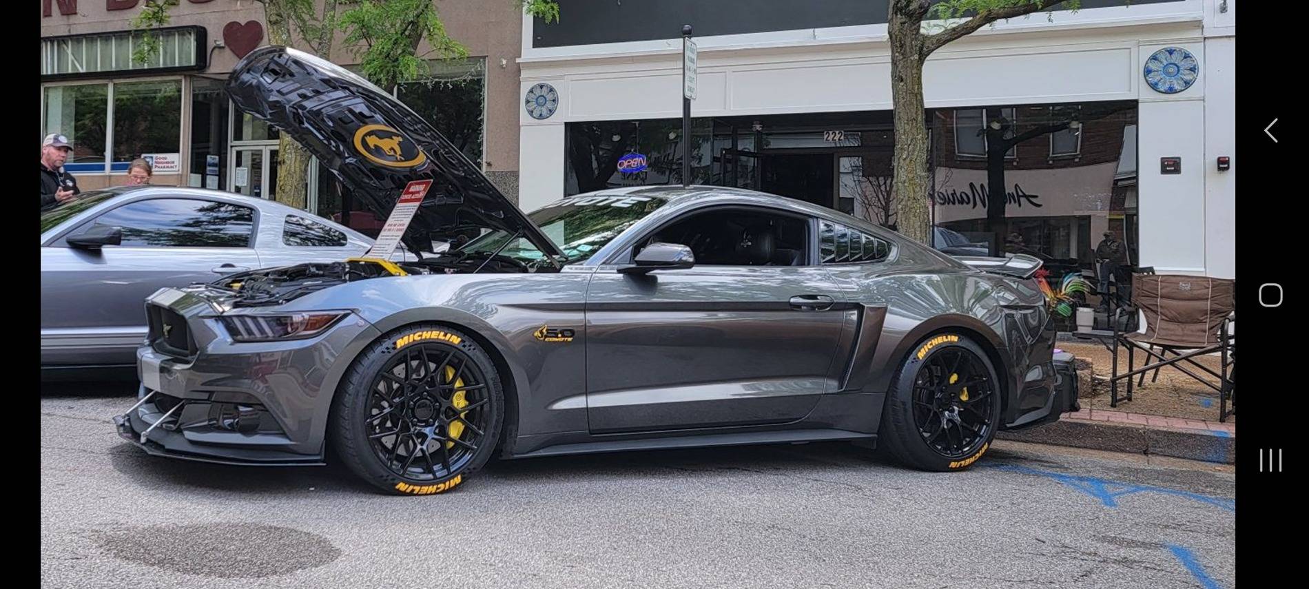

I have a 2017 with Roush Supercharger, Ford Track shocks and struts with Steeda linear springs. Stop the hop, vertical links and have run both PS4's and Nitto 555's but never felt like the car handled like it should. I have some road racing background. In a big sweeping turn when getting back on the gas it always felt like the ass end wanted to step out snd overall just didn't give me the confidence I wanted in the car. At that point in time the car was a daily driver. Last October I bought a second car (Honda Civic SI) and decided that since the Mustang would be weekend and car shows only that I'd put Cup2's on her.
Kaboom........ Everything I'd done came together and the difference is night and day. I'll put another set on when these wear out. I'll take the mileage hit for the grin factor anytime. We have a lot of great country roads here in Missouri and I'm really enjoying them now.
